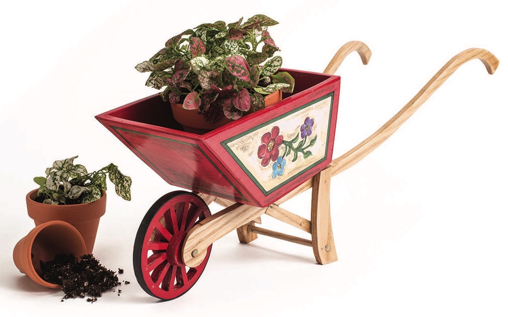

Bring a bit of the outdoors in with this charming wheelbarrow. Use it as a planter, centerpiece, or other display. You can paint or finish the wheelbarrow as you like or use my easy trick: use white glue or a clear-drying glue sealer like Mod Podge to attach a downloaded flower motif, creating the appearance of an expert paint job in minutes.

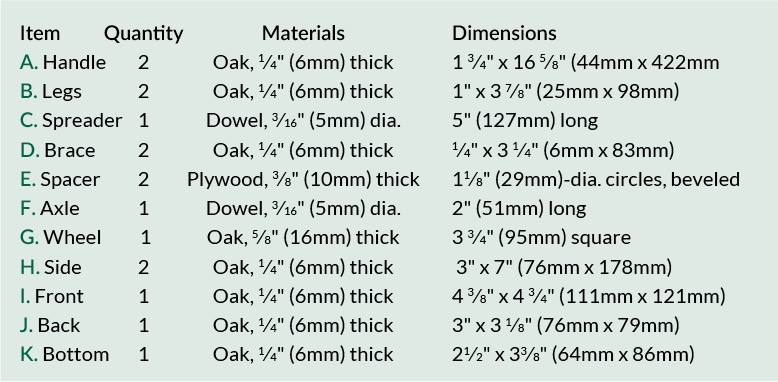

• Oak, 1/4″ (6mm) thick: 6″ x 33″ (152mm x 838mm)
• Oak, 5/8″ (16mm) thick: 3-3/4″ (95mm) square
• Dowel, 3/16″ (5mm) dia.: 7″ (178mm) long
• Plywood, 3/8″ (10mm) thick: 1-1/2″ x 2-1/2″ (38mm x 64mm)
• Wood glue
• Brads
• Acrylic paints: red, green, black
• Decoupage medium, such as Mod Podge (optional)
• Clear finish
Tools:
• Scroll saw blades: #3 reverse-tooth
• Hammer or brad nailer
• Clamps
• Drill with bits: 3/16″ (5mm) and assorted small
• Paintbrushes
Cutting list
Wood project parts list with dimensions and materials.

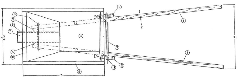

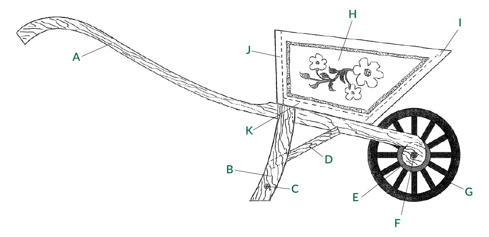

Making the wheelbarrow
Several parts require you to cut the pieces to the dimensions listed. Cut the wood for the other parts to the rough sizes, stack if desired, and attach the patterns. Cut the pieces, separate the stacks, and sand as needed.

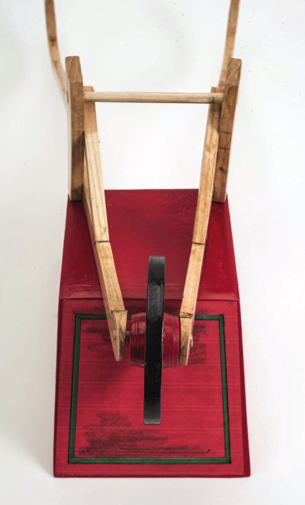

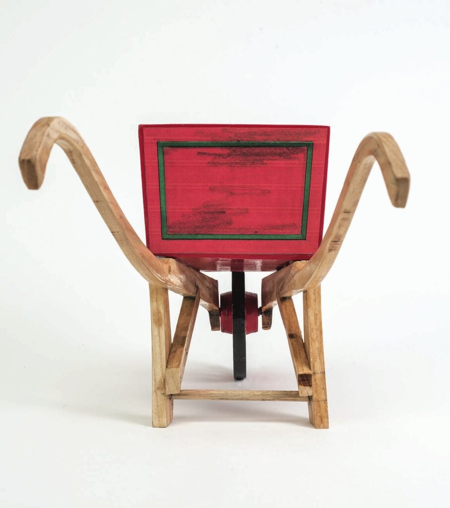

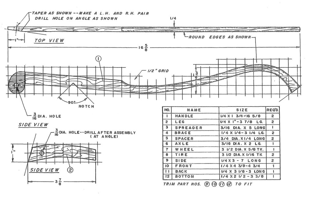

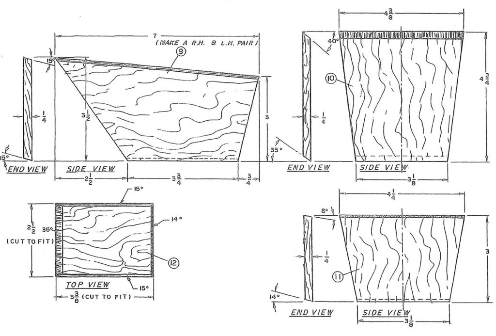

Use the top view of the handles to taper them properly. Sand a bevel into each spacer and then glue and clamp them to the wheel. Drill the axle holes. Glue the axle to one handle, position the wheel, and glue the axle to the other handle. Use glue and brads to assemble the wheelbarrow box and to attach it to the handles. Glue the legs and braces to the handles. Drill angled holes through the legs and attach the spreader. Paint the wheelbarrow box and wheel and let them dry. If desired, download and print the flower motifs and use Mod Podge or a similar glue product to attach them. Seal the project with clear finish.

Technical diagram of a mechanical device.
Carpentry technical drawings with measurements and angles.
Wooden part assembly diagram with measurements and instructions.
