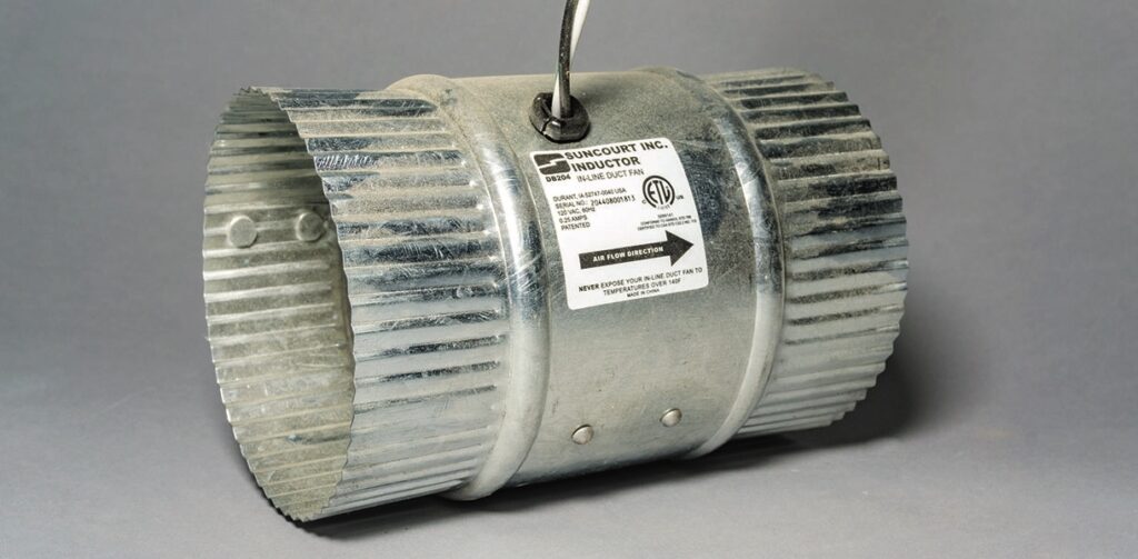

• Proper ventilation and PPE for application and curing is essential

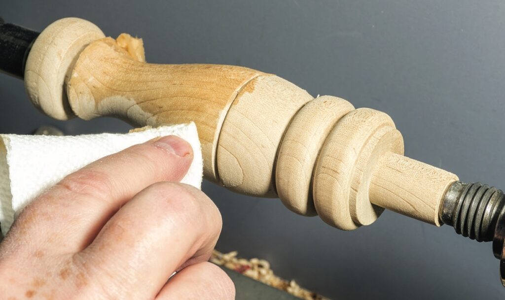

Never use cloth near rotating machinery. If you feel you must use cloth for application, use it only on non-powered work.

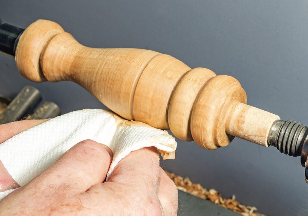

Application of wax
Most waxes can be applied with a cloth. Be certain the work is safely on the bench. If mounted, the lathe must be off. Rotate the work by hand. For any powered application or rubbing, always use paper towels. The directions vary based on the consistency of the wax. Nearly all paste waxes, whether woodworking or automotive, do well being applied with a soft cloth. Depending on the turning, you may wish to rub it on and rub it off by hand. Larger turnings can use a powered muff. Follow the manufacturer’s instructions on whether slow speed hand application is recommended or applied to the turning while rotating under power. The waxes with abrasive work well when applied to a rotating turning. Any excess of wax applied is simply wiped off. Good practice is to use less wax rather than more. Additional wax can be added as can additional coats. Too much wax in any one application is wasteful and messy.
