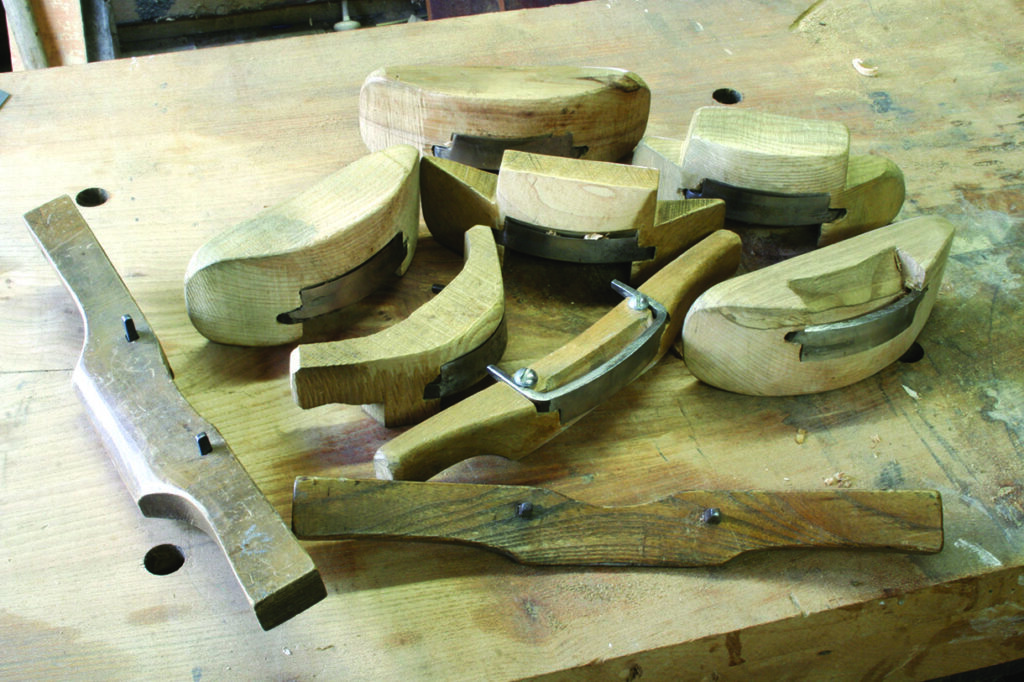

A selection of travishers
1. Here is a selection of old and new travishers – the older tools are darker and have longer handles, while the lighter ones are my own design. I find this design more comfortable, and it reduces the chance of scraping your knuckles across the work.

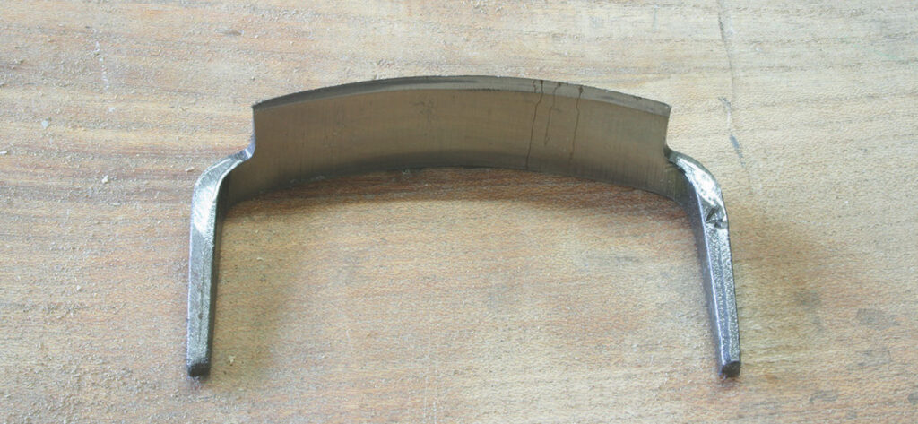

Travisher tangs are long to support the large forces
3. The tangs are at 90° to the blade and tapered, so with careful fitting you should aim to create a friction-fi. This will hold the blade secure when being used, but is easily knocked out when you need to sharpen the blade.

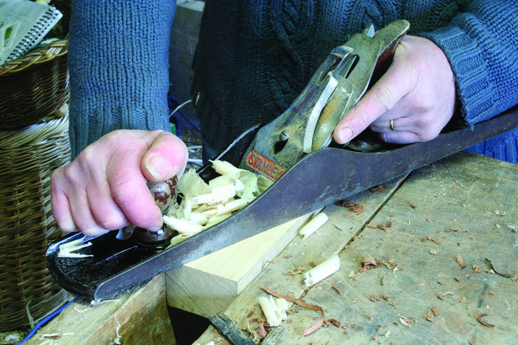

Planing for a smooth flat finish
5. First, plane the block smooth and square on the sides as well, so you start out with an accurately-prepare workpiece.

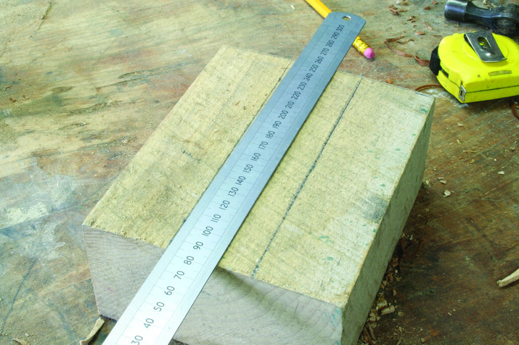

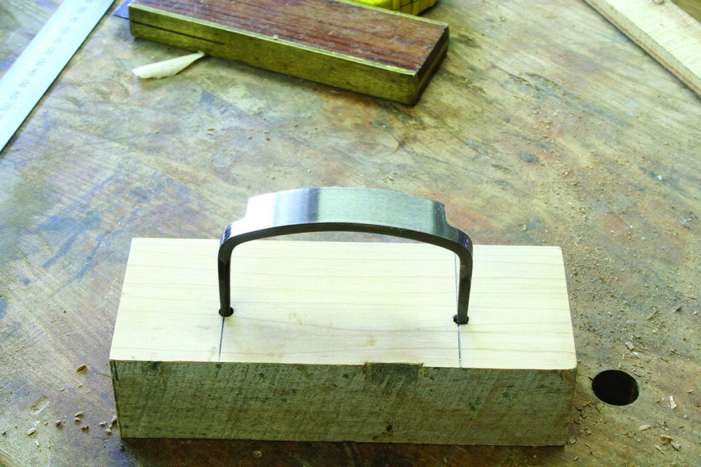

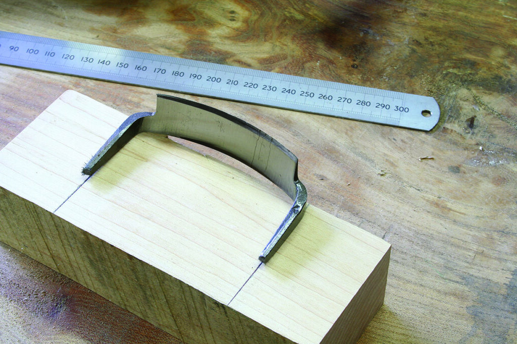

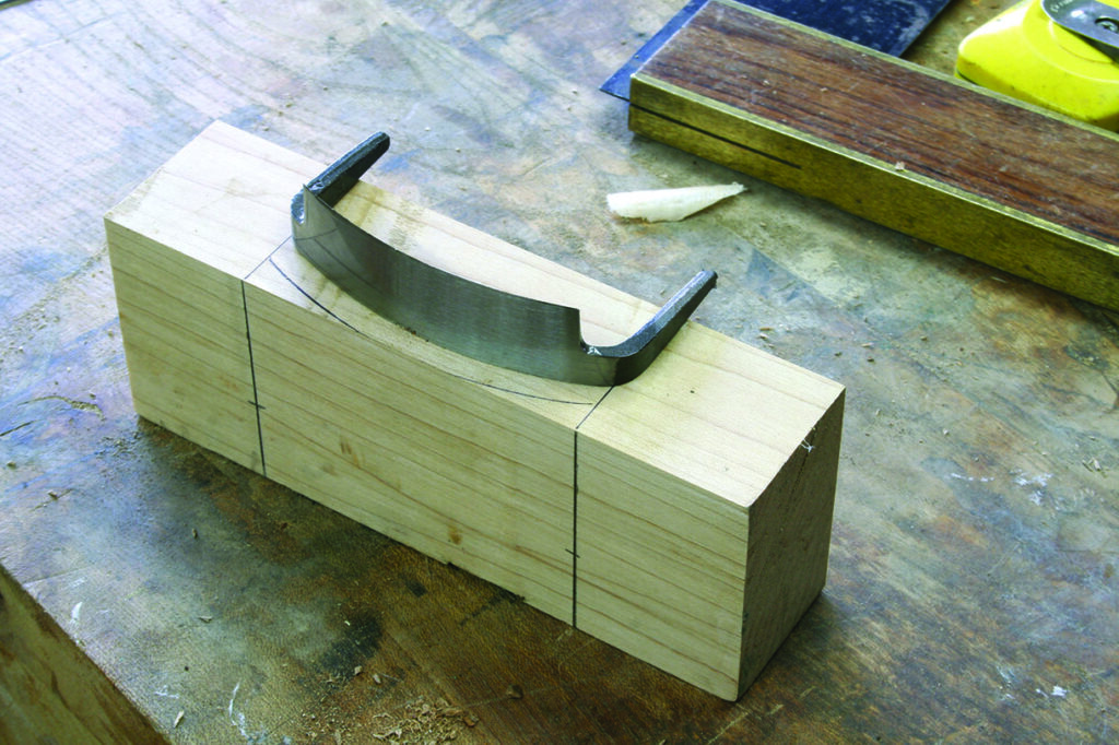

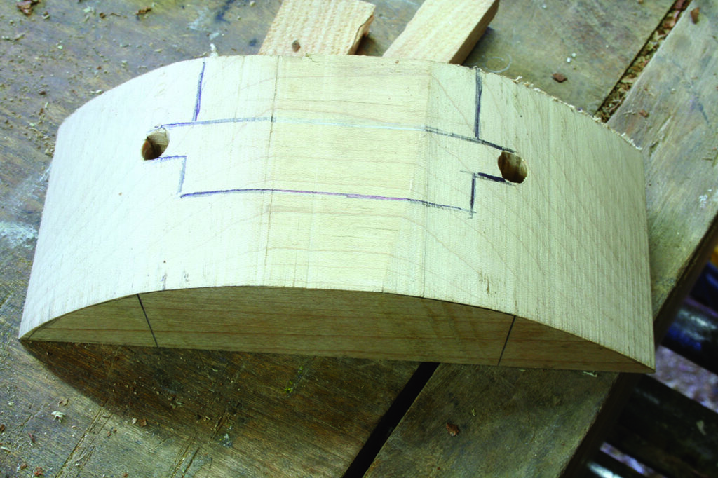

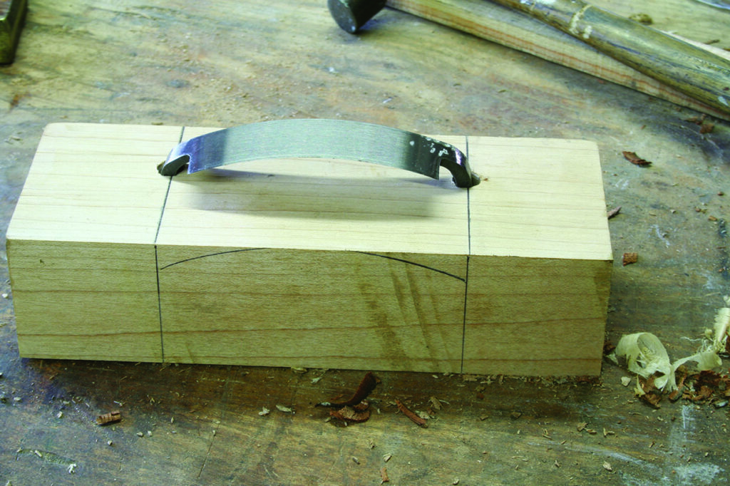

6. Use the blade as a template for marking. On the wider face, mark the centre point of each tang. The blade needs to be seated in the middle of the block.
7. Turn the block over to the adjoining face with the tangs lining up with your previous marks and draw in the curve of the blade.

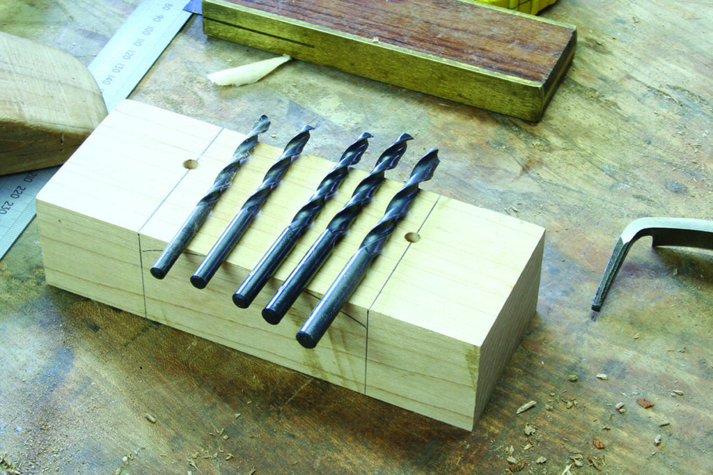

8. The tangs of your blade may be different to mine, but I’ve used a range of bits from 7mm to 9.5mm. Use a cordless drill, or a bit and brace work well when drilling the tang holes. A pillar drill makes this process much easier.
9. My drilling point for the tangs was 20mm from the back of the body. This gave a nice sole at the front of the blade, and enough ‘body’ behind to hold the tangs. Drill a pilot hole with your smallest dill bit and check that the holes line up.
Work the tangs into the holes by gradually increasing the diameter of the hole. As the diameter of each drill bit increases, reduce the depth of cut to produce a tapered hole. For the final fit use a file to open up the tapered hole. Note this will result in a tight fit.

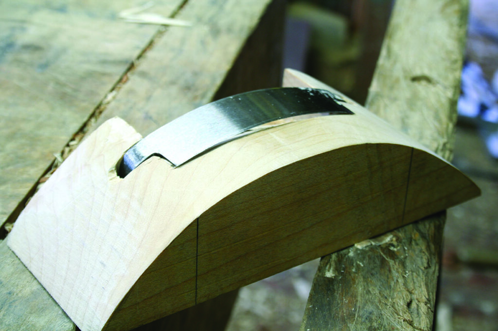

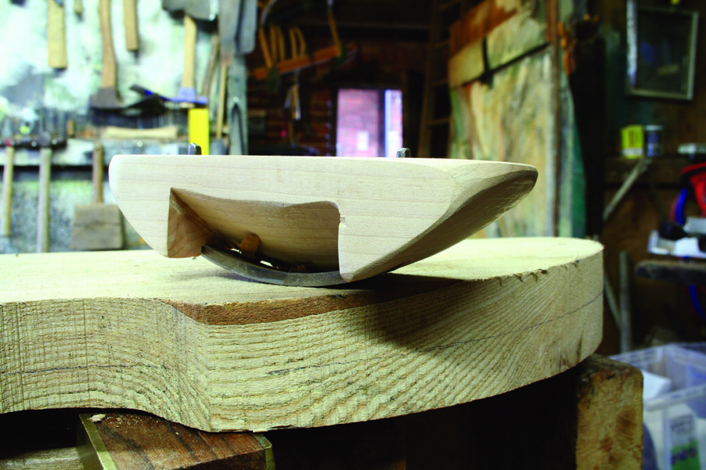

11. Once the blade is seated, remove the blade and cut out the previously marked curve. With the body curved, enlarge the tang holes again until the blade sits onto the wood. You can now mark the outline of the blade. The wood inside the line is waste and needs to be removed.
Removing waste wood

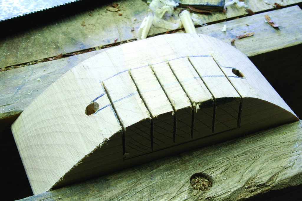

12. Start by sawing slots out of the waste and then use a chisel to cut the waste away.
A chisel makes swift work of removing waste blocks

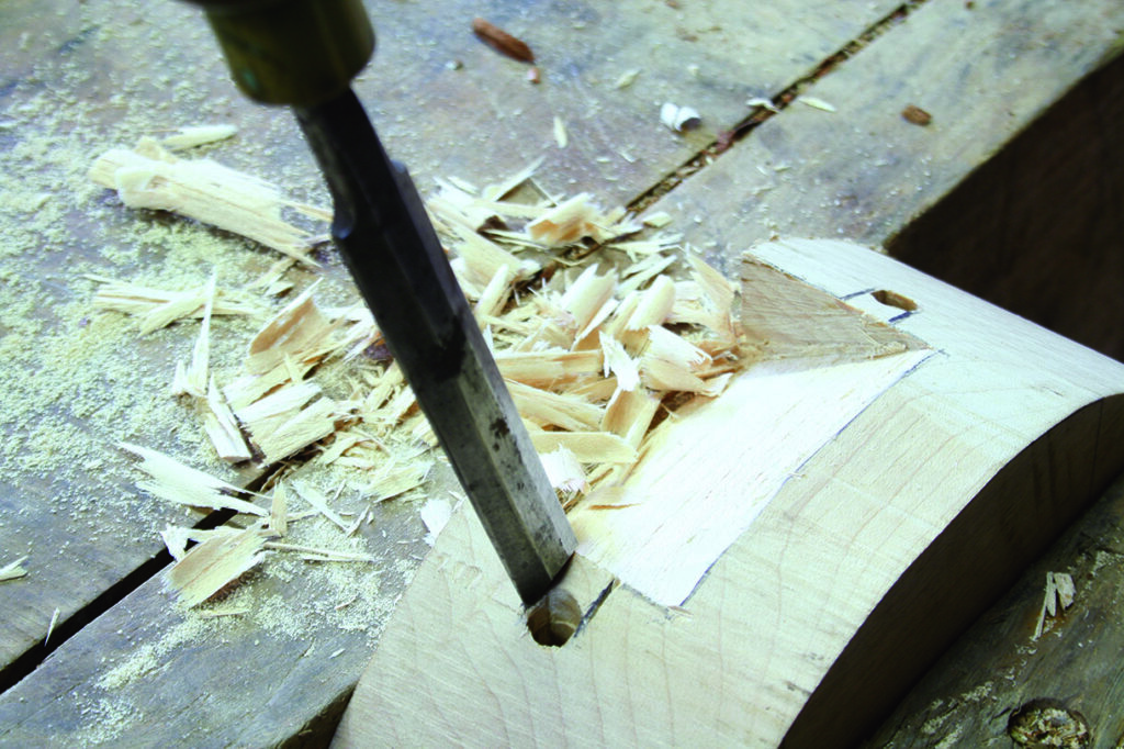

13. Knock away most of the waste using the chisel and mallet. Use the chisel to pare away the rest of it. You need a smooth surface where the shavings will travel away from the body, as shavings will catch on any rough areas and quickly clog up the travisher.
Ensure the surface is smooth to prevent shaving trapping

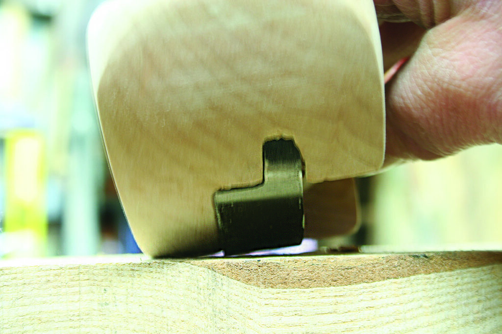

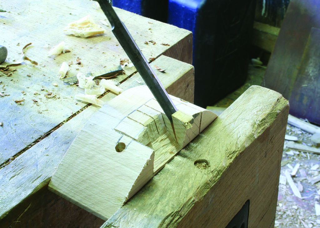

14. Next, use a small chisel to chop out the area where the tang meets the blade. Care is necessary to avoid chipping out the slot.

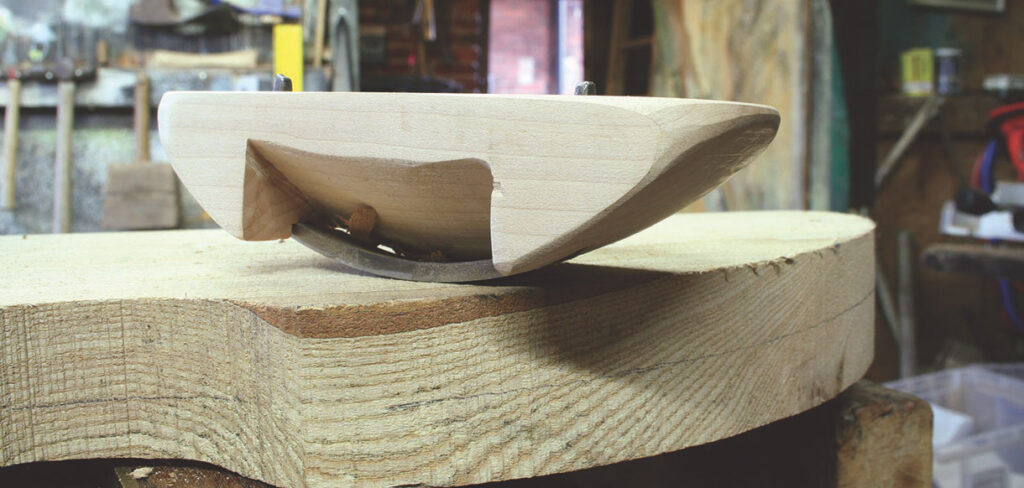

15. Check again to see if the blade is seated properly – it should fit tightly fit, needing a sharp tap with a small hammer above each tang to seat fully. I like to have a small throat between the sole of the wooden body and the blade. This gives a much cleaner cut, but if you’re after rapid stock removal, carefully pare away more wood to open the throat.
Use a spokeshave to clean up the saw marks, adjusting the curve to finally match the curve of the blade to the body. The sole of the travisher should slope slightly away from the blade edge.

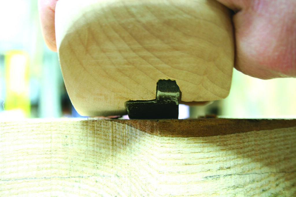

Travisher technique
17. The travisher takes a little getting used to. You can control the depth of cut by rolling your hands forwards, riding on the sole, for a shallower cut. By pushing the tool away from you and rolling your hands forward as you come to the end of the cut, the cut then lightens until it stops cutting. This can be done with the travisher askew for a more slicing cut.
18. By rolling your hands backwards, the tool then rides on the blade for a deeper, more aggressive cut. With a little practice and fettling of the travisher shape, it is a joy to use.
