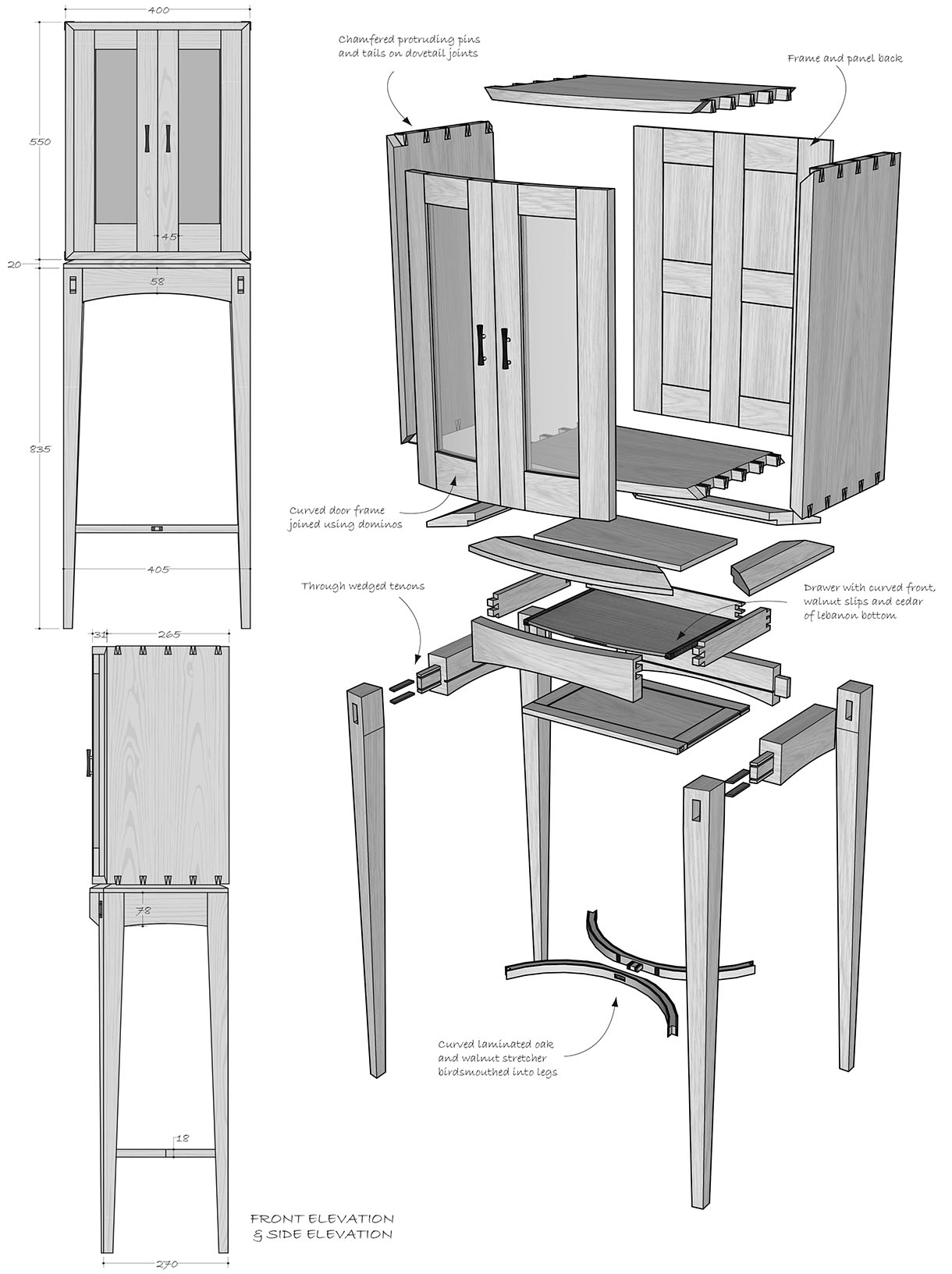

Early consideration of the function and form of the cabinet was an important aspect of its design. My long-standing appreciation of single malt whisky inspired me to create a small display cabinet that would hold up to six bottles of fine malt, accompanied by a set of beautiful crystal whisky tumblers I had been given as a birthday present by my family. During early design discussions at the school, Oliver Waters suggested I consider making the cabinet bow fronted with traditional curved frame and panel doors to provide elegance and refinement as well as allowing me to explore another cabinetmaking technique. I liked the idea and decided to extend it by using curved textured glass for the door panels, which would provide an interesting feature when illuminated from within, and hint at the cabinet’s contents.
Careful consideration was given to the size and proportions of the cabinet to ensure it was tall enough to incorporate six whisky bottles of varying heights, with room above to accommodate two glass shelves for the tumblers. Another important consideration was to ensure the correct size of the stand in relation to the cabinet. I found it difficult to judge these proportions using the computer alone, and instead opted to build a full-scale model using good, old-fashioned cardboard and sellotape. This is a surprisingly quick process, and allowed endless tweaks in the proportions to be made. It was also helpful in revealing the potential for the long, tapered legs of the stand to rack under the weight of the cabinet, and the need therefore for some sort of stretcher to be incorporated. Taking into consideration the possibility of racking when designing furniture and incorporating elements has been a real learning point for me during my time at the school, and something I would have previously paid little attention to.
Given my desire to celebrate the Arts & Crafts style in the piece, I opted for English oak (Quercus robur) as the main timber of choice, with any detailing to be done using a fine piece of English walnut (Juglans regia) I had manged to source. Hand-cut show joinery, in the shape of protruding dovetails with chamfered edges and protruding wedged mortice and tenons, would be the other prominent design feature of the cabinet – in celebration of the fine work of local Kendal craftsman Arthur Simpson. My final design included curved, intersecting laminated stretchers in oak and walnut, meeting the four tapered legs with bird’s mouth joinery. The stand also incorporated a chamfered plinth and hidden drawer all curved with radii to match that of the bow front of the cabinet above it.

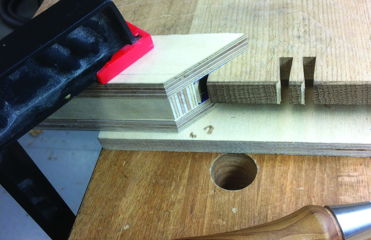

Components for the cabinet’s carcase were carefully selected and dimensioned from quartersawn 40mm English oak. The protruding through dovetail double pin pattern to be used to join the carcase was carefully laid out full size on a piece of card and this was then used as a template to mark the tail board sides of the carcase. Dovetails were cut in the usual manner by hand, with the cut tail boards being used to mark all the pins’ positions on the top and bottom components of the carcase. To achieve a uniform 45° chamfer on the 2mm protruding pins and tails, a simple 45° saddle jig was prepared from ply that fitted snugly across the ends of the cut tails and pins – this allowed paring of the cross-grain chamfers with a sharp chisel.
It was far easier and more accurate to complete all this pairing before the joints were assembled. A 10mm rebate was also cut into the back edge of each carcase component to house the frame and panel back. The curved bow front was cut on the front edge of the top and bottom components using a template guided router cutter ahead of carcase glue-up.
Hand-cut protruding through dovetails with chamfered edges: a key feature of the cabinet’s design
Paring jig used to cut the chamfers on dovetail pins and tails before assembly

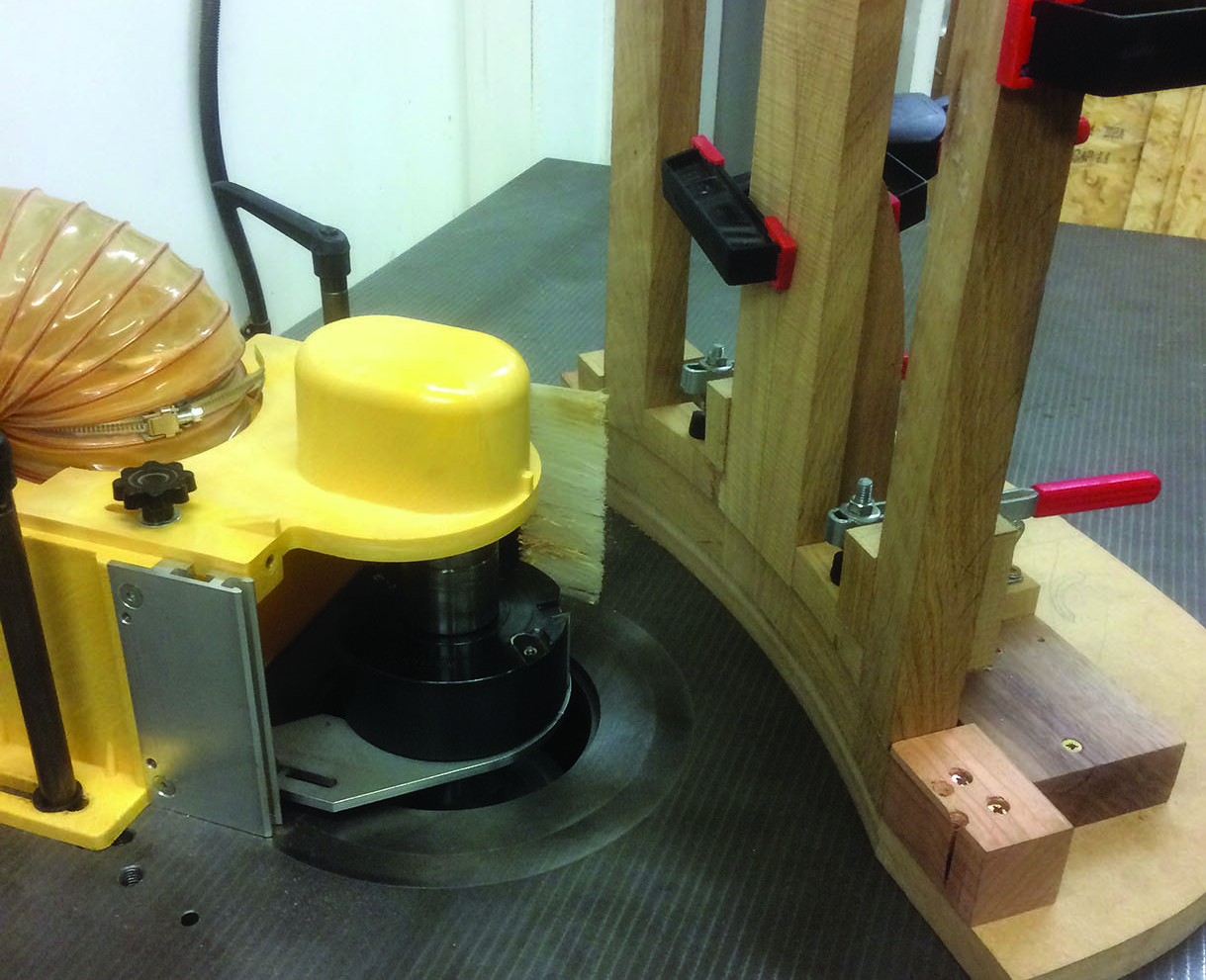

My approach to door construction was to join the stiles and rails together first, to form two flat doors, and then to shape the curve on each. The doors were modelled on the computer, which allowed component thicknesses and all necessary angles and radii to be determined. The stiles and rails were cut to dimension and then joined with the Domino jointer. Two jigs – one convex and one concave, were then prepared to hold each assembled door vertically, and the spindle moulder was used with a rebate cutter and ring fence guide to shape the top and bottom sections of each door following the jigs curved base. This left a central unshaped section on each doors stile which was easily blended to the same curve using a block plane and cabinet scraper. Before glue-up, a 10mm rebate was cut into the back of each door frame component for the curved glass using a bearing guided rebate cutter. Some 5mm beading was cut and shaped to fit the rebates with the glass in place and brass panel pins used to fix everything securely.
Jig holding doors ready to be shaped on the spindle moulder with rebate block and ring fence

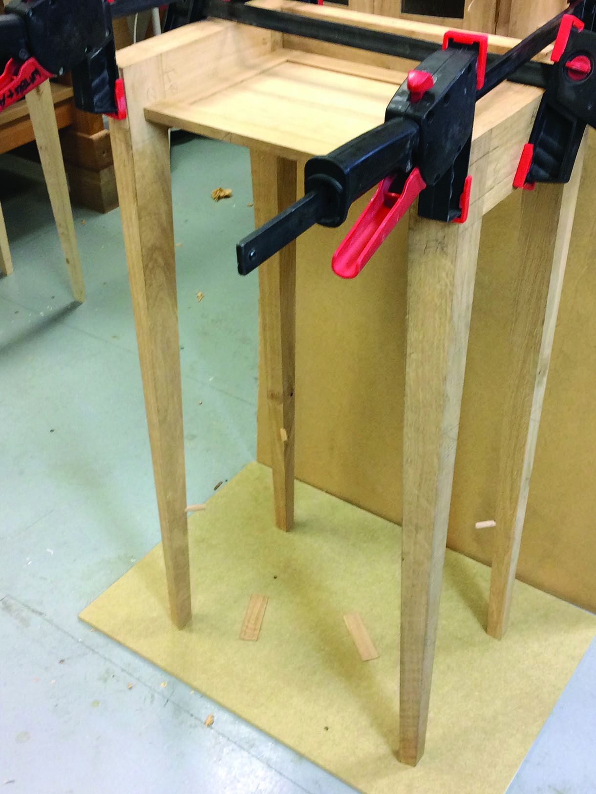

I used 75mm-thick oak to make the stand. After dimensioning all components to size, the leg tapers were applied using the spindle moulder and a tapering jig, and the curved side and back rails were shaped on the same machine. The electrical lighting power cable was hidden in a channel routed down the back-left leg with a small exit hole for the plug cable 200mm from floor level. Tapered through mortices were cut in the front legs and stub mortices on the back legs, and a groove was routed in the side rails and back ready to accept a framed dust panel. This frame was made from solid oak Domino jointed together with a veneered ply oak panel inset. The dust panel had a corresponding groove cut in its sides and back and plywood splines were used to join it to the stand. Finally, the through and stub tenons were cut on the side and back rails with allowance made for the walnut wedges on the front tenon joinery. The stand was then dry cramped together in readiness for fitting of the lower stretcher.
Tapered legs and dust panel dry clamped and awaiting the fitting of the stretcher

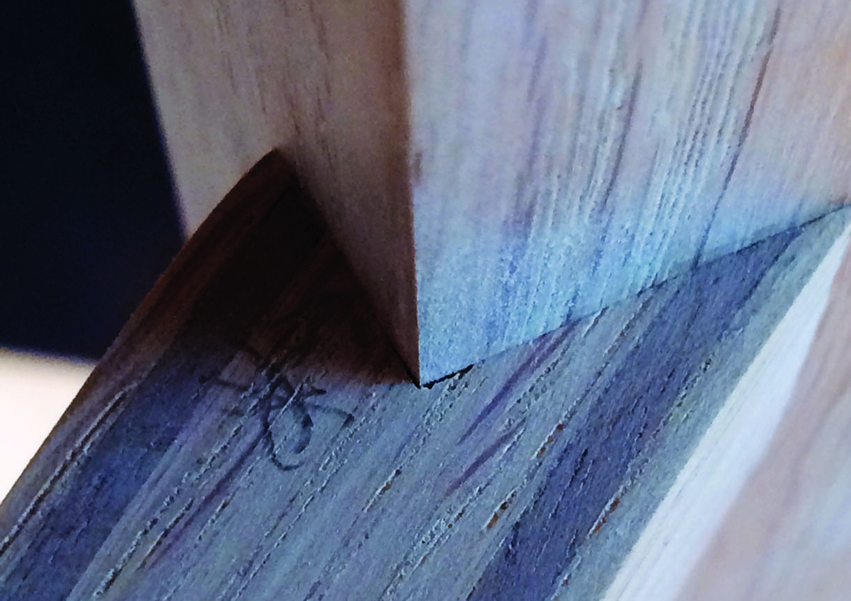

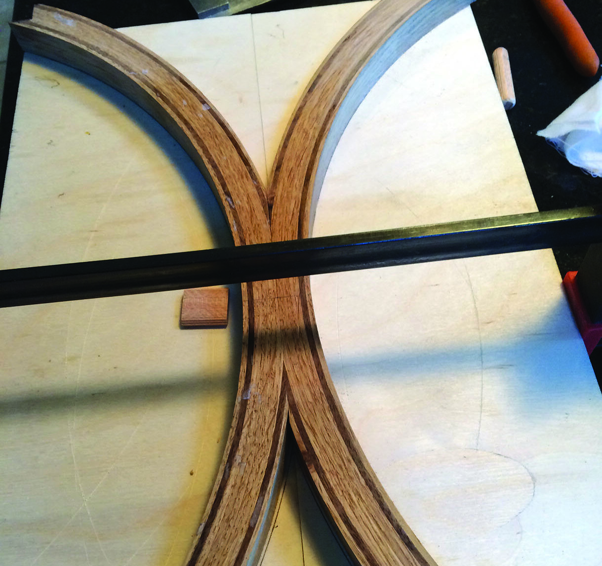

A rectangular piece of plywood with notches cut at its corners was used to explore where to position the stretcher in order to achieve the correct proportions with the rest of the stand. Next, the computer was used to accurately model the stretcher’s dimensions at this height, such that its bird’s mouth joinery would intersect perfectly with the stand’s tapering legs, and so that the walnut inlays in the stretcher’s oak laminations would intersect crisply. Some 2mm oak and walnut lamination strips were then cut on the bandsaw and passed through the wide belt sander. These were coated with epoxy resin, bundled together and band clamped around a former of correct radius to form each of the two curved stretcher components.
To join the two curved components to form the stretcher, each first had a flat created equally of fixed length about the curve’s centre point with a router and straightedge. A small mortice was then cut by hand through each component at the centre point of the flat and a matching tenon peg created in walnut and oak which, when inserted into the mortice holes, held the two components together. Finally, the joined stretcher was overlaid on the initial plywood template to allow the notches for the bird’s mouth joinery to be marked out and cut with a backsaw and sharp chisel. It was extremely pleasing to find that the completed stretcher’s bird’s mouth joinery met the stand’s legs crisply at the prescribed height. Holes for wooden dowels were then drilled at 45° in the legs and the notched stretcher and the stand were ready to be glued up.
Bird’s mouth joint between stretcher and tapered leg

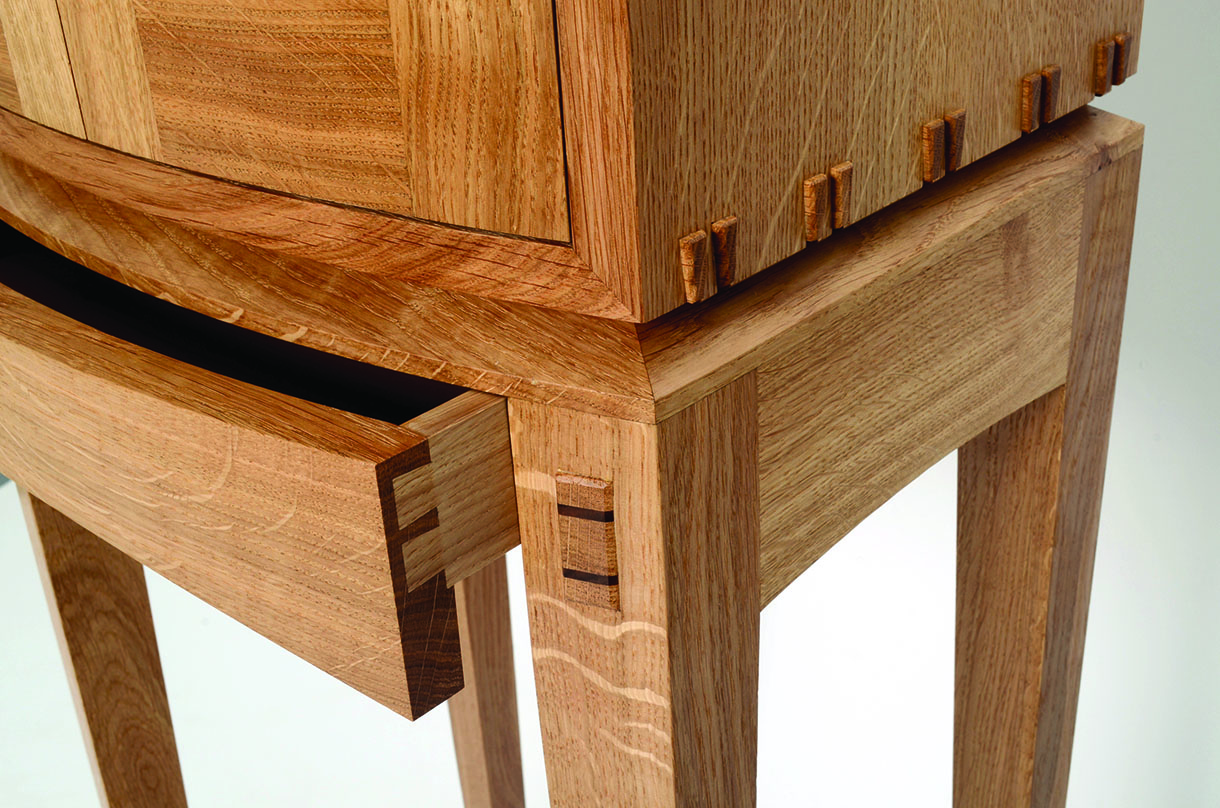

Curved drawer and plinth
To complete the cabinet stand, a chamfered curved top plinth was created onto which the cabinet would be seated. A mitred frame was first constructed in oak and jointed with Dominoes. This was then grooved for an oak-veneered internal panel, being careful to leave enough of a void to allow the LED lighting junction box and transformer to sit on the upper face of the panel without fouling the cabinet above. The curved front of the plinth was then applied with a template and bearing guided router cutter and finally the chamfer was applied. The plinth was then permanently attached to the side and back rails of the stand with Dominoes and glue.
The components for the drawer sides and back were dimensioned from quartersawn oak for stability. Walnut drawer slips were used for contrast and had grooves machined in them centrally using the spindle moulder to accept the base, which was made from cedar of Lebanon. A scratch stock bead detail was added to each of the slips by hand. The drawer front used 75mm stock to allow for the curves to be machined on its inner and outer faces.Two small flats were first routed onto the inside faces of the drawer front to ensure the flat drawer sides would intersect with the curved drawer front seamlessly. Dovetails were then cut by hand in the usual manner and the curves applied to the drawer’s front, back and lower faces using the spindle moulder. Finally, a groove was machined in the back of the drawer front to accept the drawer base and a finger pull routed into its bottom edge. Once glued up, the drawer was fitted into the stand to achieve a piston fit using a freshly sharpened plane to remove final single shavings.

Completed stand with curved drawer
