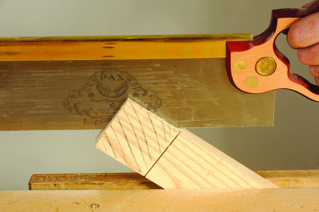

The more you pay, the better the tool. Really top-quality traditional saws can be expensive, so they deserve looking after. They come in two basic types – with a ‘back’ to stiffen the blade for joint cutting and larger handsaws without a back, designed for panel cutting. There are many variants though for very specific tasks.

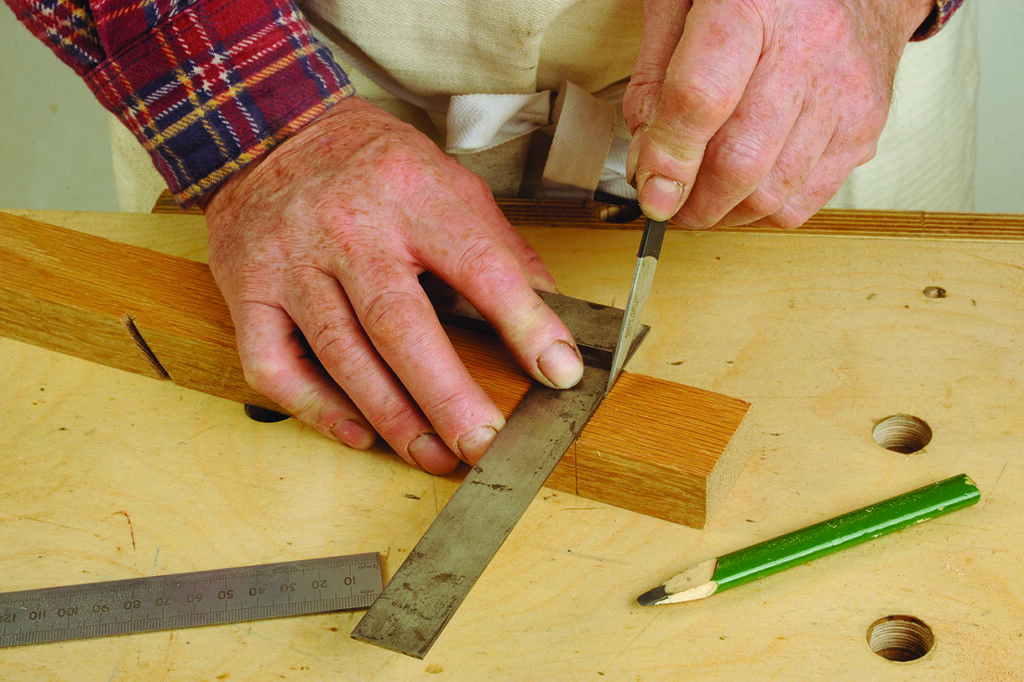

Mark your cuts
You can’t make accurate, neat cuts without marking out your cut lines correctly. A try square and marking knife, or carpenter’s pencil sharpened to a ‘chisel edge’ is the usual method, but an engineer’s square is more accurate. Alternatively, a combination square is adjustable and very handy working on site.

Starting the cut
Use a sharp chisel to form a slant to your cut line, for the blade to sit in.

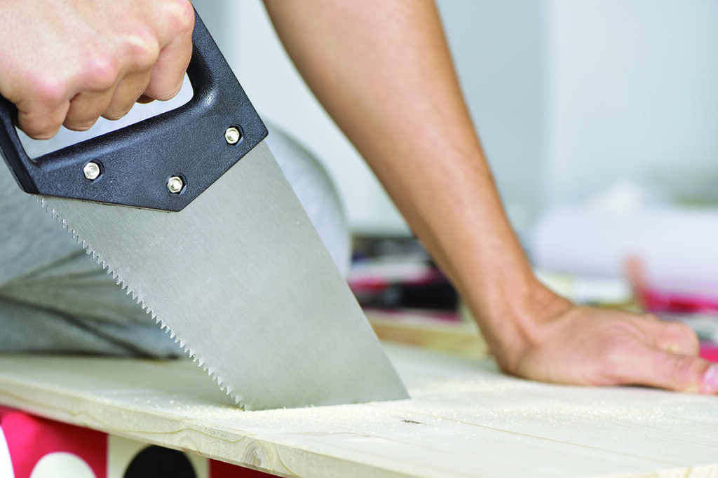

Sawing technique
When sawing, place the blade on the waste side of the pencil line and draw the saw back to start the cut, then push forward and keep the back and forth motion going while siting directly with your eyes down the sawn and marked line. Use your thumb or knuckle to keep the blade on track to start with, but don’t get yourself cut!

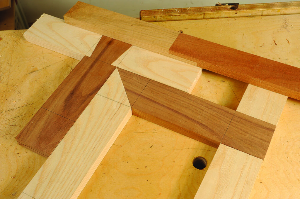

Cut accuracy
Joints need to be precise to work properly when they lock together, such as a mortise and tenon for example. It is standard practice to start the cut from one side or face of a workpiece and then turn it around and cut from the other so the cuts follow the marked lines and when they meet, any inaccuracy is therefore halved.

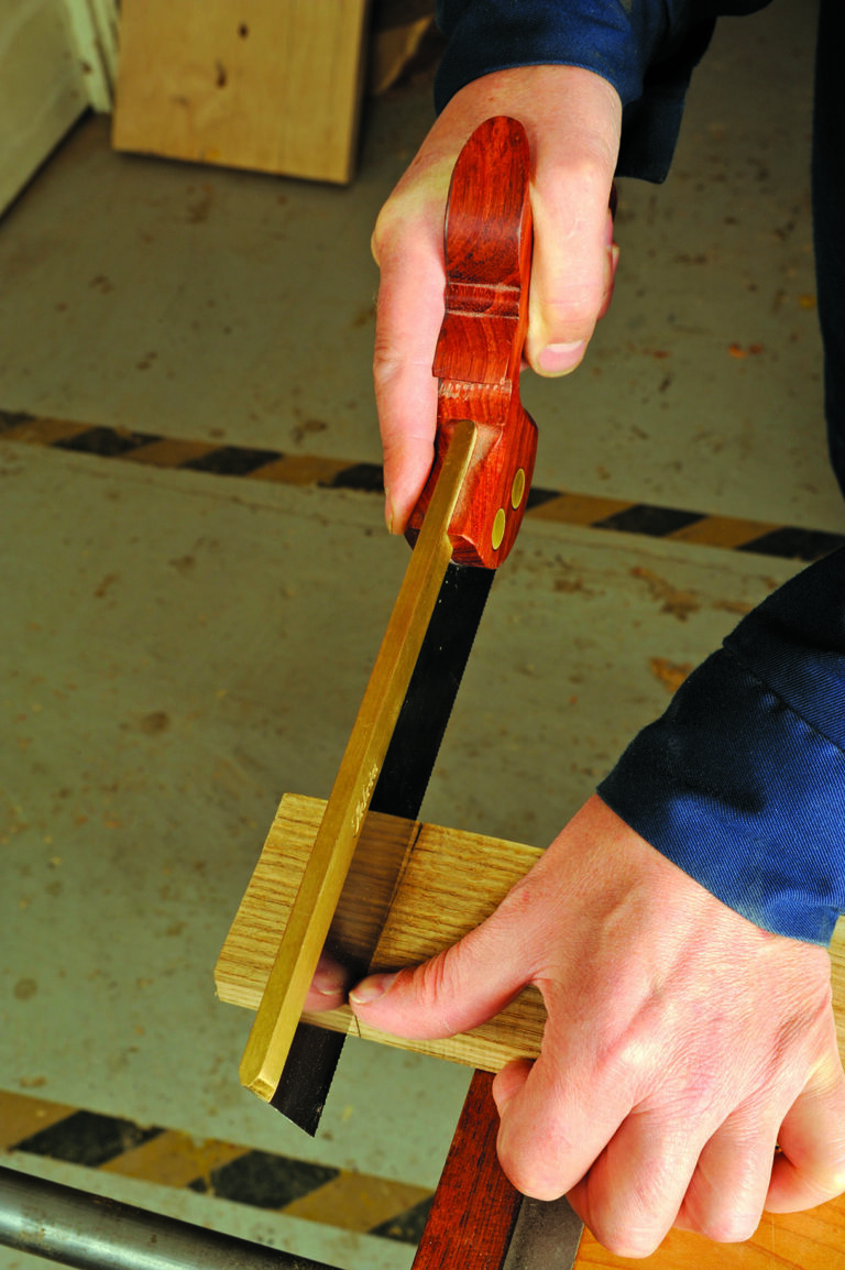

Don’t force it
Remember, force is not needed – let the weight of the saw carry it through the wood and guide it as carefully as possibly using hand and eye coordination – a key requirement of woodworking by hand rather than machine. With practice maybe you can produce joints this good!
making an accurate saw cut at the end of a piece of wood
Sight down the saw and use your thumb as a guide. The sharper the saw the better the cut
