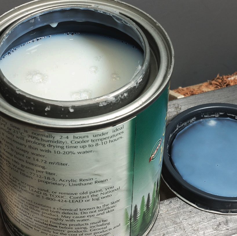

Coalescing finishes are waterborne finishes and they cure by a combination of both the evaporative and reactive processes. I will use the terms coalescing and waterborne interchangeably. Imagine little balls of reactively cured resin floating around in a sea of water with some additional solvent. As the water evaporates, the little balls of resin get closer and closer. This continues until they come into physical contact, creating a larger blob of touching balls. The solvent in the mix works on the balls, making the contacting balls in that blob combine. The water is gone and now the solvent is gone, leaving the solid surface film finish formed by all of the combined balls of resin.

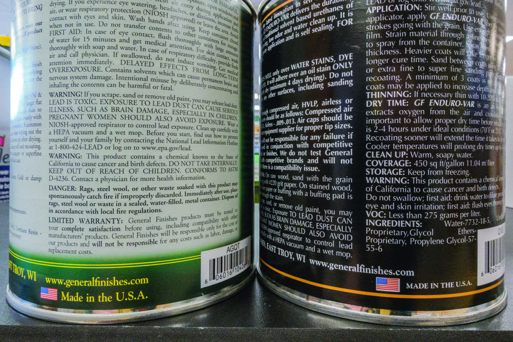

Coalescing finishes are much more user-friendly than the typical evaporative and reactive finishes. Their development and, in some localities, their mandatory usage, has been driven by the problems with the health hazards and waste streams of the traditional finishes. Coalescing finishes don’t contain the high percentages of volatile distillates or exotherm as the other finishes do. Regardless of the term ‘waterborne’, or the often-used, but I believe incorrectly, ‘water-based’, don’t become complacent. They need to be handled in the manner that is indicated on the safe-use panels on the container. Proper use and disposal are key to being healthy in the workshop and keeping the environment in order. Each country will have its own safety labels and legislation that products needs to comply with.
Don’t get lost in the terminology. You’ll hear water-based and waterborne. I don’t believe they are really interchangeable. Water-based implies that the formulation is based on water and that the water is somehow an active ingredient, i.e. the solvent. Not so with the finishes we are discussing here. The water is certainly there in large amounts, typically 50% of the volume, but it doesn’t play a part in the chemistry of the actual finish. The water is the carrier for the resin and the actual solvent, normally glycol ether. The process of creating the finish relies on the resin and the solvent, not the water. The water is only carrying everything along to keep things from becoming a mess before you get it applied where you want it. In addition to being the carrier, it does aid with the spreading of the actual components during application. The water evaporates and the solvent reacts with the resin. Rather than water-based, I think coalescing finishes are more correctly waterborne finishes.

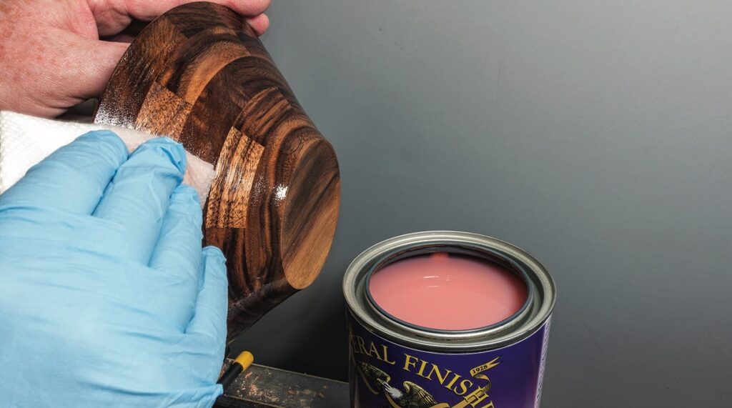

Applying coalescing finishes

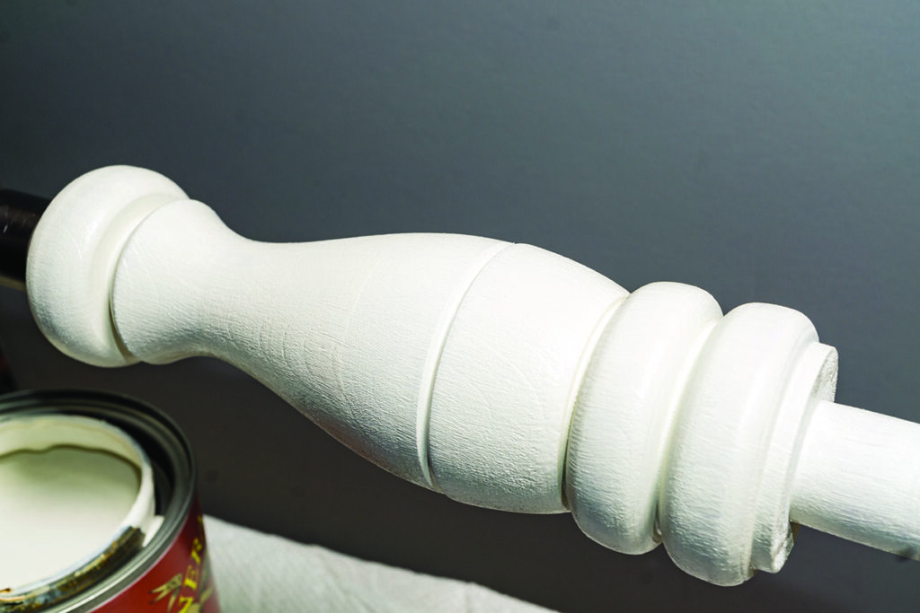

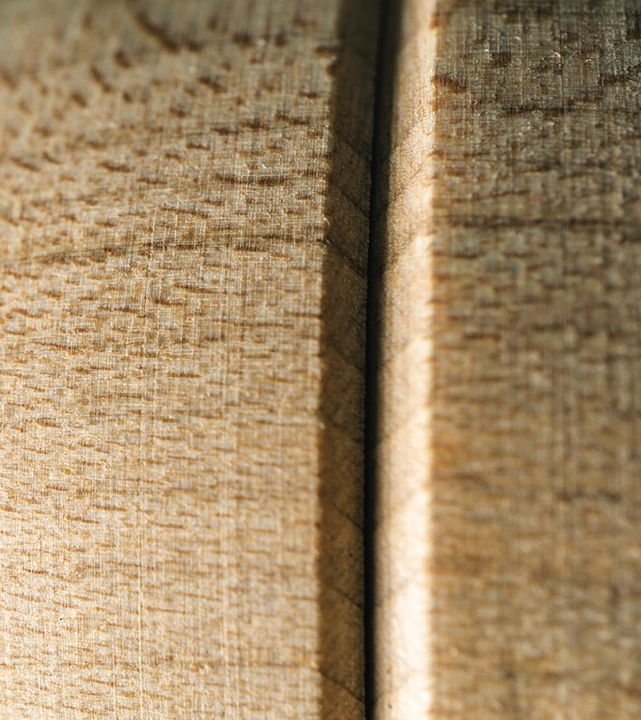

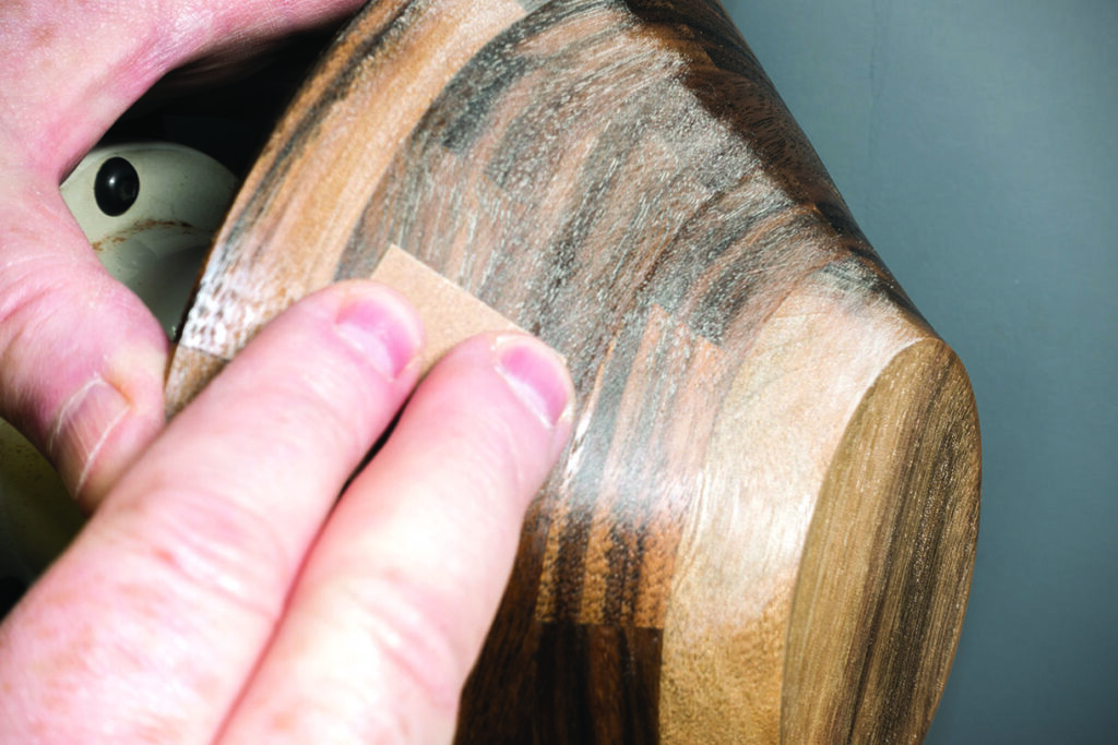

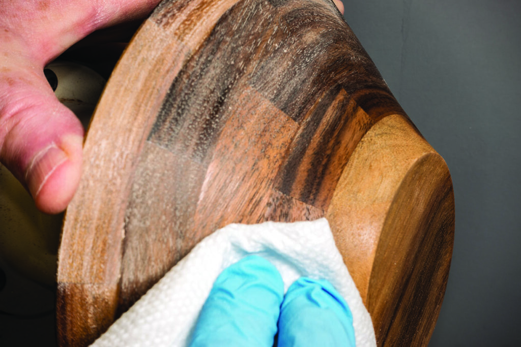

Prep as you would for any finish. Remember, the most important aspect of any finish is the prep work. We dwelt on it at the beginning of this series. It is that important. Poor prep almost guarantees a poor result. Some coalescing finishes instruct you to raise the grain before hand. Sand, wet, let dry well, and re-sand. Remember, these are waterborne. Knocking back the grain beforehand will help with the success of the finish. There are ways around the grain-raising process if you’d rather. Using the universal intermediate coat of shellac will work. An oil varnish stain will also seal the wood. If you’d rather do one of those, you can skip the grain-raising process and go right to finishing. I’m a huge fan of foam brushes and use them to apply finish while spinning the lathe by hand. Others may want to try to apply finish with the lathe running slowly if they can get their controller down far enough. My lathe will go all of the way to off via the speed control but I still favour rotating my workpiece by hand when it is mounted on the lathe. If you have a favourite brush other than the foam brush, go for it. Any quality brush will work. The beauty of using a fine quality brush is that you’ll clean it in soap and water before drying and storing for its next use. More good quality brushes are ruined by improper cleaning than anything else. Especially when the cleaning requires one of the various thinners. A clean cloth will work for applying the finish as well. No power on the lathe if using cloth please. Dampen your cloth with adequate finish and wipe on. Like painting a wall, keep a wetted edge and progress until you get complete coverage. A good wet coat is sufficient. Too much will cause you problems. Far better to have a thin coat that can be repeated many times than a thicker coat with bubbles, runs, or streaking. Of course all of this finishing can be done off the lathe if you wish.

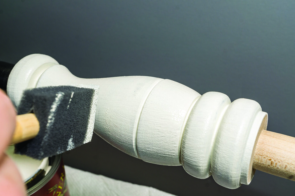

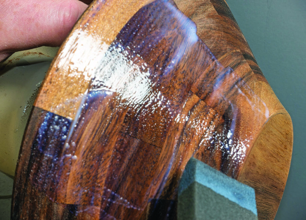

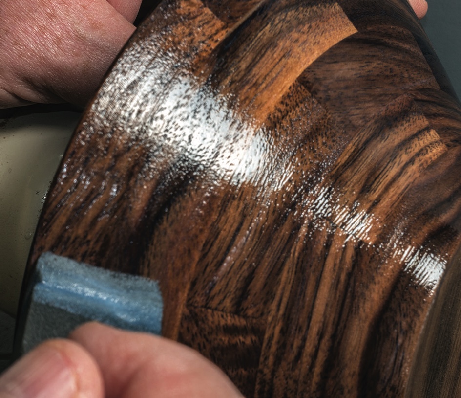

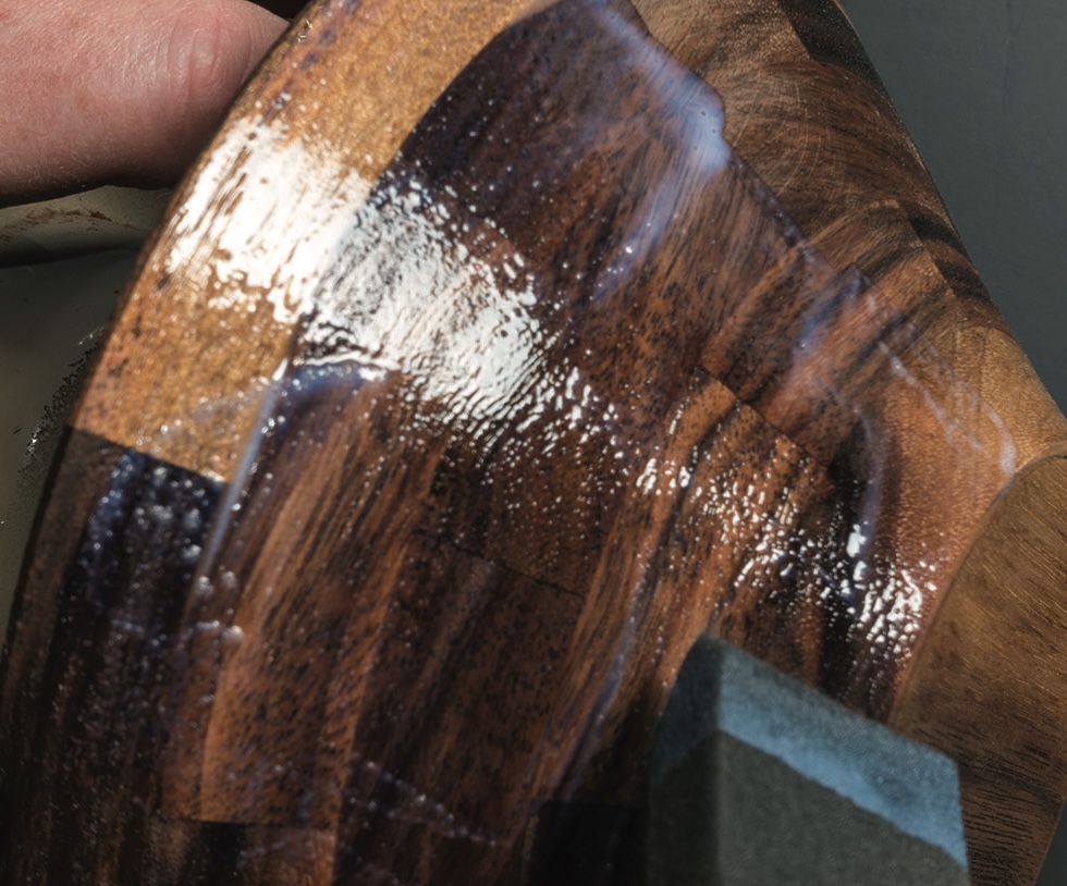

One of the advantages of coalescing finishes is high-solids content. It doesn’t take much to build up a very durable finish. The number of coats is up to you, but I find that three or four are usually more than enough. Unless your instructions tell you otherwise, let each coat dry well. Once dry, I like to lightly scuff between coats. You can use 320 grit, dry or wet with water as a lube – not slobbering wet, just sufficient water to lubricate the surface and help when removing the swarf. After you sand, be certain to remove any of the debris or you’ll embed it into the next coat. You can use a well-wetted rag but, of course, not under power if it is cloth. I typically use a paper towel wetted with denatured alcohol. Once cleaned, you can apply your next coat. The scuffing will help this coat adhere to the coat beneath. Waterborne finishes don’t ‘cut into’ or chemically dissolve the surface of the coats beneath in the same way as shellacs and lacquers will. One of the tricks I’ve learned from some of the more accomplished with waterborne finishes is to make your last coats very thin. This is particularly important if you are going to rub out the finish later on. We’ll cover rubbing out and buffing later in the series.

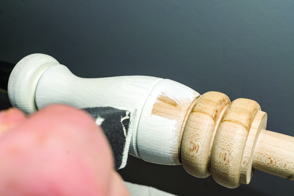

Colouring
One of the common complaints I’ve heard about waterborne finishes is that they sometimes have a blue tint to them. I haven’t experienced it but some claim it is a downside to waterborne finishes. That, along with the fact they sometimes make the wood seem bland and washed out, makes you want to do some colouring. One method you can use with waterborne finishes is to colour before and between coats. You can apply any water-based stain you wish between coats. You can choose the colour based on the wood you are using, the finish, and your final desired colour. One of the beauties of this is that you can dilute the colour as needed to get any intensity you wish. Be certain to let the stain thoroughly dry before you apply any finish coat over the top. You’ll be able to repeat as needed between coats if you require more to achieve your desired results. Another method is to add dye to the finish. Your colourant should be mixed prior to adding it to the finish. Get your dye powder mixed with some water to ensure that it is well dissolved. Use that mixture to colour your finish. Remember to add a little bit of colour and check things. If you put in too much colour, you can’t lessen it without diluting with more finish. The only tricky part is to colour sufficient finish to complete the project. You really will have a difficult time trying to match things should you run out. Err on the side of preparing a bit too much finish for the project so you don’t run into that problem.

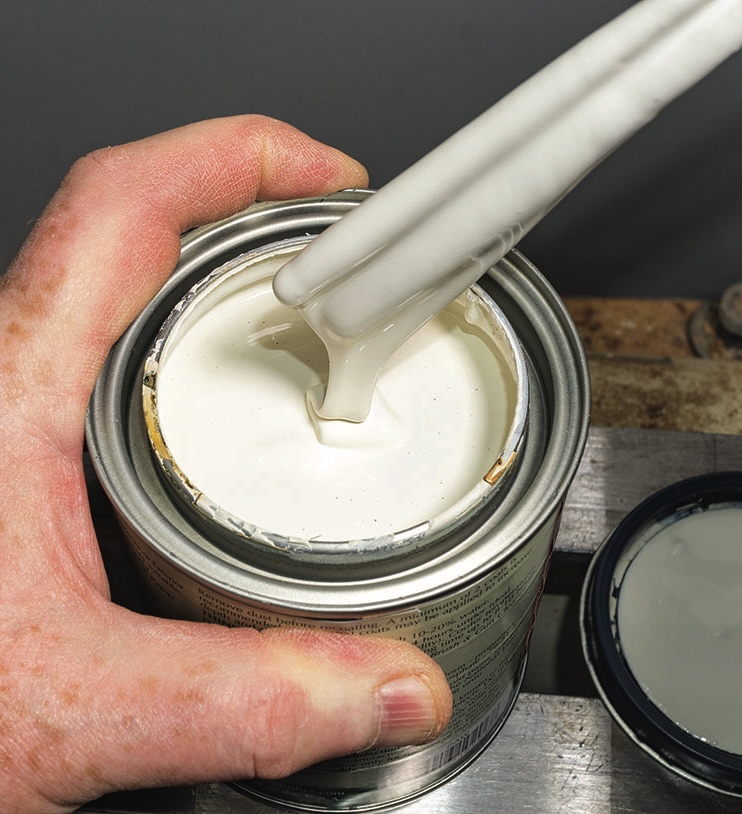

Paints of various kinds are now being used by turners and, given the pace of developments, we may see an ever-increasing use of them. The debate of whether to colour or not and the issues that some finishes may cover the wood will continue, but many turners are using paints and, since they fit in this category of finishes, they need mentioning.

• Stir the product well. Then stir more. The solids will have settled to the bottom. Uniformity requires thorough mixing.
