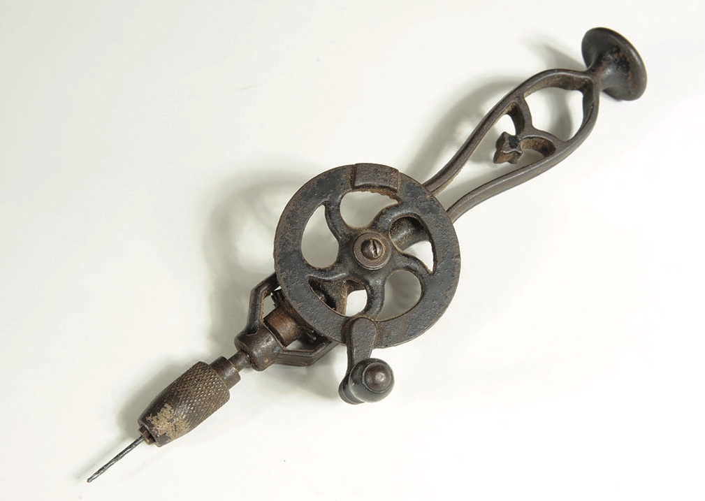

The wheel brace or hand drill relies on a bevel gear to make it work, transferring the rotary motion of the hand to a vertical or horizontal rotary motion of the chuck. By the 1850s bevel gears could be machine made accurately and were soon used on drills to improve their performance over the age-old brace and bit. The Americans in particular saw the advantages they gave and went into large-scale production; Millers Falls feature in their 1887 catalogue a full range of drills that were to set the pattern for the next 100 years. Close copies of these drills were later made in England but in my opinion few could claim to be as good and ingenious as the American imports.

By 1816 there were simple hand drills made in either France or Germany with a forged iron frame and two gear wheels of the same size giving a one-to-one gearing. The bit holder was similar to the normal brace, using square tapered tangs.

Early iron wheel brace
