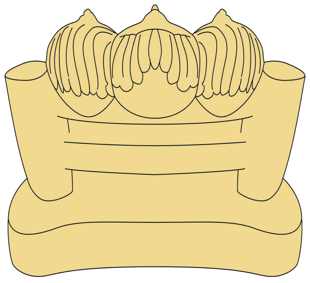

Drawings

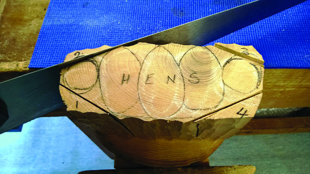

Preparation

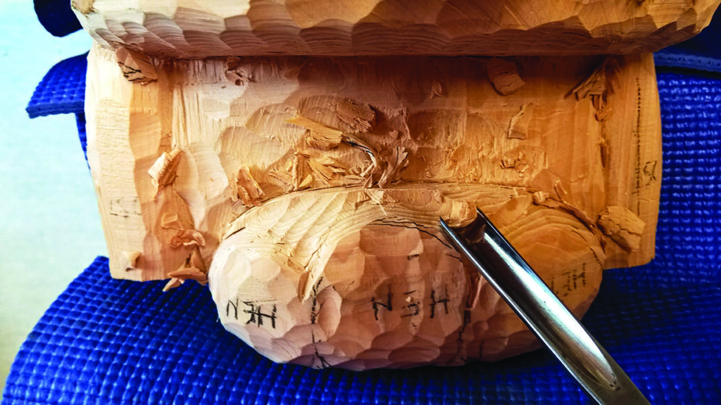

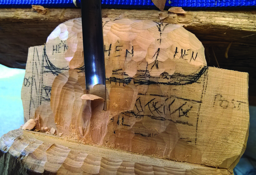

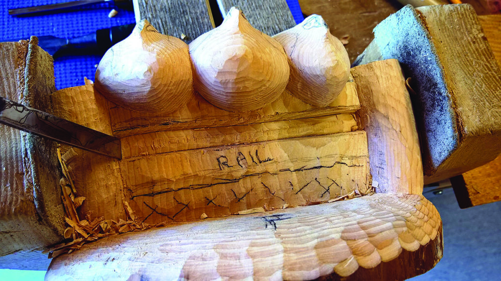

Starting carving the hens

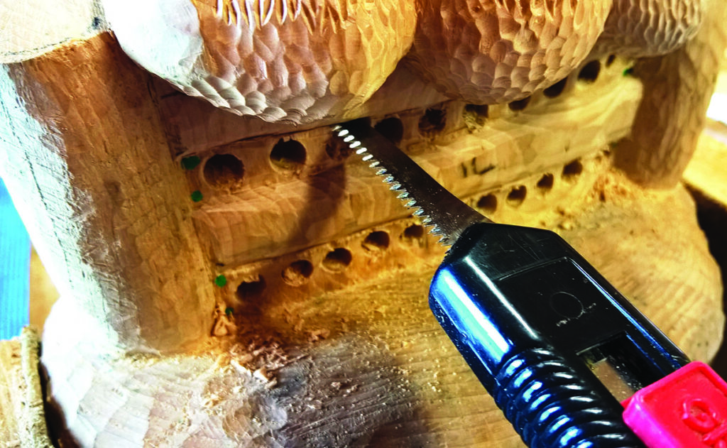

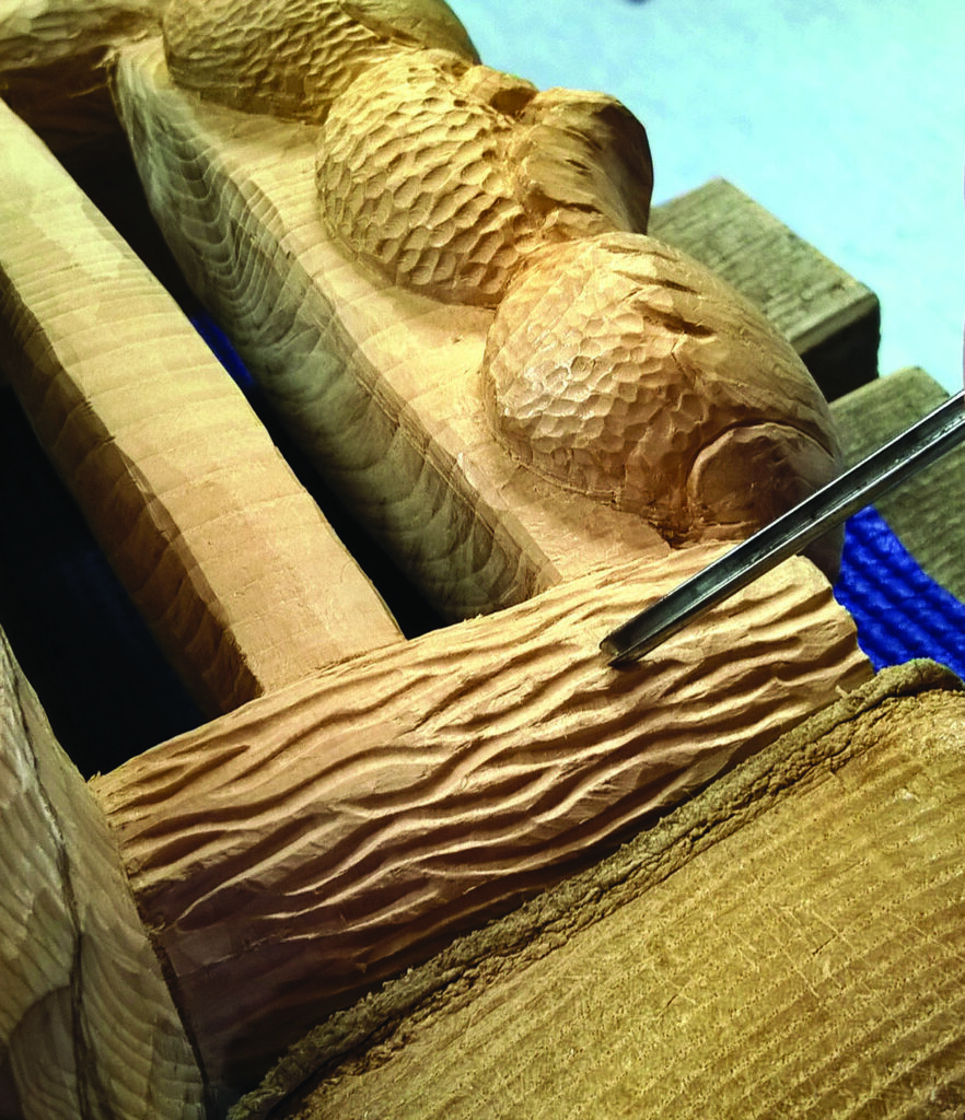

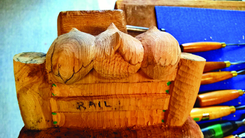

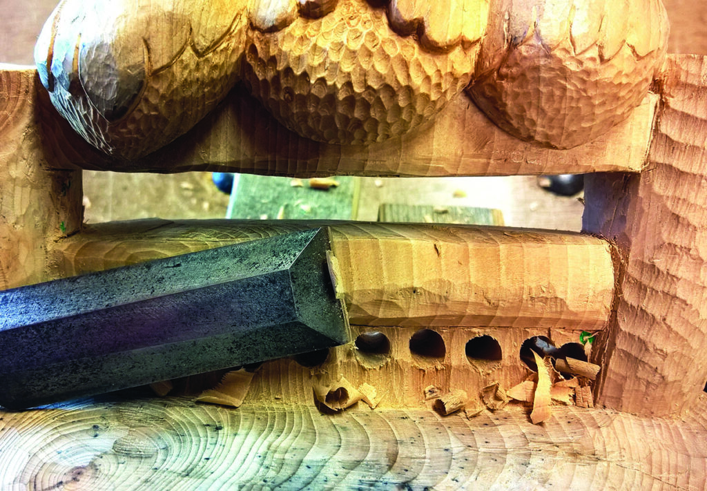

The rails

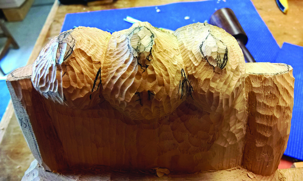

The tails and rear ends
