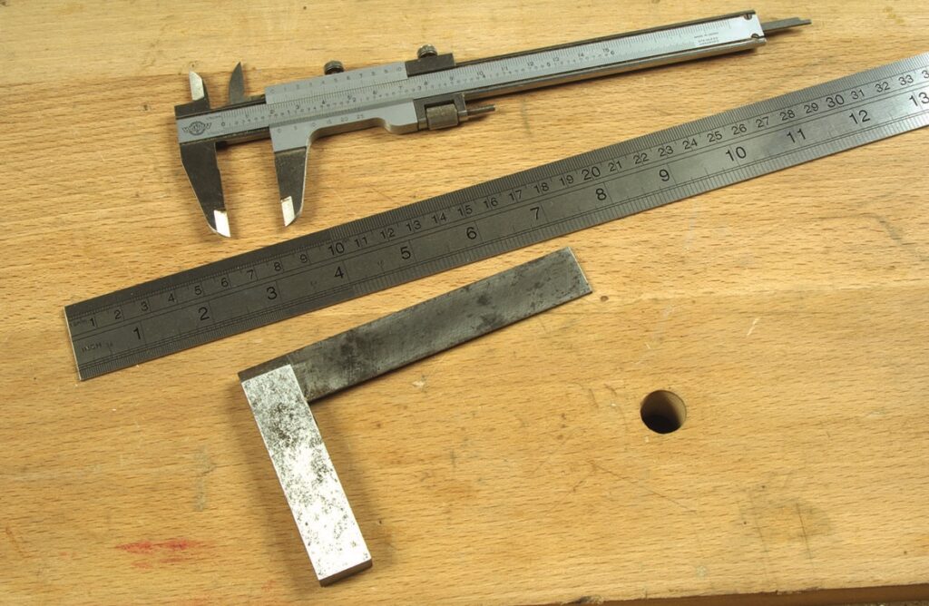

Use good quality measuring tools; a Vernier gauge is good for checking exact thicknesses and diameters, saw blade teeth or router cutters for example. An engineer’s square is far, far better than a trysquare for accuracy
Accuracy with wood relies on metal as a rule. Measuring tools are mostly made of metal because it is compact and reliable. So the first step is to make sure you have the means to check accuracy by having good quality measuring tools. A 300mm steel rule and a steel engineer’s square will sort out most problems. Nowadays there are digital angle gauges which are useful for achieving exact settings.

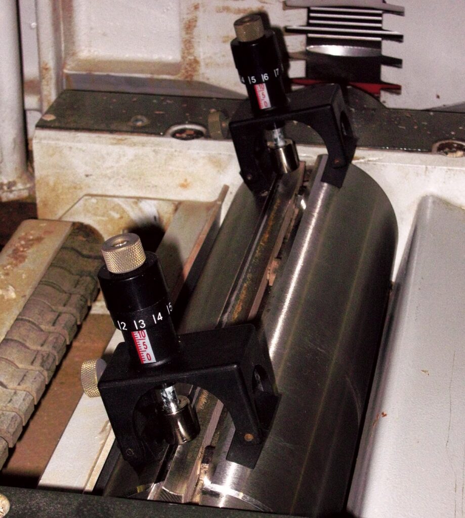

If you have a planer/thicknesser setting the blades accurately is a pain just using a marked wooden batten to show blade ‘pull over’ distance and problems with blades ‘floating’ as you tighten them up. Instead you can buy a planer blade setting jig, it costs around £30–60 for basically the same model, so you just need to shop around price-wise. It will save you so much stress and aggravation, as well as giving consistently accurate setups each time. It comes loaded with rare earth magnets so your machine needs to have cast iron tables, not aluminium ones. The engineer’s square is essential for fence adjustment, although extruded aluminium fences are seldom flat all over so you have to find a compromise position.
Exact planer blade setting is a cinch using a pair of these height setting gauges

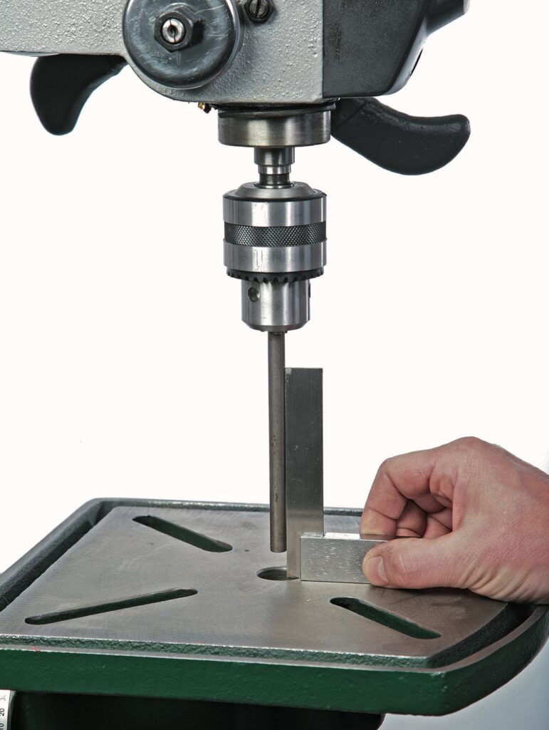

If the drill bit won’t centrate in the chuck you may be able to buy a better chuck, but of course the shaft it is fitted to, may itself not run true, so the process of improving accuracy starts by identifying the problem before you can correct it. It’s important the drill chuck grips evenly and squarely, of course. Make sure the machining table is perpendicular to drill chuck by placing a long drill bit in the chuck and then lining the square up against it.
To check whether a pillar drill table is level, use a straight piece of rod in the chuck and an engineer’s square

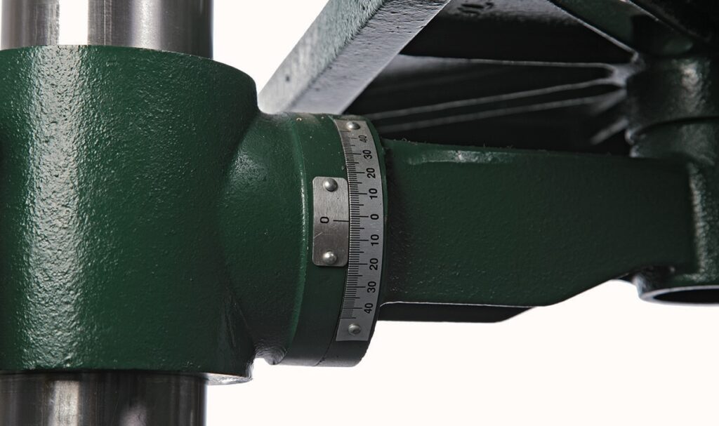

Side to side table adjustment on a pillar is usually possible but be warned, there may be a roll pin fitted at zero setting that may need to be removed

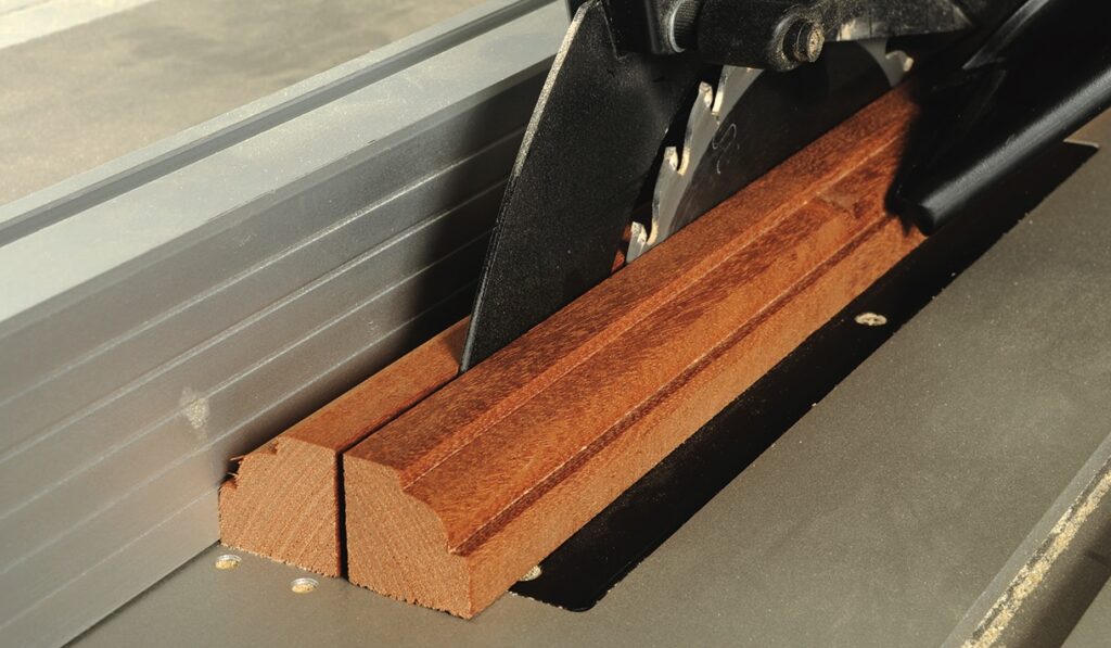

only be blunt or have damaged teeth, it may not be very well balanced. Rather like motor car wheels, better quality blades are checked to make sure they are running true. So try a blade change first before assuming the arbor is to blame. The fence may not be properly aligned. On a tablesaw it needs to be parallel with the blade
or even ‘toe out’ a fraction. If it has a ‘toe in’, wood will become trapped, so you need to try cutting a block and see when it is placed both back and front between the static blade and fence, whether there is any difference;
in which case adjust accordingly.
If the tablesaw rip fence has any degree of toe-in the wood can get trapped; the setting should be parallel or
fractionally toe-out

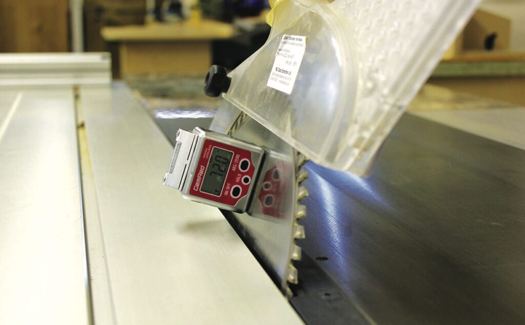

More recently compact digital angle gauges have made bevel cut setting very precise

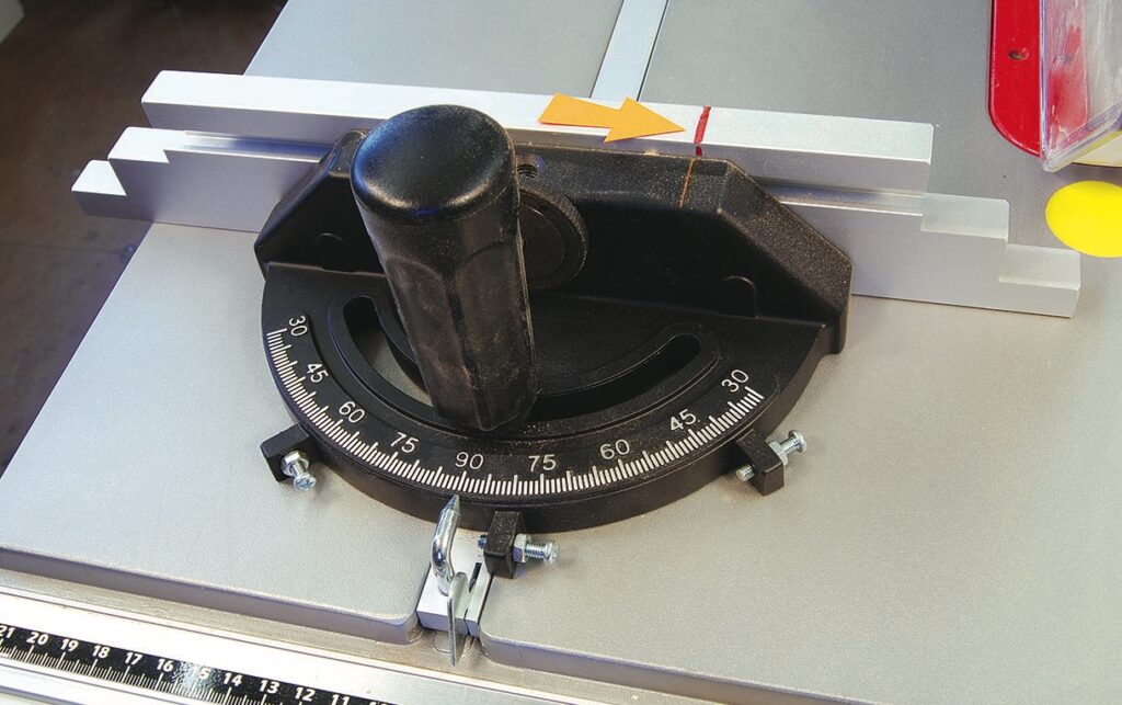

Crosscutting frequently causes more problems than rip cuts. A mitre protractor on a tablesaw runs in a slot. Often they are not correctly zeroed, so you need to do test cut and alter the fine adjustment screw by degrees until the problem is dealt with. To check squareness you either need a very large and probably expensive engineer’s square, or do what I do and use a flat sheet of paper to mark squarely (as paper is guillotined precisely). Cut and check and if necessary adjust the fence so the cut gets closer and closer to the desired line.
Mitre protractors should have adjustment screws; it is worth taking time to set each one correctly
