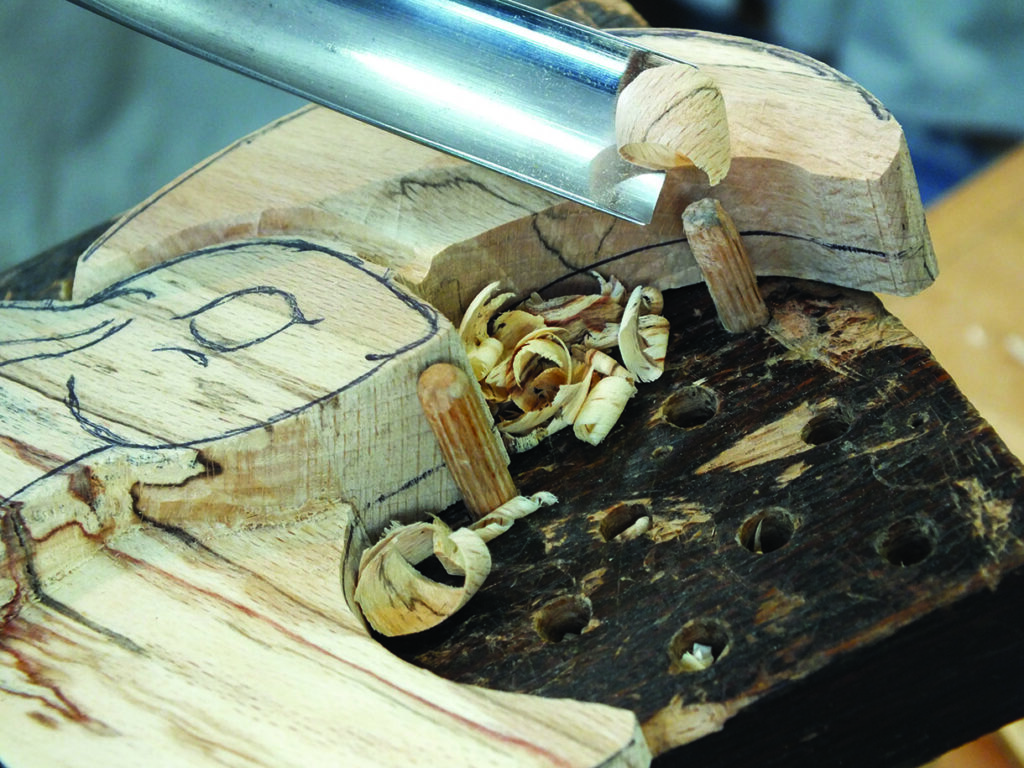

Making a peg board is quite easy. Use some scrap old wood, such as an old shelf. Chipboard or plywood can be used, although solid wood works better as the holes stay stronger, which means it can be used many times. Either mark out a 1cm square grid across the board and drill some 6mm holes into the board on the crosses of the grid to about two-thirds of the thickness of the depth, or place the carving on the board and mark out a few places around the edge of the carving, then drill some holes. Either way, use some 6mm dowels in the pre-drilled holes to hold the project securely whilst carving. The peg board can then be attached to a carving vice or similar.

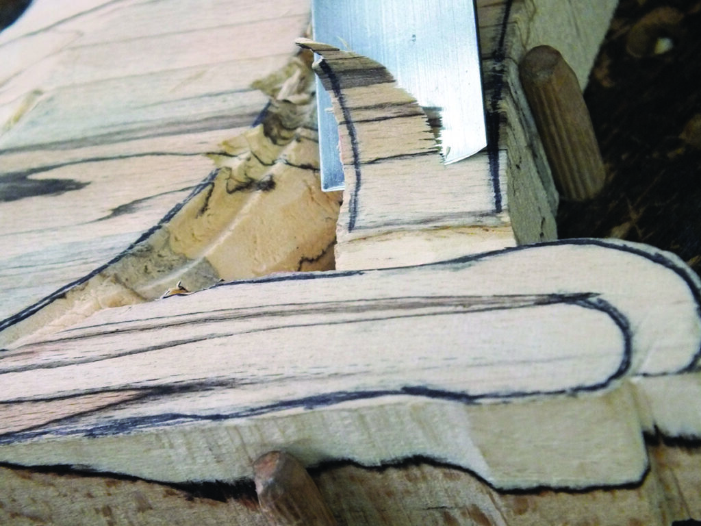

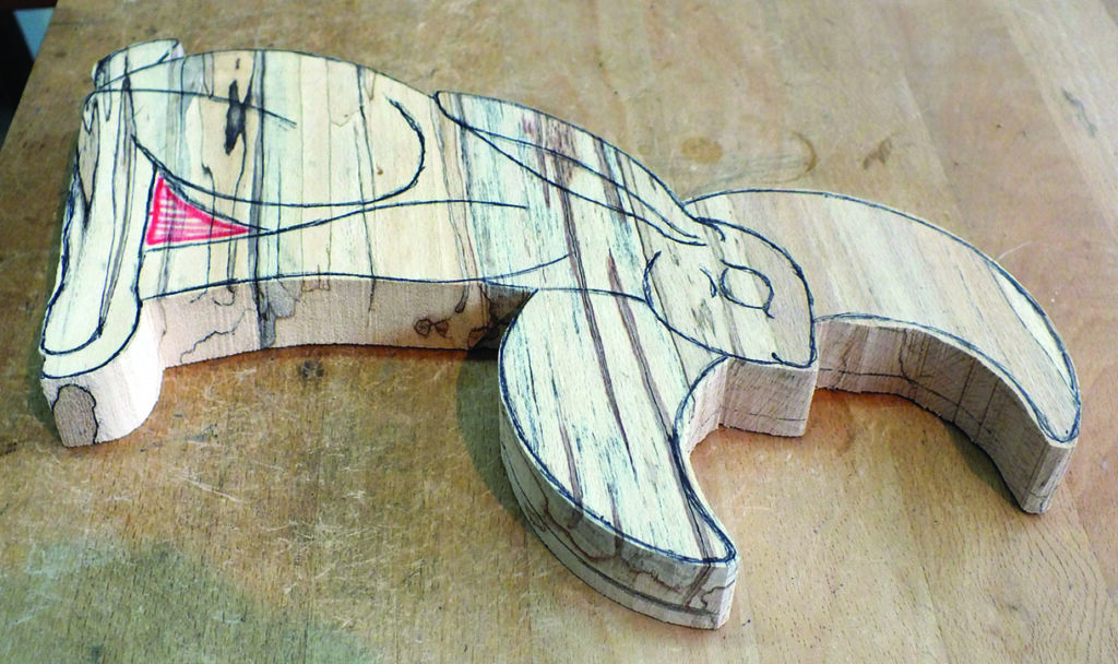

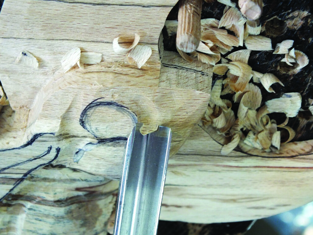

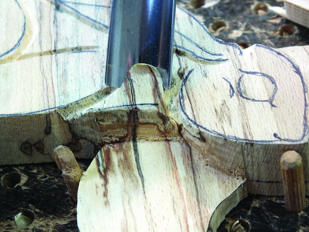

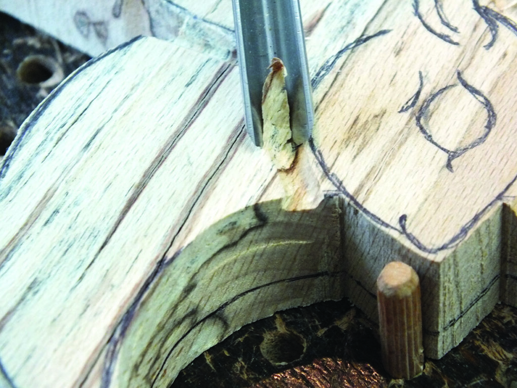

1. After transferring the design to your chosen timber, use a bandsaw or similar to cut just outside the outline removing the waste wood. Then on the side of the moon measure roughly 10mm from the back and draw around the edge of the moon and head. This will be the thickness of the moon2. Now drill a hole in between the legs, then use a coping saw or jigsaw to carefully cut out this area. Try to use a fine saw blade to remove this area if you can. This will make cleaning up later easier and there will be less tear-out of the grain if the wood is soft from the spalting3. Now secure the project ready for carving. Using a peg board is a good way to secure the carving to a vice, then use a deep 11 sweep gouge or V-tool to carve around the outside of the head, separating it from the moon4. Use a deep gouge to lower the moon to a few millimetres above the depth line drawn earlier, then use a shallow gouge to flatten and smooth the moon’s surface to the required thickness5. Use a V-tool or similar to outline and carve around the limbs and the ears, separating them. Then use various gouges and start to shape the body. In this stylised hare the limbs will stand proud of the body and the back leg and the ears will remain at their original surface level6. Use a shallow gouge and carve the front leg so it slopes down and goes under the back paw by about 5mm. Then, round over the front leg and use a small deep gouge to carve around the toe on the back paw. Continue rounding over the paw and leg, keeping aware of possible tear-out when carving down the front leg as your carving across the grain and the soft spalting can tear. Use a slicing cut and take small slithers if the grain starts to tear7. Use a deep gouge and carve around the cheek, then carve across the eye so the cheek stands proud by a millimetre or two, then draw a circle for the eyeball with the very bottom of the eyeball going just under the cheek. Use the deep gouge to carve around the eyeball and around the ear. Use a shallow gouge to round over the eyeball and cheek, blending the features together8a. Use a shallow gouge to round over the back of the ear then using the pattern as a guide8b. Redraw the inner ear and use a deep 11 sweep gouge to carve out the inner ear. Keep aware of the grain direction to prevent breakout

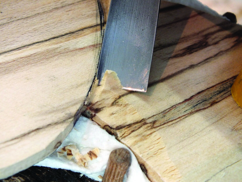

Hardening soft areas
Some parts of the spalting can be very soft and will tear when trying to carve. Sanding sealer and Cyanoacrylate adhesive (CA) can help to harden the soft areas, the adhesive will darken and stain the area slightly and both will blunt the chisels edge slightly so you will need to keep the edge stropped.

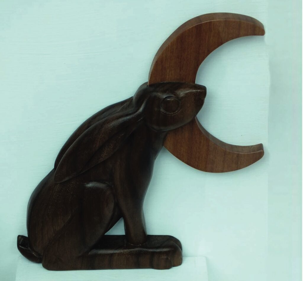

You could carve a crescent moon separately and place it behind the hare’s head by carving away a section from the back of the head so the moon sits flush with the back of the hare
