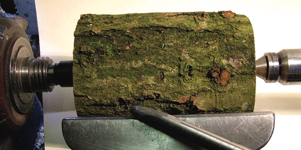

1. Mount your log – in my case a 16 x 10cm semi-green oak (Quercus spp) log – and mount it between centres on your lathe. This size will be enough to produce two small bowls. I will be able to rough down the log and make these bowls using the long-grind bowl gouge shown in the picture. As bark is unpredictable and could fly off erratically during the roughing down process it is prudent to wear a protective face shield and also to stand to one side

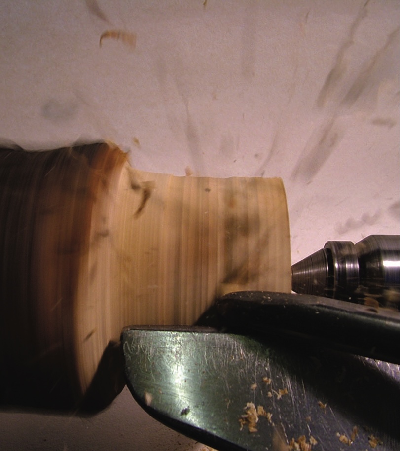

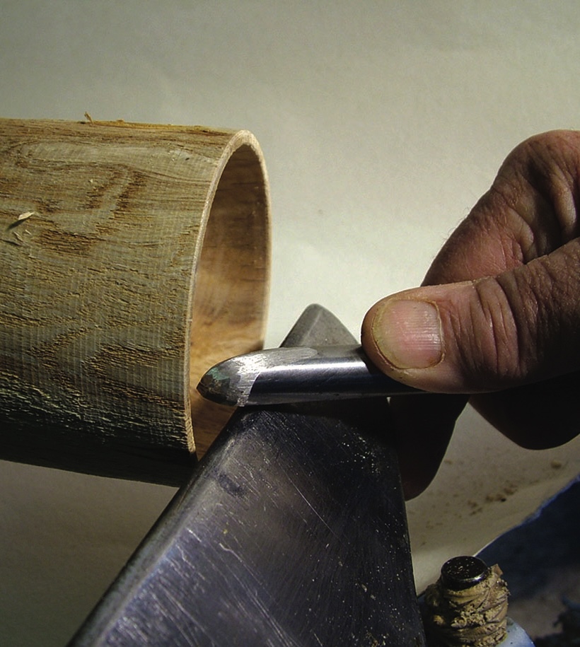

2. To remove the bark, about half of it to start with, lay the gouge at an angle of about 30° off horizontal and have the flute angled to the wood so it is at about the 2 o’clock position. Have the lower wing gently make contact with the wood. Open the flute up to 1 o’clock for a coarser cut or close it down to the 2.30 position for a gentler scrape-type cut. Once you have the cut you require, run the blade along the rest to make multiple cuts to remove the bark down to clean wood. The flute always points in the direction of travel and the cut occurs on the lower wing. Remove half of the bark – you can see how uneven this log was

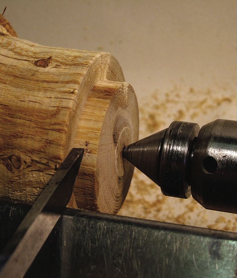

3. Once the bark has been removed, take the diameter of one end of the log down to about 80mm. Using a parting tool, cut a spigot to suit your chuck jaws with a parting tool. Once cut, mount your timber securely in your chuck. Once securely held, bring up the tailstock and rough down the blank to a true cylinder

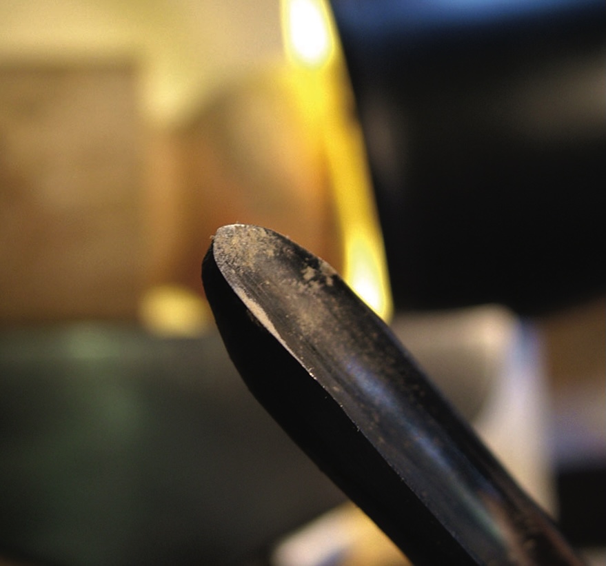

4. Once you have your cylinder the hollowing process can begin. Due to your not going very deep the swept-back gouge used earlier can be used for this too. You can see it has quite a blunt front bevel angle. This will help you reach all of the surface of the tight internal radius curve. Start by either boring a hole in the centre or use the gouge to create a slight hollow and then extend this till you get to the required internal shape. Use a scraper to clean up the shape if you need to

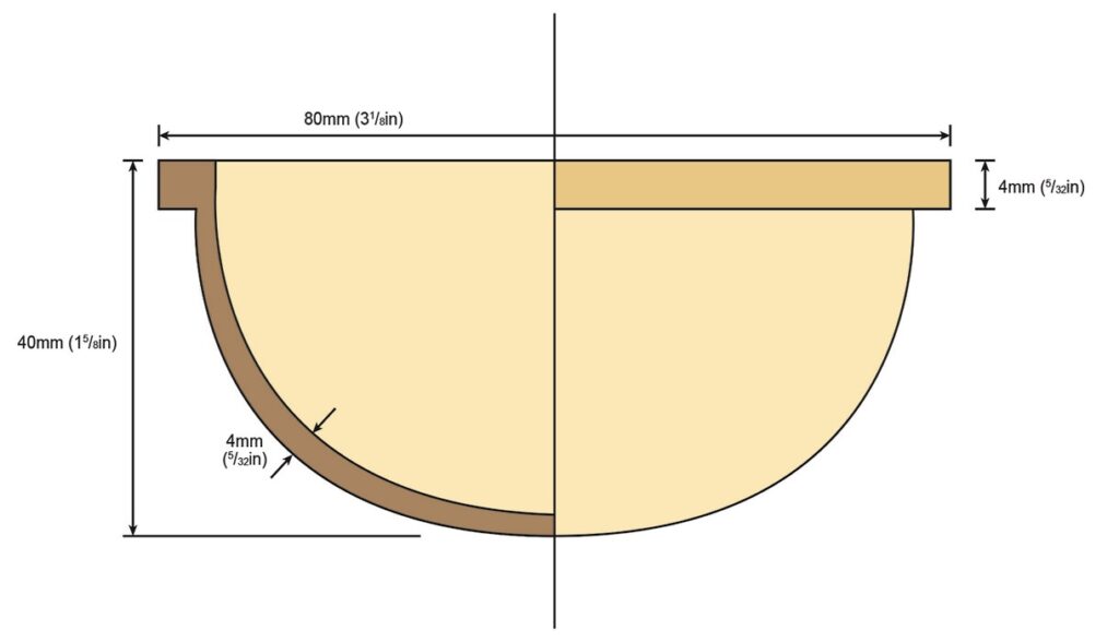

5. Technically you are meant to cut with the grain, from the centre out towards the rim section. Truthfully, on these shallow vessels, you can cut against the grain. It leaves a slightly worse surface than cutting with the grain, but it is easily sanded. Whichever cut direction you use, the entry angle of the gouge should be such that the flute points in the direction of travel and you enter in line with the bevel cutting on the lower wing. Begin in scrape mode and open the flute to get a better cut as you progress. A 3mm or 4mm even wall thickness is required to prevent cracking when it dries. It will go out of shape, but the even wall thickness drastically minimises the risk of cracking

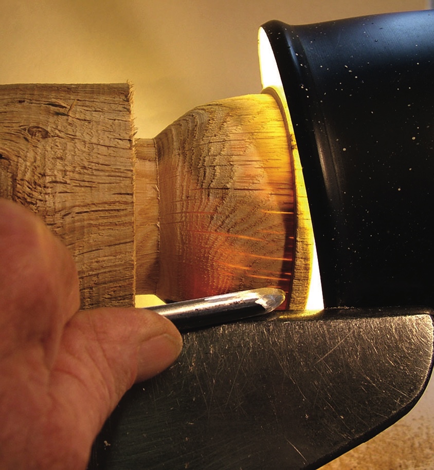

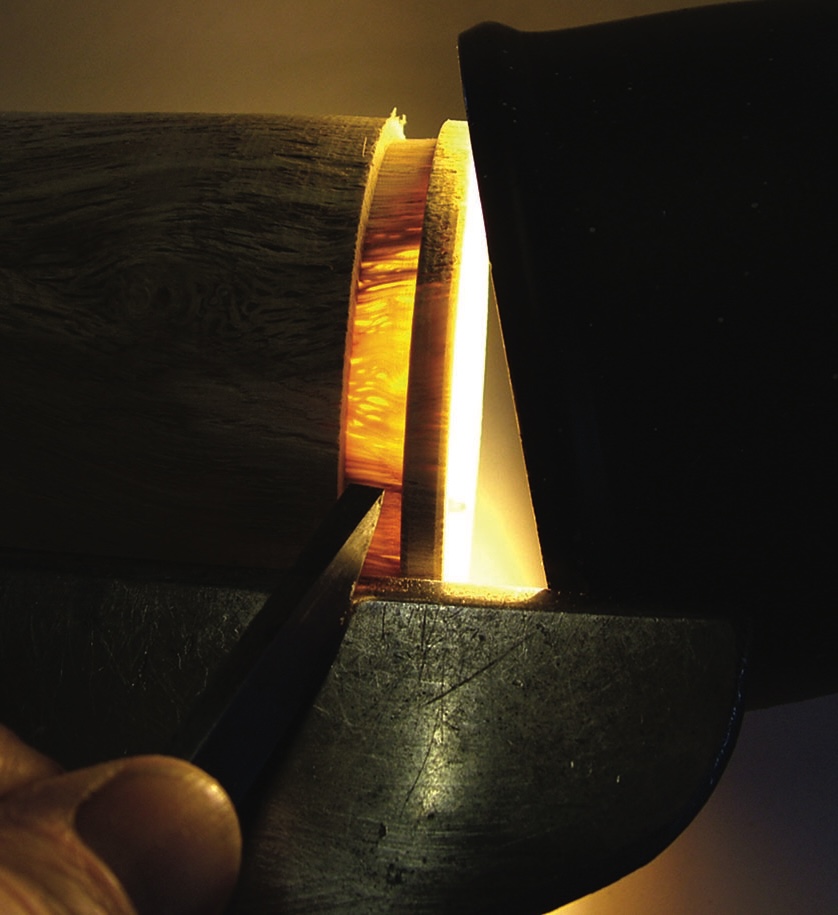

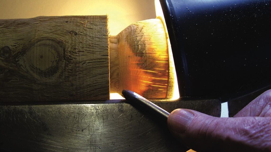

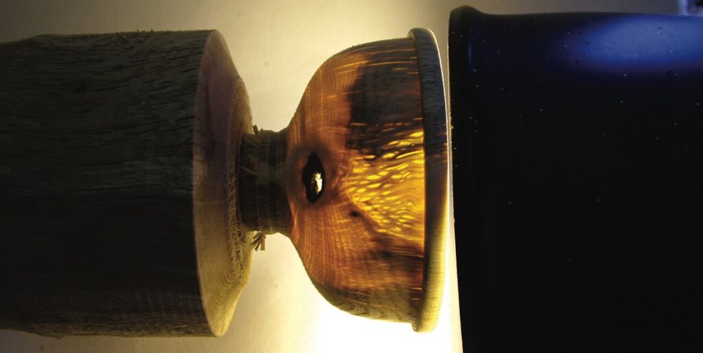

6. This is where I went off at a tangent from my original intent of an even-walled vessel. Instead, I chose to create a thin-walled vessel with a lip. Using the 4mm parting tool I took the wall thickness down to about 2-3mm, being guided by the use of a lamp fitted with an LED bulb so it doesn’t generate heat and I could see the wall thickness. Here the translucence of the thin wall is apparent and shows the cellular structure well. This only works when the wood is wet, the translucence diminishes as the wood dries out

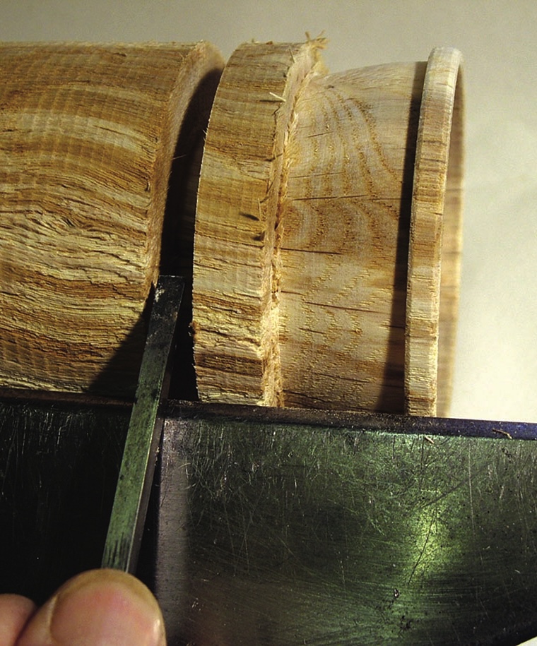

7. To gauge where your base needs to be, use a parting tool and cut a groove down to about 50mm in depth. This cut acts as a guide so you can see what outer timber needs to be removed. Allow a 4mm wall thickness beyond the internal bottom of the bowl curve so you have enough material to adjust the shape and sand to an even wall thickness

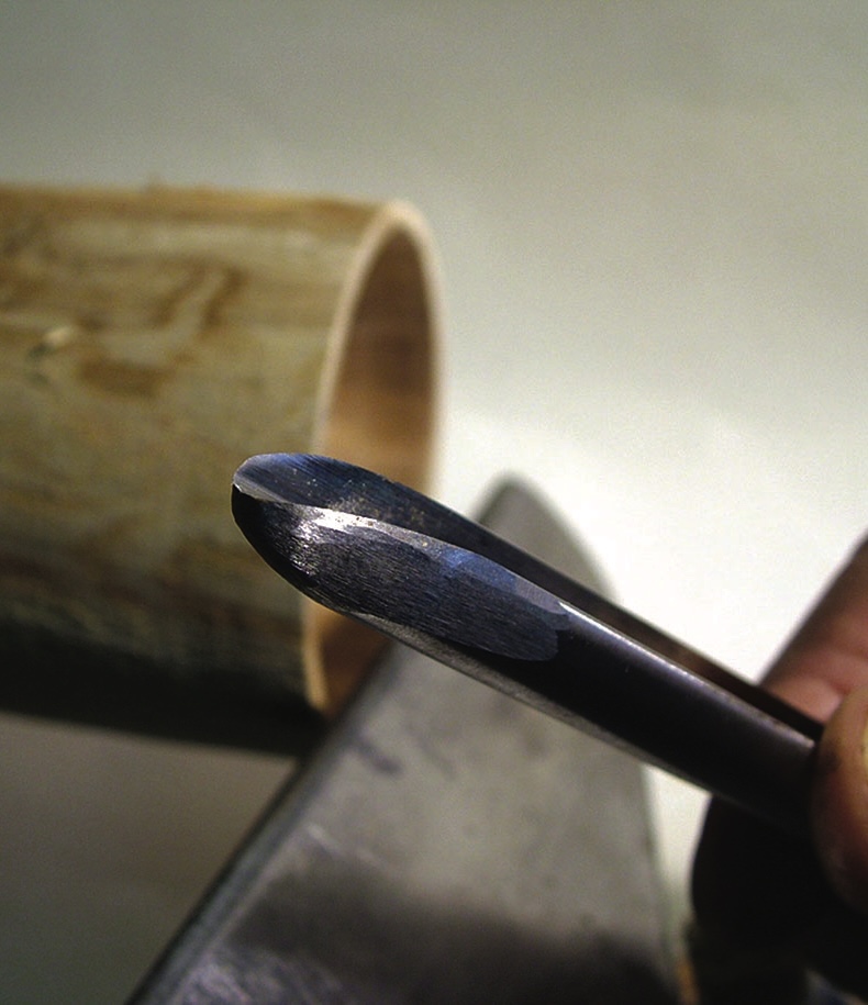

8. Spindle gouges are very versatile, but, like other tools, should be sharpened regularly. Once the shape is roughly what you require, you can refine it by using the gouge in scrape mode
9. To do this, use with the flute facing the wood. As with the bowl gouge, the cut occurs on the lower wing, but the flute points at almost the 9 o’clock position to get a gentle scrape. Work form the rim down as far as you can

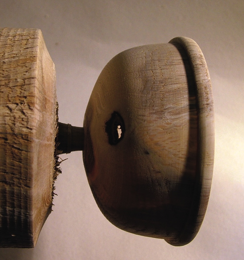

10. After removing most of the waste at the top section use the spindle gouge to work closer to the base. The gouge needs to be reversed to reach the underside section. Instead of a pull cut/scrape you need to make a push scrape. Continue until you have a more consistent outer wall thickness11. This gouge is useful as it can be gently stroked along the surface to obtain a consistent outline. Note the use of the light to see if the wall thickness is even. There is a slight belly in the shape – adjust until you have the curve you want. I wanted to create this profile but noticed a dead knot inclusion. A feature will have to be made of this
12. Now take a parting tool and reduce the solid waste at the bottom a bit down to about 10-12mm, which leaves enough support for sanding later on. Then refine the shape until you have reached the lower connecting spigot At this stage, the turning could well become a goblet, but not with the dead knot inclusion. The piece is now ready for sanding both inside and out. Once sanded, cut through the waste spigot with a saw while the lathe is stationary and sand bottom round

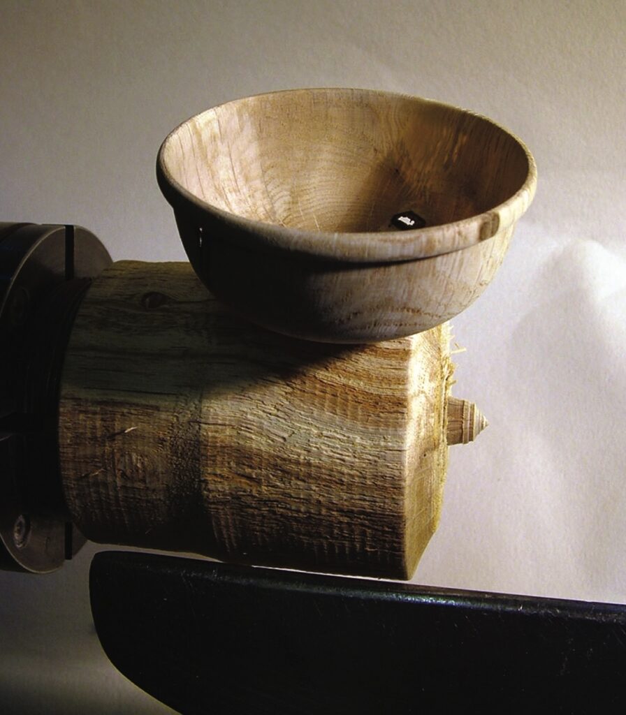

13. You can see there is enough material for another bowl

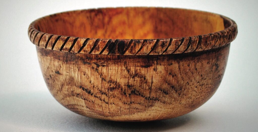

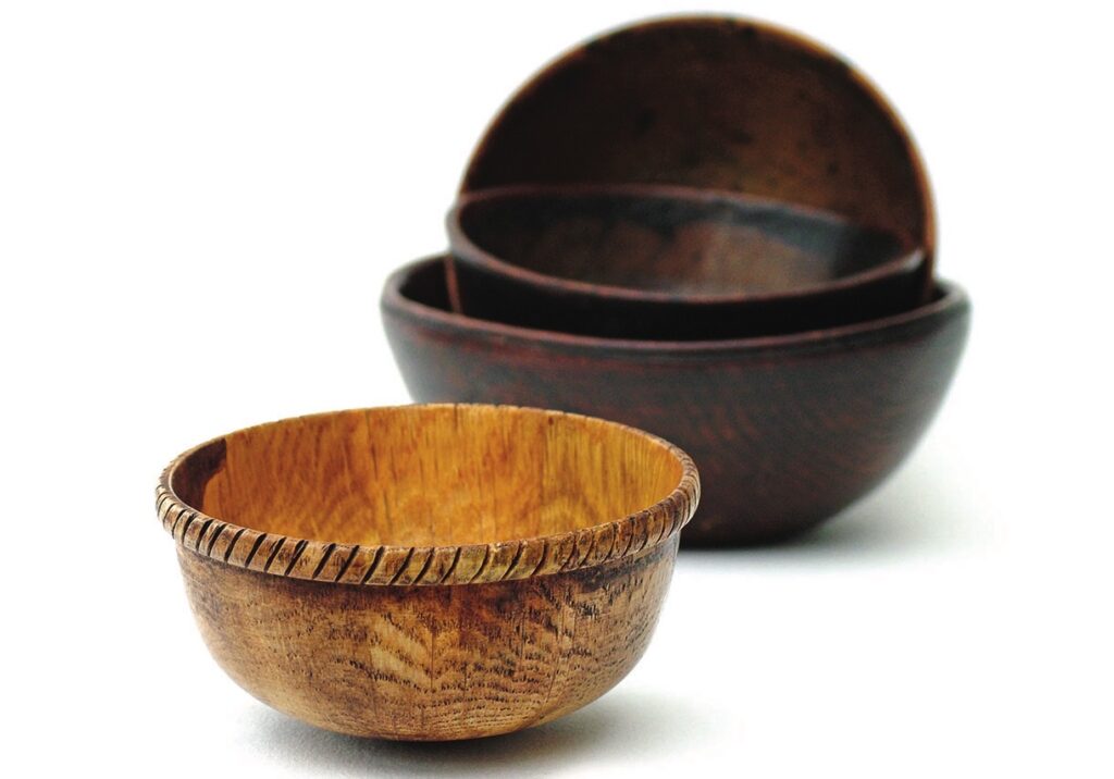

14. You can leave the rim plain or create a simple rope feature. This can be added to the rim by way of simple grooves cut by a saw, or burnt in with a scalpel edge pyrography tip, or cut in with a fine edge bit held in a rotary carving tool or a fine file

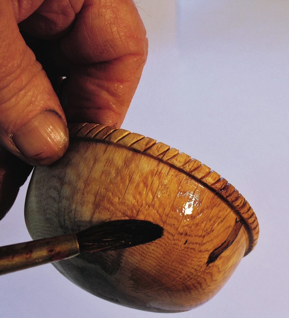

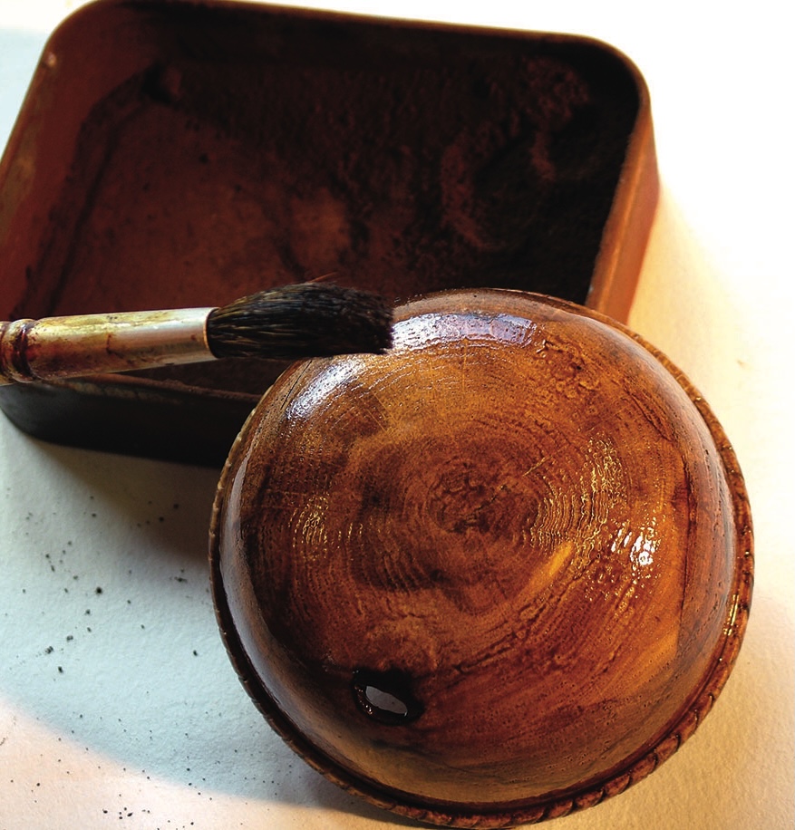

15. Now is the time to apply a finish of your choice. I wanted an old, used, patinated look so chose to use button polish, which is a golden form of French polish. I applied two successive coats with a brush, the second after the first had dried. Once the polish is dry a coat of burnt umber powder suspended in methylated spirit is applied quickly, allowed to dry and then mostly removed with fine wire wool. That which remains gives the impression of age acquired patina
16. If all goes well you will have a completed patinated bowl. Note how the patina has highlighted the rope-effect rim. Since the bowl is round-bottomed it wobbles

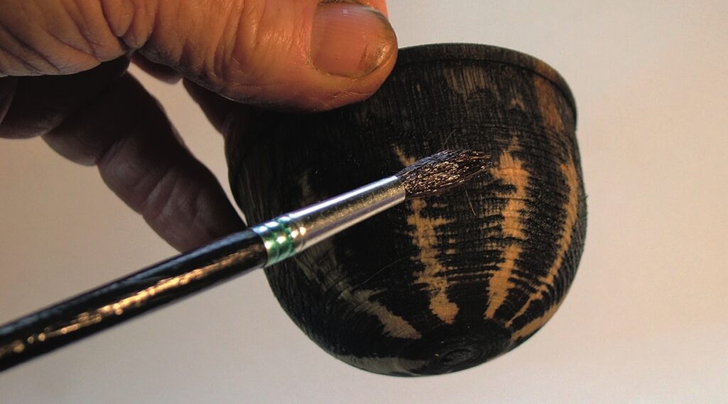

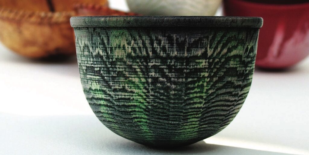

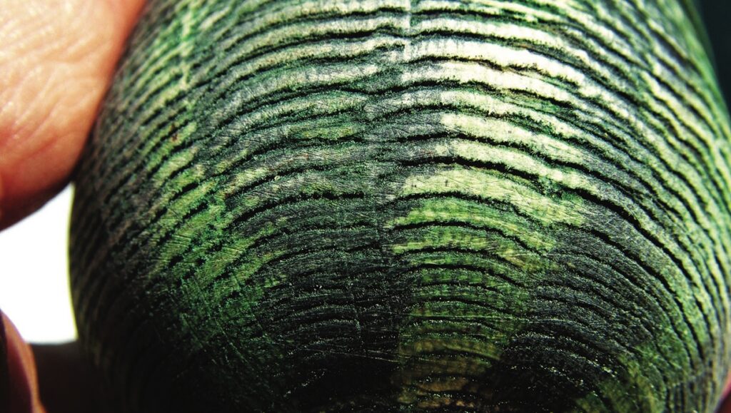

17. Another form of simple ageing is the use of vinegar infused for a few weeks with wire wool. This treatment will only work with woods with a high tannin content such as elm (Ulmus spp), sweet chestnut (Castanea sativa), walnut (Junglans spp) and oak (Quercus spp). Here it is being applied to another oak pot – the effect is immediate and quite dramatic. There are woodshade spirit and water based dyes to explore too18. After drying this pot had its surface brushed over with a wire brush while revolving in the lathe prior to parting-off. The resulting surface texture was further enhanced by using green spirit stain. There are lots of colours to explore19. Some turning folk are not keen on colouring. In this case I think my treatment enhances the grain in its own unique way. Here is the finished green pot20. An alternative is to use spray paints. These are available from DIY and automotive stores. The colours used on this pot were red oxide undercoat with a dash of white. Do experiment in colour as well as the size of pot turned. There are endless shapes and colour combinations awaiting you
