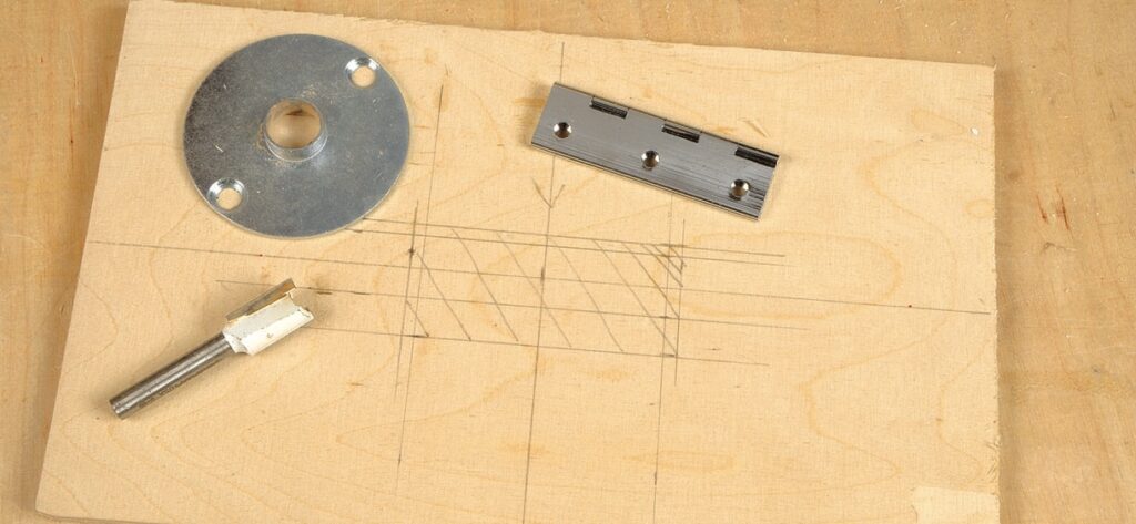

Take a smallish rectangular offcut of 6 or 9mm MDF and mark across it the length of the hinge. Now mark the folded width of the hinge including the knuckle in the middle of the width of the MDF. This will be roughly where the jig will sit on the door edge.
Now measure the difference in diameter between the guidebush and the chosen cutter. Divide this figure and this will be how much bigger the jig cutout needs to be for the cutter to create the right size opening. A typical example: 16mm dia guidebush minus a 9.5mm straight cutter = 6.5mm. Divide to give 3.25mm but round it down to 3mm as the 0.25mm is hard to measure out exactly.
Mark an extra around 3mm at each end of the jig, don’t worry about altering the width as you now need to make a U-shape cutout so the jig can be moved across slightly afterwards to account for the guidebush offset amount.
Woodworking tools on wooden board with grid sketch.
Choose the appropriate hinge size, then the guidebush and a suitable cutter which can be a straight bit or a hinge mortising bit. Mark the hinge position in the middle of the jig board and add the guidebush to cutter offset around the ends and one long edge

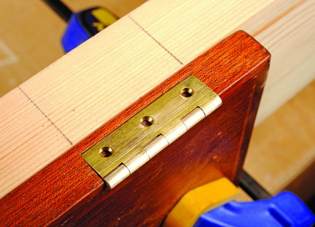

Now lay the jig on the door edge and work out where it should be widthwise. Some hinges will be narrow enough that you won’t need to machine right across the width of the door so deciding this is quite important. Mark the jig where the door edge is and remove it so you can neatly screw a fence in place using a fillet of softwood. At this stage don’t glue it until you have done a test cut.

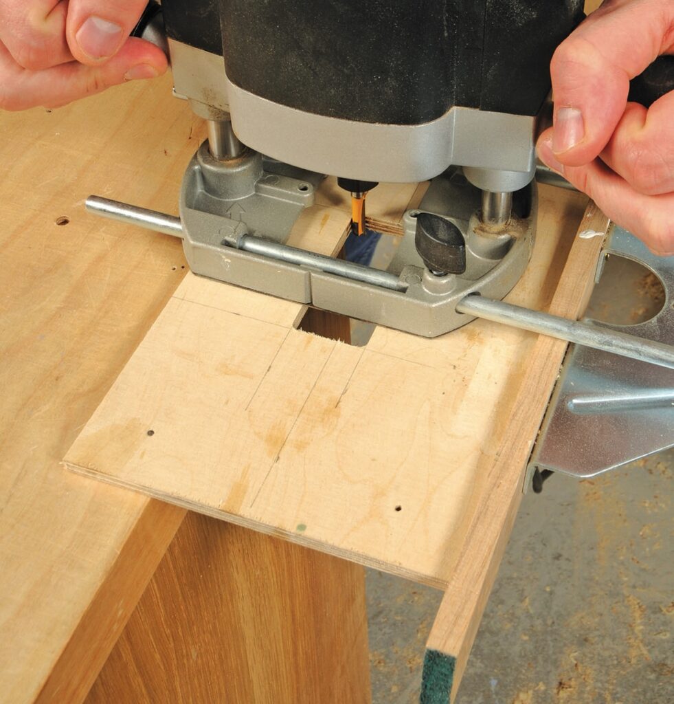

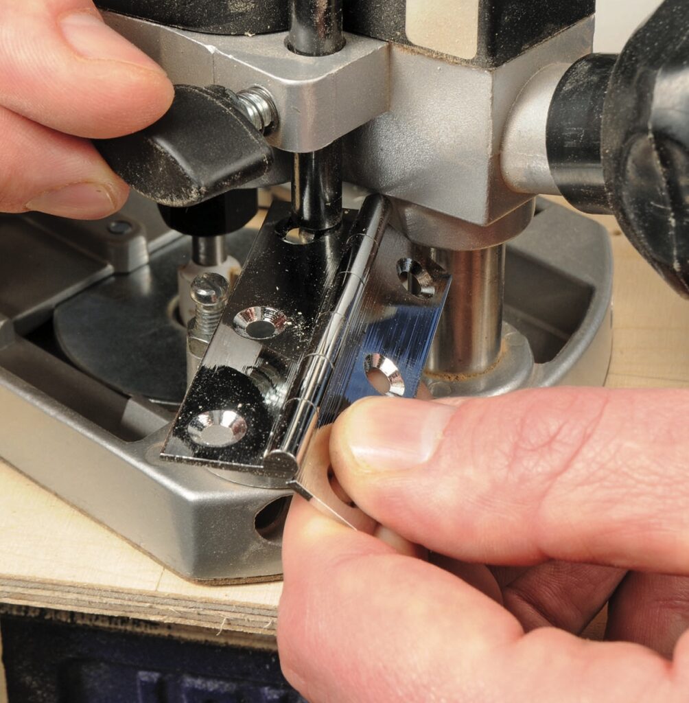

Do a test cut on a scrap of wood to check width position. Fit your straight cutter or a mortise cutter if you have one and press the static cutter down on to the test once the jig is clamped in place. Now place the unfolded hinge under the depth stop which you need to press down on the hinge and lock off. I would suggest the depth needs to be a fraction more than hinge thickness so when the door is fitted, there should be a slight gap on the hinge which avoids stressing the hinge and screws holding it.
Do the test cut running along the outer edge of the workpiece first so it is cut away cleanly, then move inwards removing the rest of the waste. Unplunge and switch off and withdraw the router.

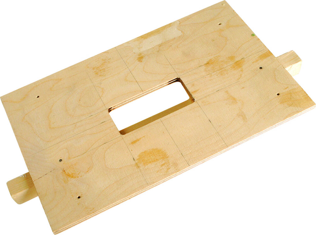

Fix the jig board down, in this case pinned to the edge of the workbench and machine out the jig opening using a 6.4mm straight cutter and fence making sure you cut the edge furthest away from the fence so any deviation in the cut line goes into the centre waste area
Wooden panel with central rectangular cutout

Place the unfolded hinge under the router depth stop once the recessing cutter and guidebush has been fitted. This gives the exact hinge depth cut needed but it pays to add a little more so the door closes neatly without too much of a gap between door and stile

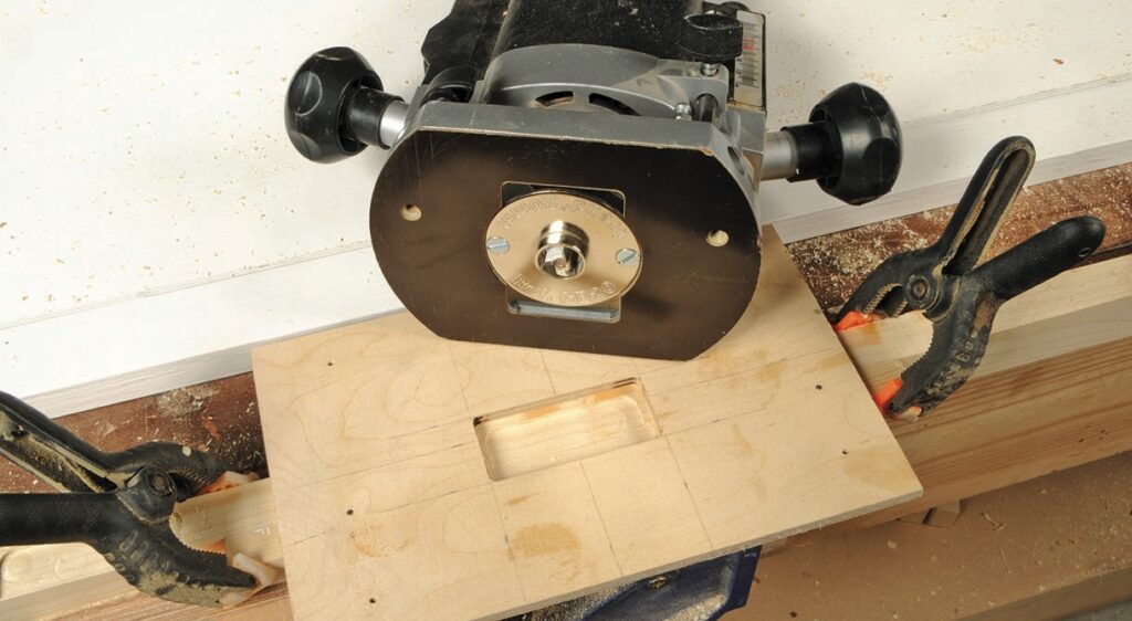

Do a test cut first.It will be quite shallow but a very consistent depth of cut. Note the clamps used to hold the jig in the chosen position

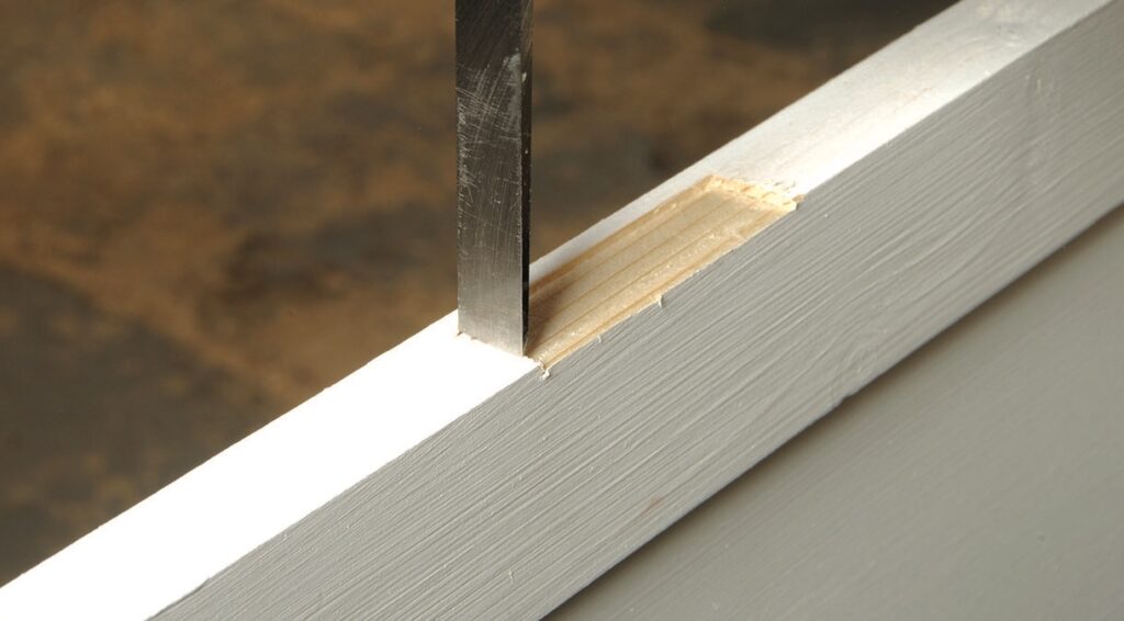

Use a sharp chisel to square out the corners of the recess if it doesn’t go right across door width. Clean the base of the recess with the chisel in the corners and try a hinge for fit. If it isn’t quite right you may need to adjust the jig or move the fence fractionally.
Now you can proceed to make all your hinge cutouts, which becomes a quick and easy process. In a piece of furniture your jig may limit how close to the top or bottom of a door opening you can place the router. If you are working on a larger scale with room doors you will either need to move the fence across to accommodate the thickness of the architrave bearing in mind it probably will be an awkward moulded shape, or remove the architrave for the duration of machining, which may not be as bad as it sounds if it is just held with a few nails.
Chisel creating mortise in wooden surface
The last act is squaring out the recess with a sharp chisel and testing the fit of the hinge. The jig can be adjusted but it may be enough to use the chisel to finish the job
