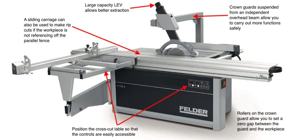

Annotated Felder sliding table saw with safety features

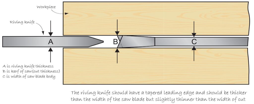

Riving knives, what are they and what are they good for?

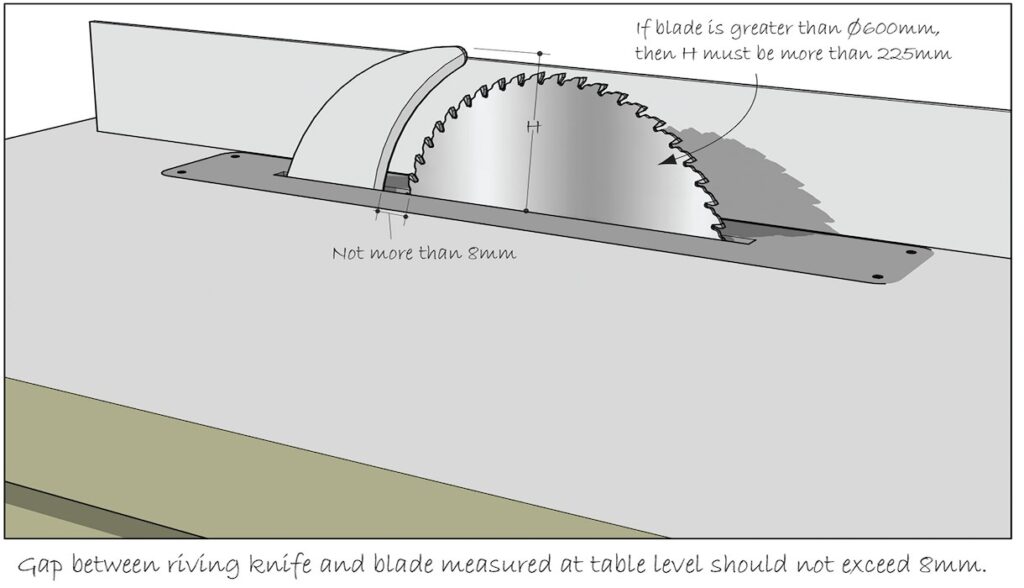

The riving knife is that crescent-shaped piece of metal that’s attached to the machine below the surface of the table directly behind the blade. The curve may not be identical to that of the blade and it may feature holes designed to accept a top-mounted guard. The purpose of the knife is to prevent material from closing in on the blade after it has been cut as it passes beyond the back of the blade. The blade at this point is rising up towards the material and when combined with a slowing down of the blade is one of the causes of kickback. Kickback is the term used to describe what happens when a piece of material is suddenly ejected from the path of the blade often without prior warning and sometimes with devastating results. A riving knife needs to be thicker than the plate of the saw blade but thinner than the kerf. The kerf being the thickness of the cut which is determined by the combined offset of the teeth. The HSE don’t recommend an optimum measurement on their worksheet for the difference in thickness between knife, kerf and saw plate but do have guidelines for setting the gap between the front edge of the knife and the back of the saw blade. At table level the optimum gap should be no more than 8mm.
A riving knife needs to be set in line with the blade, which is why they are fitted to the saw arbor on tilt arbor saws. As the blade is tilted the knife follows. On fixed arbor saws the knife can be mounted differently, these are often referred to as splitters and depending on where you come from the names are interchangeable.
Table saw blade clearance and riving knife diagram
Diagram comparing riving knife, saw kerf and blade widths

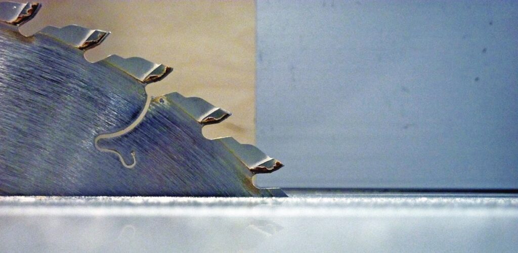

Saw blades in general
In much the same way that a hand saw filed with a rip tooth pattern can be used to make a cross cut, it won’t do it very efficiently. You’ll get breakout on nearly every edge and the cut surface will be rough. Circular saw blades are no different so you need to select a blade that’s suitable for the task at hand. Some coated sheet materials do respond better to specific tooth geometry but as the choice is too vast to cover in this article, a general-purpose blade plus a dedicated rip is a good place to start. These will cope with the majority of sheet material and solid timber.
The diameter of the blade is also an important factor in determining safe practice. Manufacturers will provide information about the smallest diameter blade that can be used on the machine and this should be clearly marked on the machine or the blade cabinet so operatives are aware of the limits. Smaller blades have a low peripheral blade speed and under strain are more likely to stall and result in kickback. Generally it’s not physically possible to fit a blade that’s too big for the machine but again highlighting this information where operatives can see it is an excellent idea.

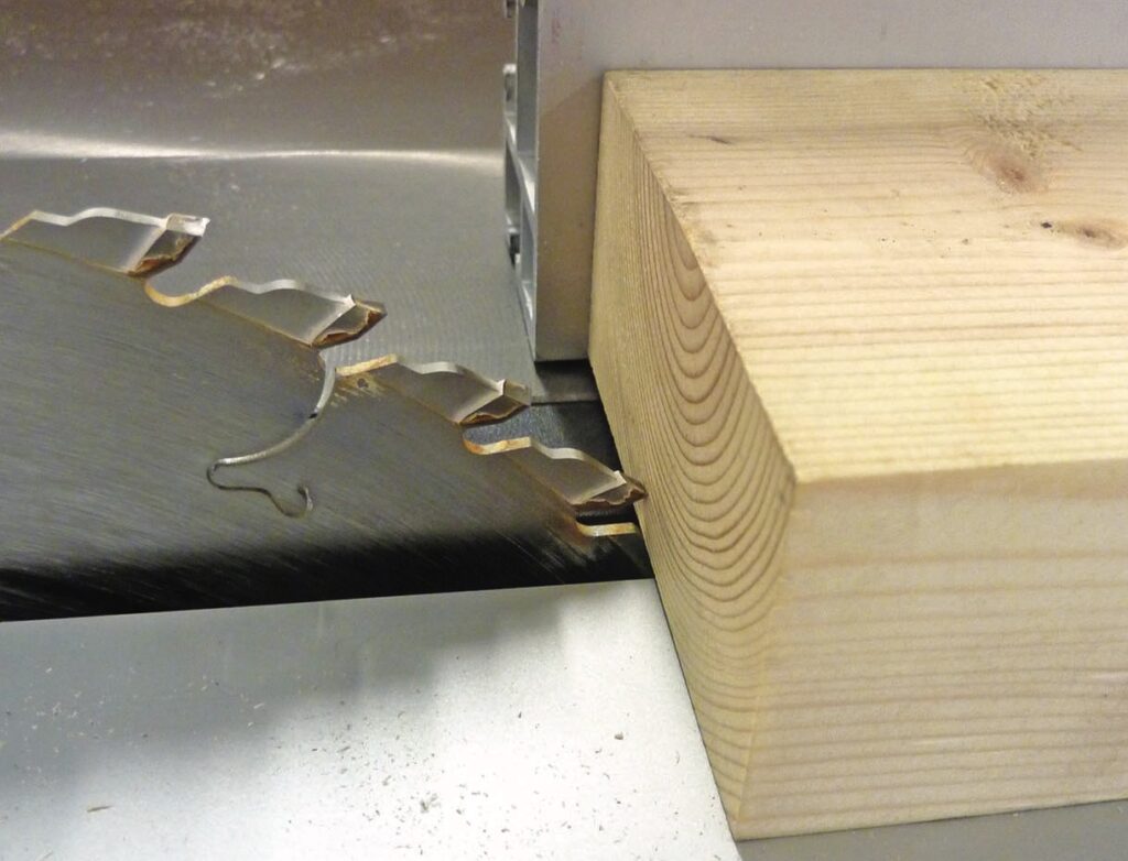

Ripping
Ripping is the term most often used to describe a cut along the length of the workpiece. It is also used to describe a cut that runs with or in close proximity to the direction of the grain on solid timber. There are a number of ways in which you can carry out a rip cut on a circular saw. Running the workpiece against a parallel fence is the most common method for both sheet material and solid timber. On saws that feature a sliding carriage it may be possible to use a jam stop to secure the workpiece to the carriage and complete the cut without the use of a parallel fence. It is not recommended to use both. There can be tension in dry seasoned wood as well as unseasoned timber causing it to open up further than the width of the kerf behind the blade directly after the cut. To allow the material to expand freely the fence needs to be adjusted accordingly so that it doesn’t force the material back into the path of the blade. The correct setup should be to slide the fence forward towards the operator so that the back edge of the fence is in line with the bottom of the gullet at table height at the front of the blade.

As this magazine is read on several continents, with often different opinions regarding the safe use of saws, it’s impossible to give a definitive guide to what is required by law in your region regarding guards. Guards come in various shapes and sizes and some allow you to perform some processes more efficiently than others.

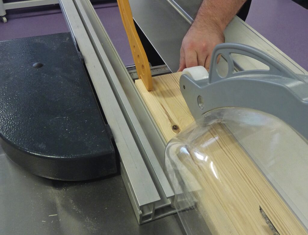

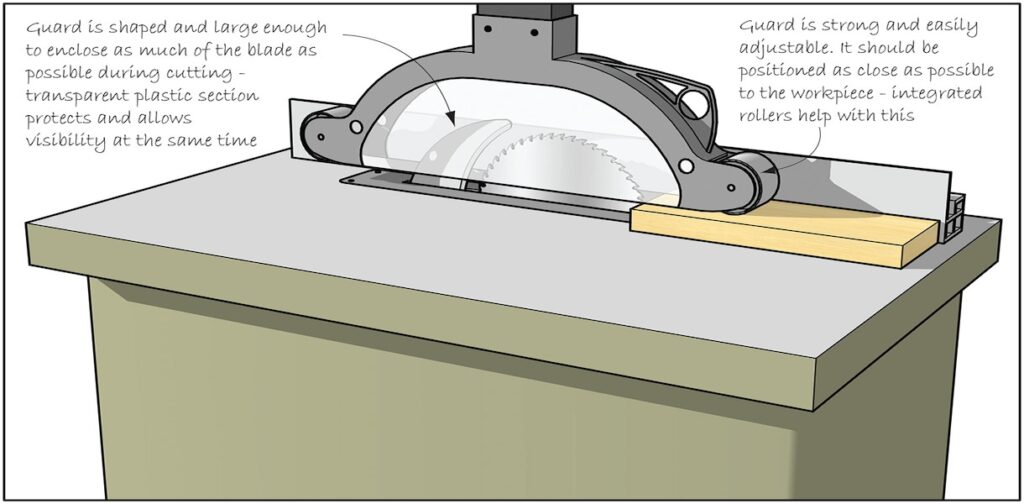

By far the most common type of guard found on a tablesaw will be the crown or top guard. It is designed to prevent access to the blade by creating a physical barrier between the operator and the blade. For crown guards to be effective it’s important to have them set up and adjusted for the type of cut you are about to perform. The correct setup is to have the guard as close to the workpiece as possible without interfering with it. Some guards feature rollers at the front and back that allow the guard to be lowered directly on top of the workpiece thus creating a zero gap between both items while the cut is being made.
Crown guards also perform another very important function as one of the local exhaust ventilation (LEV) features of the machine. The closer it is placed to the workpiece the more effective the extraction.

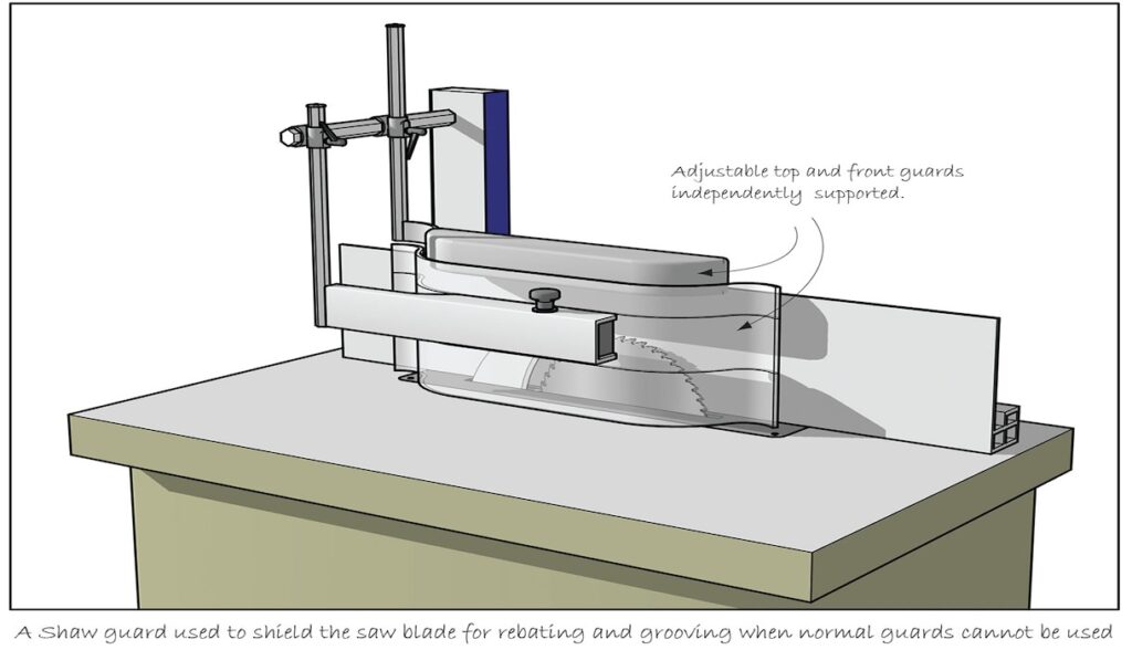

Shaw guards are another acceptable means of guard but do not cater for dust extraction. They are designed with sprung pressure pads that not only prevent access to the blade but also support the workpiece. They operate like a tunnel completely covering the blade from the side and top and are one option that means you can cut rebates and grooves safely on a tablesaw.
Illustration of guarded table saw cutting a wooden board
Adjustable shaw guard shielding a circular saw blade

Having the fence set in the low position will often improve extraction

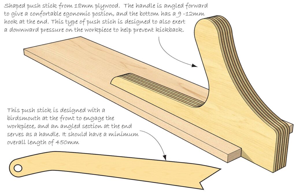

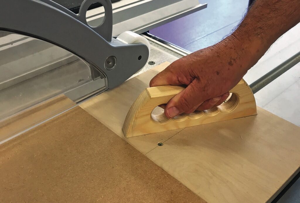

Stand up for push sticks
Illustrated plywood push-stick designs for safe woodworking
