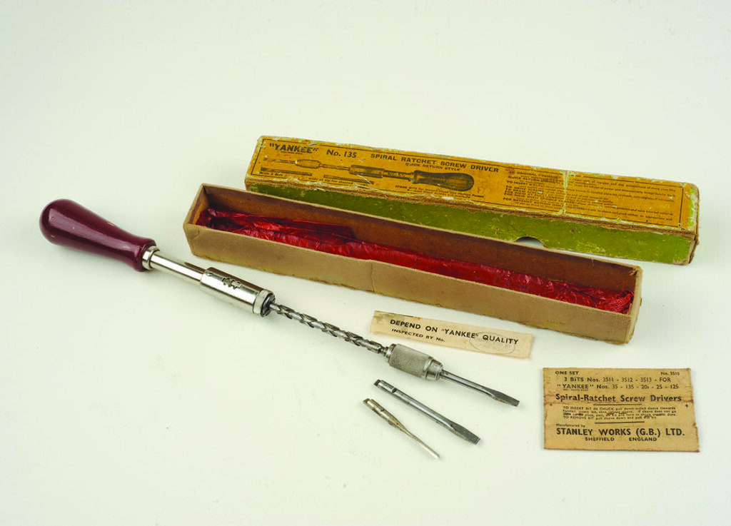

A collectable 1950s 135A complete with bits, box and inspection note and still very useable. Kindly loaned by TATHS. www.taths.org.uk
It may seem odd to include a hand tool that Stanley only retired in 2007 of which there are still several other makes available today in our ‘Tool Collecting’ series. However, the ubiquitous piece of kit first appeared in 1898 produced by North Brothers Mfg, Co. Philadelphia; the company was then only sold to Stanley Tools in 1946. With Stanley’s worldwide appeal and marketing power it was inevitable that this tool would be synonymous with the Stanley ‘Yankee’ brand and appear in every tradesman’s toolkit only to be supplanted late in the day by the now universal cordless drill.

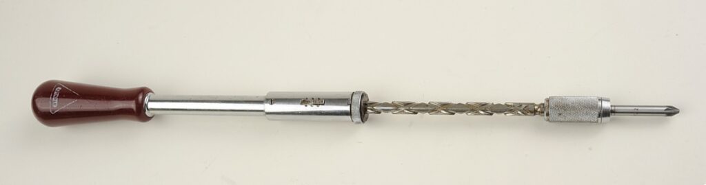

So what can it do? The clue is in the name; it is a screwdriver with a difference. The long driver bits lock into the chuck by pulling back the milled sleeve at the front and a selector button on the casing behind allows a forward or reverse ratchet action with a fixed middle position. The ratchet action allows quick driving in or out; however, the real trick is found by turning the milled collar behind the chuck. Instantly the criss-cross machined shaft springs out and you can then drive screws in or out under strong spring pressure. This pump action takes away a lot of effort and speeds up screwdriving tremendously. You can also fit shell-type drill bits to drill pilot holes with equal facility.

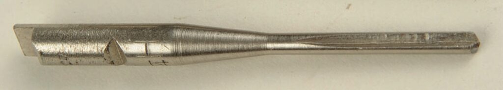

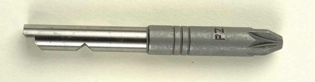

A brand new Pozi No.2 bit – note the Stanley step and notch fitment at the end; this one fits the 130 series Yankee

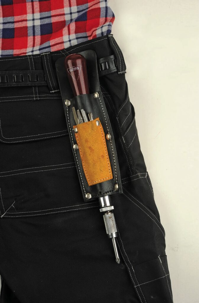

You can even buy a holster for a Yankee and driver bits for ‘go anywhere’ screwdriving

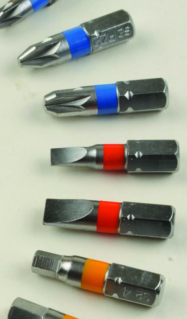

Once you buy a bit adaptor of the right size you can fit any standard modern hex shank driver bit
