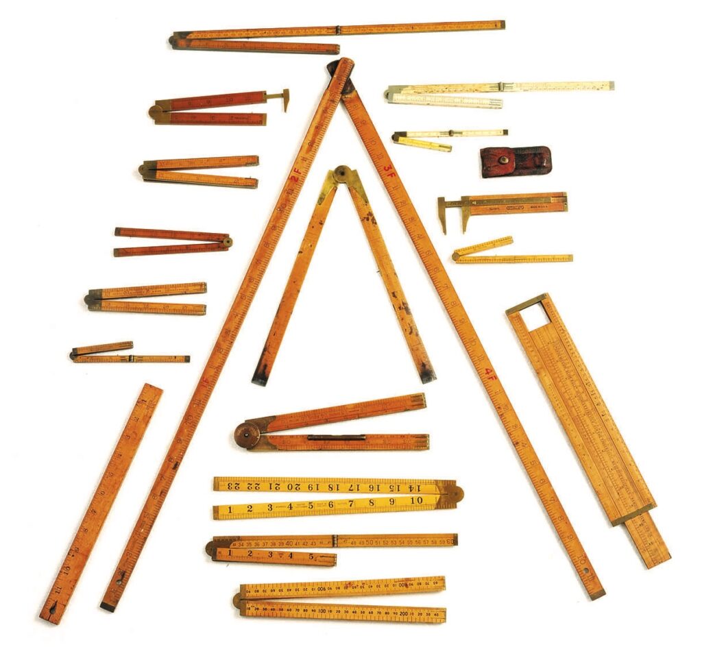

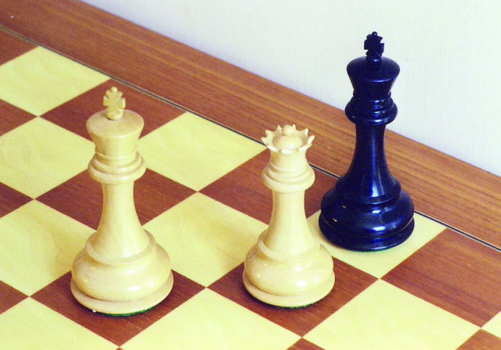

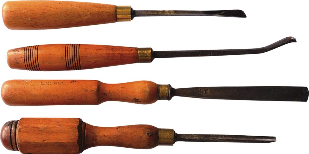

Box is favoured for wood engraving and in the past for making printer’s type, scale rulers, also violin pegs and woodwind instruments. It has frequently been used as stringing on the edges of antique furniture and for chess pieces, either natural for the white pieces or dyed black as a sort of false ebony.

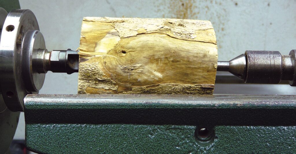

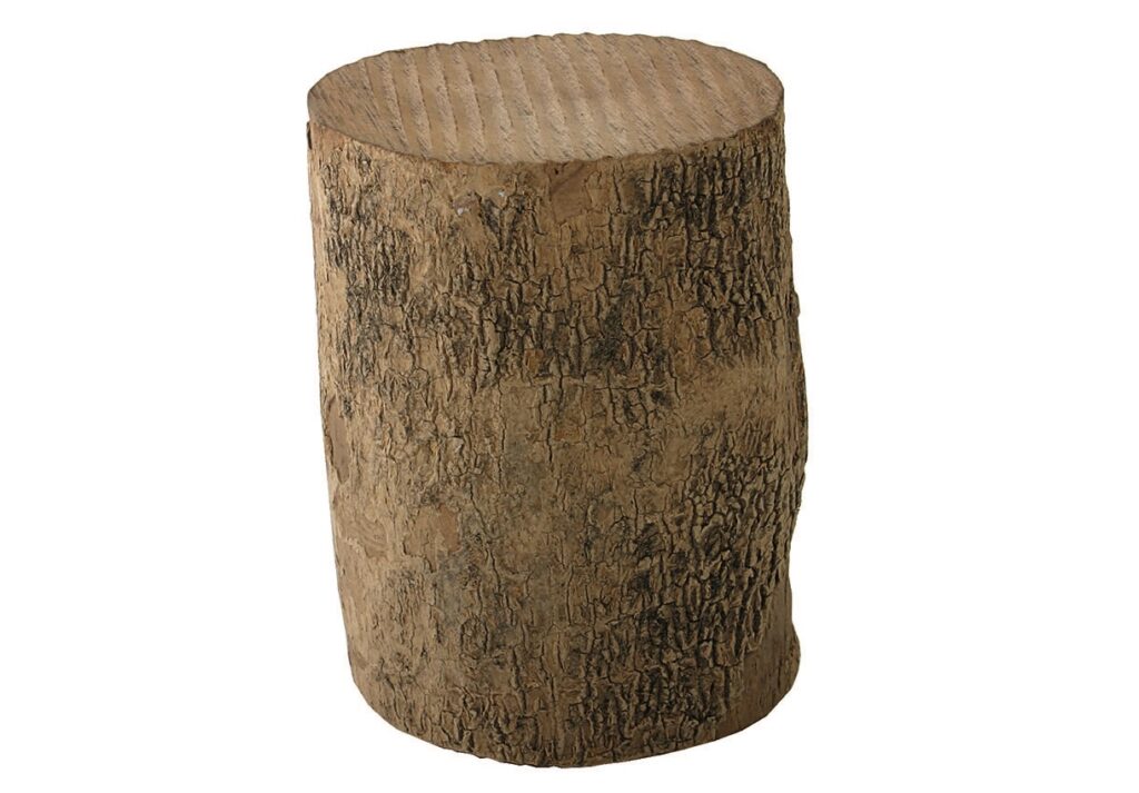

It is rare to find box felled; you need to buy it from a specialist timber supplier. Because the sections can be quite small, conversion needs to be carefully done to avoid waste. Fortunately it is straight grained with small tight knots so it is reliable however it is cut. It needs slow seasoning and the ends of logs to be coated while drying but it is very stable once dried.
Working characteristics

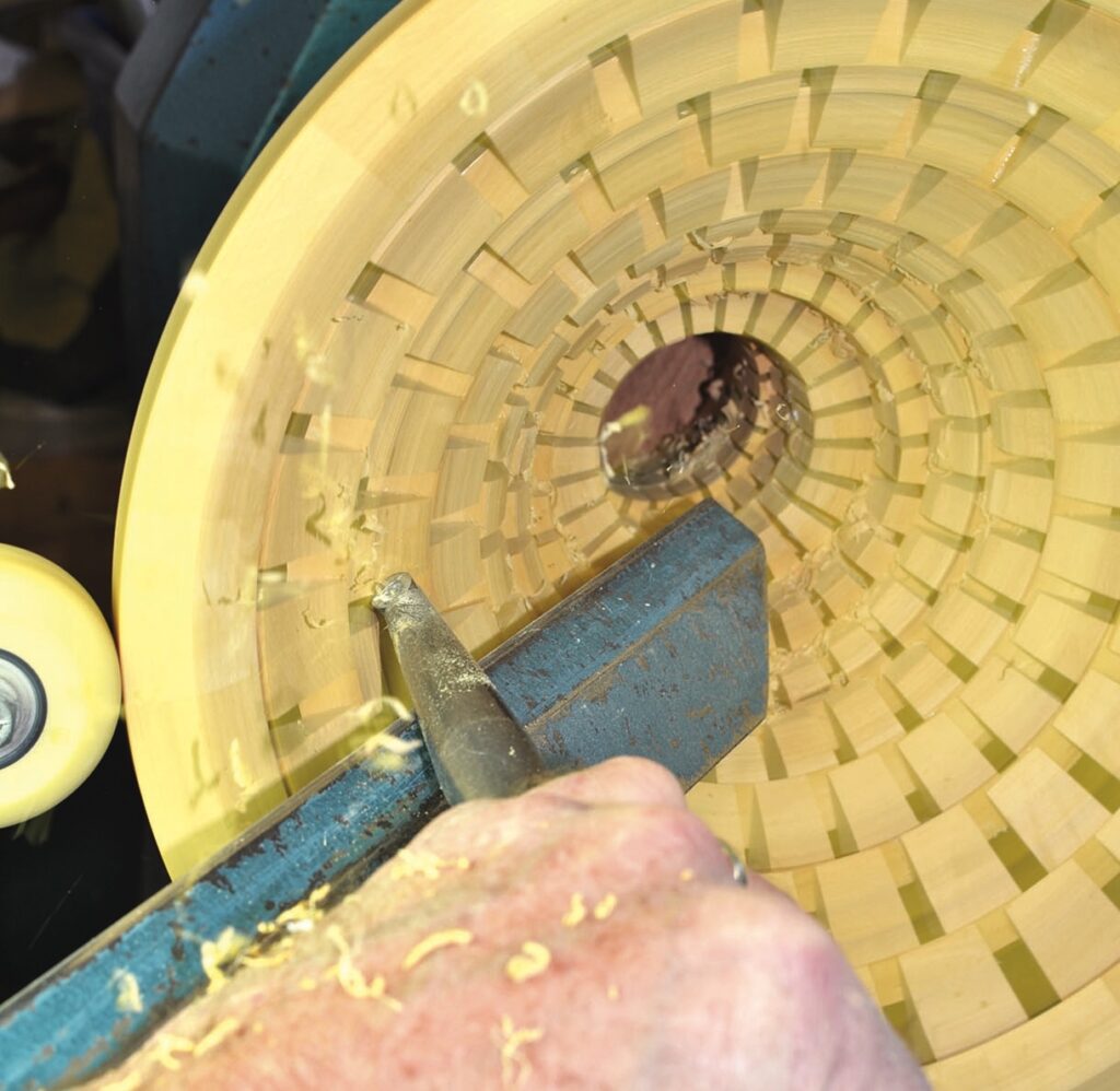

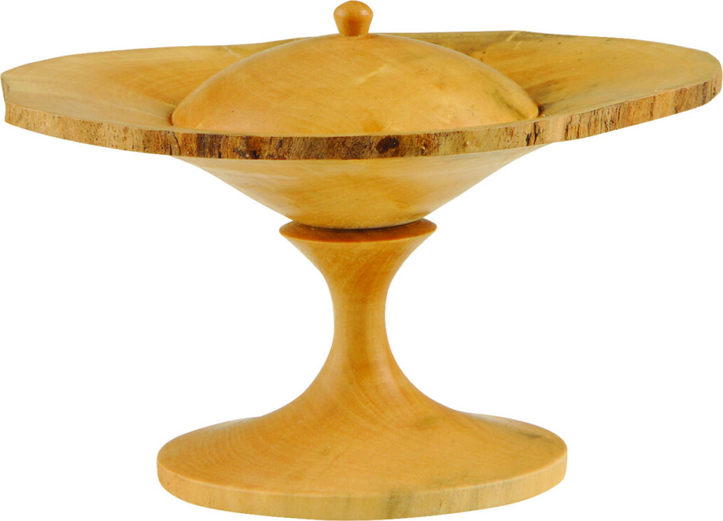

It is a dense timber with a moderate blunting effect on cutting and is not very easy to plane. It does turn quite well but pre-drilling for screws etc is essential. It also glues satisfactorily, it accepts stains and polishes well, when carved or turned.
