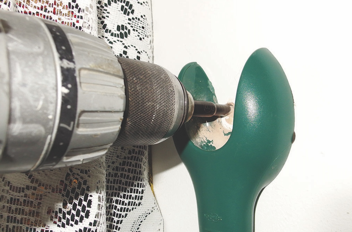

Drilling into masonary
An 18 volt drill with hammer action is favourite for masonry drilling. An SDS chuck will hold bits firmly and do use extraction as shown here

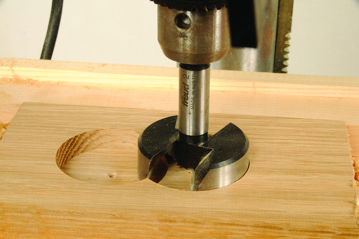

Drilling a hole with a forstner bit
Forstner bits can cut overlapping holes easily due to the cutting action and centre point

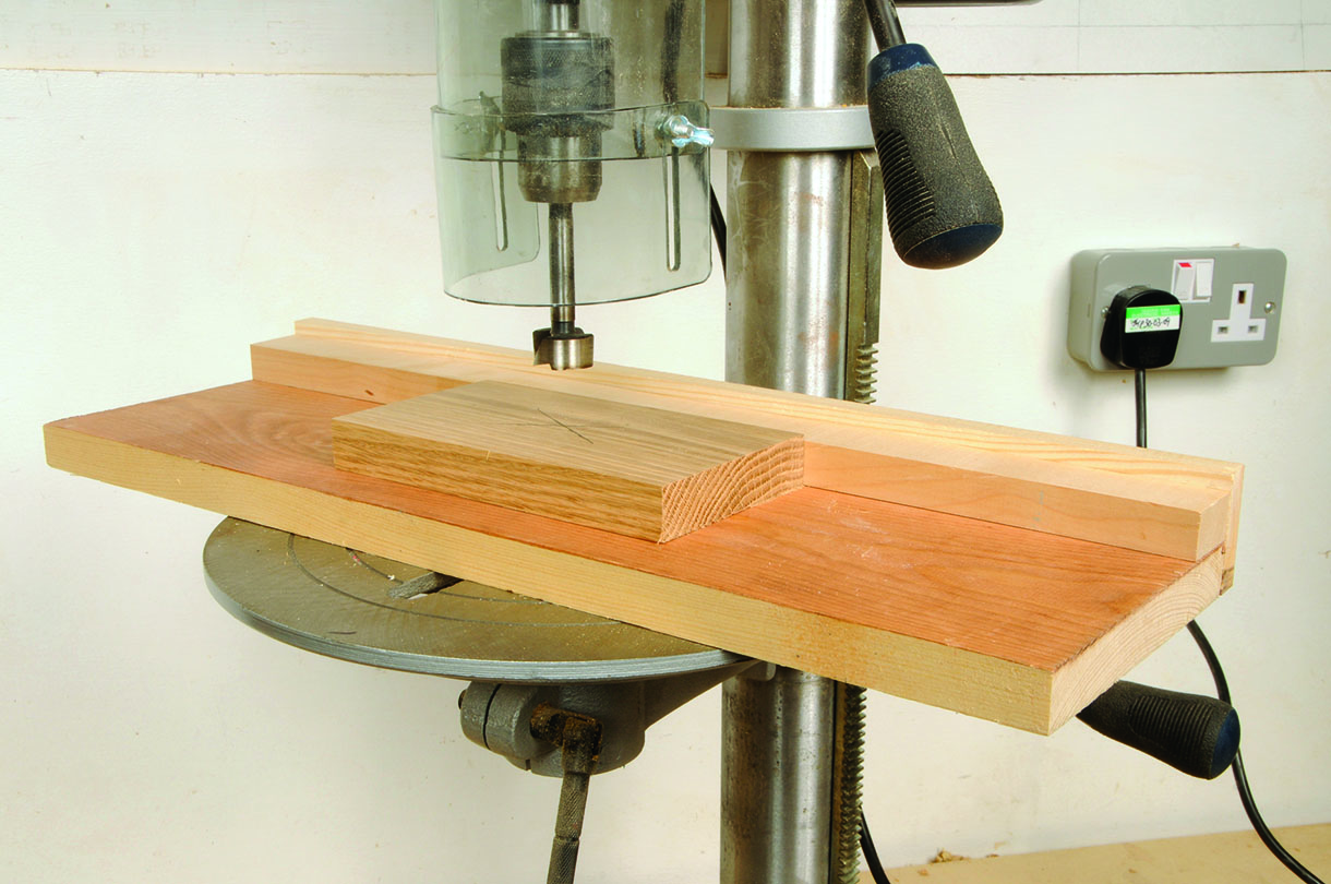

6. When using a pillar drill use an engineers vice to hold metal or small wood components. If necessary bolt it down to stop it turning around, you can mount it on a long board and clamp it at either side of the drilling table. For larger components, a proper wooden sub-bed and fence will not only make drilling safer, it will give repeatable results as the workpieces can sit against the fence each time.
A long piece of wood on a plunge drill
A wooden sub-bed and fence for safe accurate drilling, a stop block can be added for repetition drilling

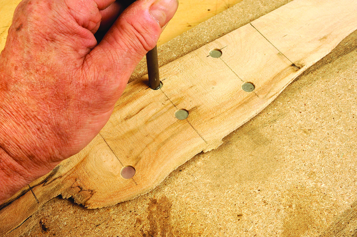

9. Some jobs need exact drill sizes, for example letting in door catches or rare earth magnets for use as closers or drilling metal prior to creating a screw thread using a tap and die set. Make sure you have the correct sizes in stock, if necessary buy from a specialist supplier if you need a non-standard diameter drill, e.g. imperial instead of metric for example. A set of Vernier callipers is essential for checking actual diameters.
Magnets in a piece of wood
These knife rack holes needed to be an exact fit for the rare earth magnets
