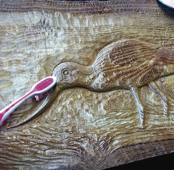

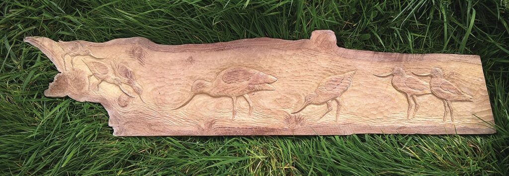

Zoe Gertner shows how to carve a colony of these birds in relief
Every so often I sort out my store of carving wood, which reminds me of what there is waiting to be carved and sometimes gives me ideas for new carvings. Looking through my stock of randomly shaped boards, my false acacia (Robinia pseudoacacia) planks consist of some with bark still attached, plenty with burrs, knots and areas of wild grain pattern, and various flaws. Though they have great potential, these boards will be challenging to work. But some of the grain patterns could suggest flowing water, perhaps?
Leading on to water birds, perhaps? Distinctively shaped waders? Maybe avocets with their upcurving beaks, curlews, herons or egrets. The boards could be tricky to carve, but well worth the challenge in the end, and it’s surprising how pleasing an eccentrically shaped relief carving can be.

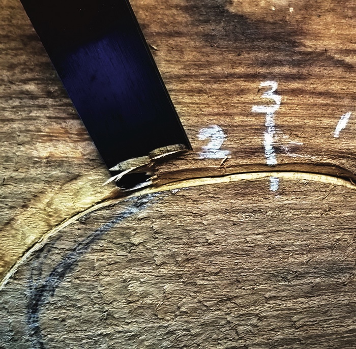

Tools:
• Mallet
• No.39, 3 & 6mm V-tool
• No.3, 3-19mm
• No.5, 10-13mm
• No.9, 6mm
