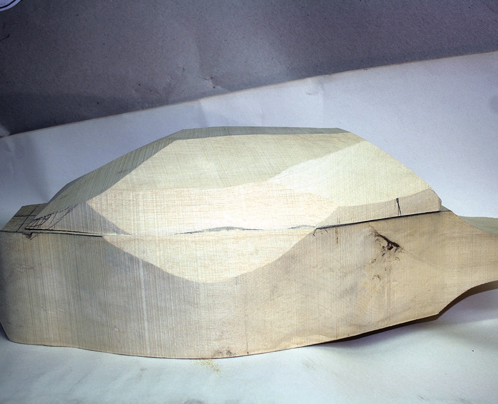

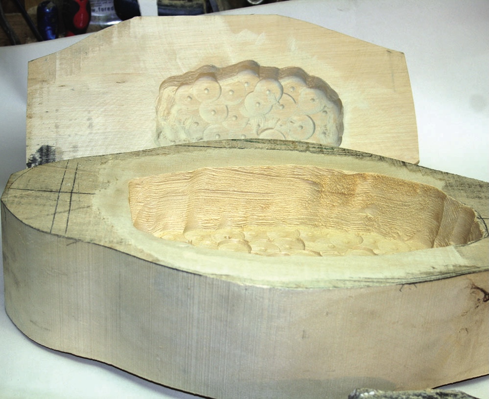

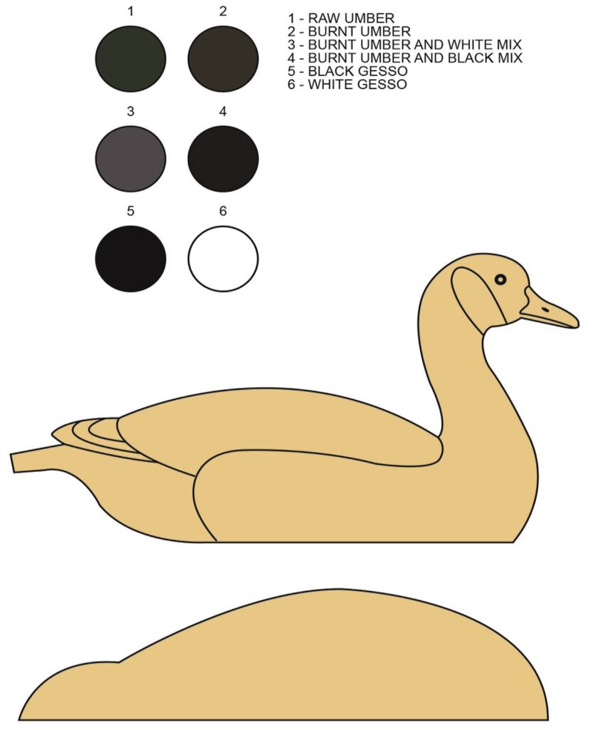

1. The Canada goose is a large bird and you will have to decide how big you are going to make it. Given that the goose can reach 1.5m or so in length this can be a large project. So, like I did, you might consider making a scaled-down version rather than a full-sized one. Photocopy and scale up the drawings provided as you please. Even at the sizes I used, there was still a lot of wood required so, to save cost and because it was a necessity regarding timber sizes available commercially, I needed to laminate two pieces together for the main body. I cut two sections of wood and rough-shaped them on a saw to reduce weight, I hollowed out the inside using a drill and 25mm drill bit to remove some waste and then used a rotary carving disc and sander to refine the internal form
2. Since I laminated the timber I needed to glue it together. Whether you’re working with a solid piece or laminated body section, you need to have a rough-shaped body section ready to move on to working on the head and neck section

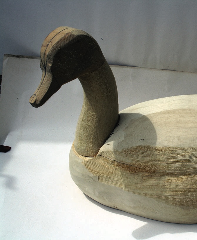

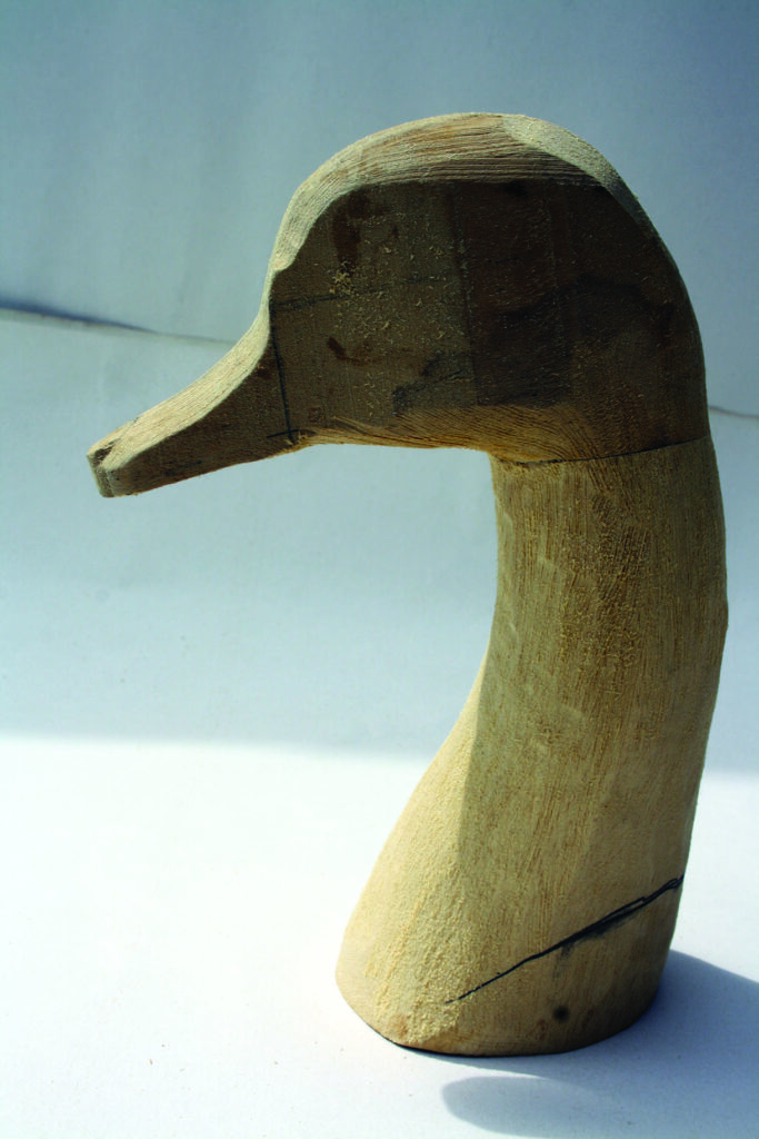

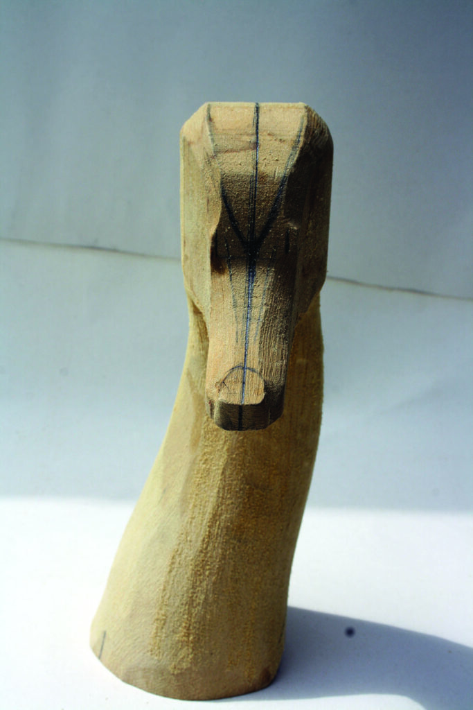

3. For strength, the head is created from two sections of wood. These are shown clearly in the picture. Once the wood sections are glued together, use power or hand carving to roughly shape the relevant main shapes. I typically use power-carving techniques on my work, which entail a combination of rotary burrs and sanding bobbins. But of course, you can hand carve it too – it just takes a little longer, but you don’t have to deal appropriately with dust, noise and the like from power carving
4. Here is a view of the head and neck from the front
5. When ready, adjust the body to allow you to temporarily fit the head and neck to the main body. Adjust as needed to get the position you require

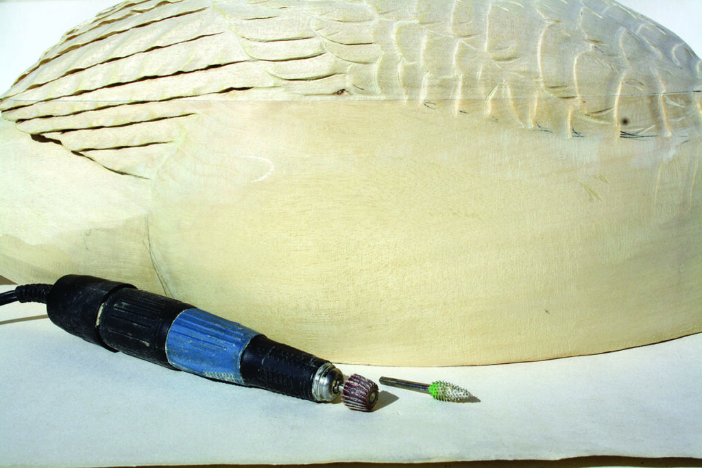

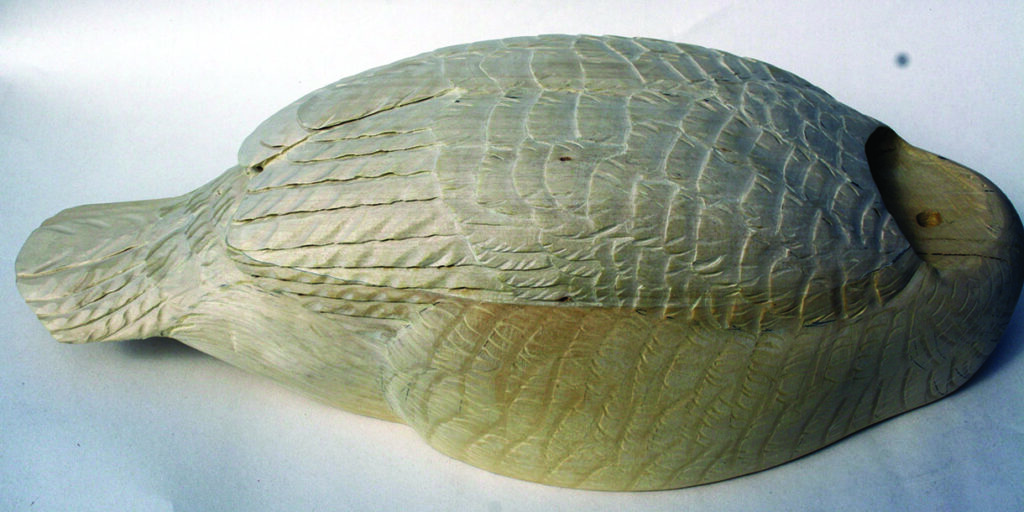

6. Draw in all the feather details on the back then carve them in place. I use a detail burr and a sanding drum/flap to shape the feathers7. Now draw in the side feathers and carve those in place. Note also that above the tail at the end of the wing feathers there are two slots cut into the timber. These are to accept the primaries later on. It saves time and timber to have these as separate pieces

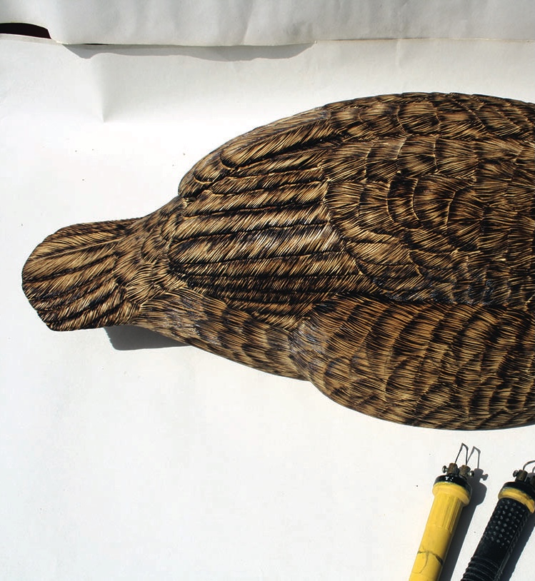

8. Once the feather positions are carved fully create the detail using a scalpel-edged pyrography nib
9. Continue this process over the whole body, keeping a close eye on the positions and detail required. Check your reference material closely to make sure you are getting it right

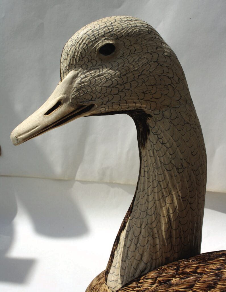

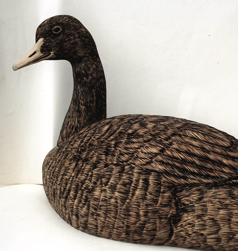

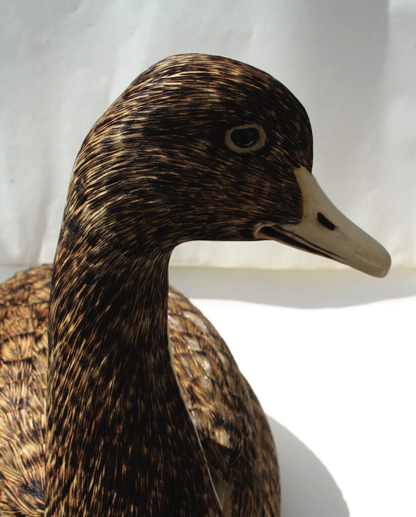

10. Once the body is done, move on to the neck and head. Cut two eye socket holes in the right positions and then insert either bought or made eyes into the socket, bedding them into plastic wood. Once pressed in place, shape the squeeze out then mark the feather positions and use a pyrography unit to create the detail
11. Here is the neck and head temporarily fixed to the body with the pyrography detail all in place

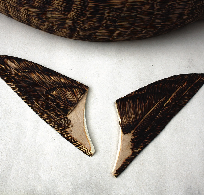

12. It is now necessary to create the primaries. Two pieces of wood are required for this. Due to these being delicate if made from lime or jelutong, I use 3mm ply. It is cheap and can be easily shaped and detailed. Once finished, fix them in place

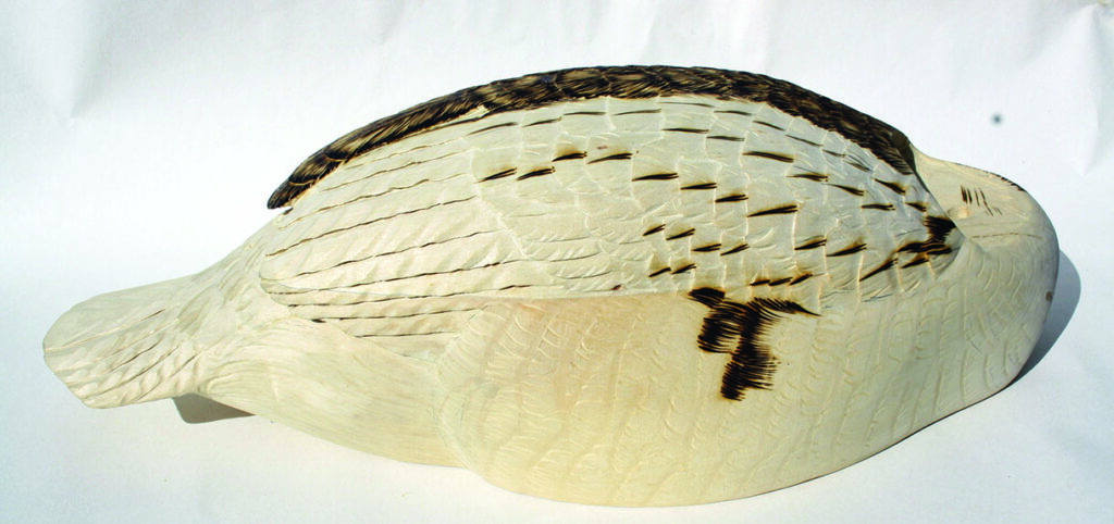

15. Use a mixture of burnt umber and raw umber to create a thin wash. Once done and dry, add some white gesso to the mix and paint the sides

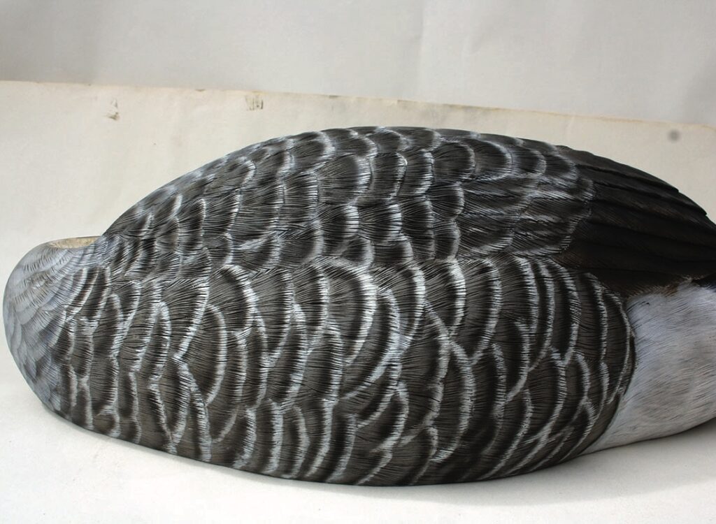

16. Now, using an airbrush or paintbrush – I am using an airbrush – edge all of the wing and side feathers with white. You can now see how the look is developing nicely
Top Tip
The carving, pyrography and colouring of the feathers is a necessary process for creating realistic birds. Practice these techniques on waste timber before committing to using them on your final bird. None of the processes are tricky, it just takes a little time to learn how to bring everything together well.

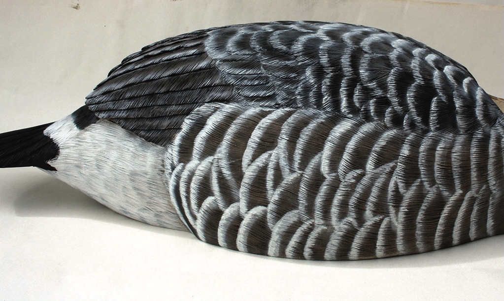

17. Once done, dry brush the edges of the feathers with white

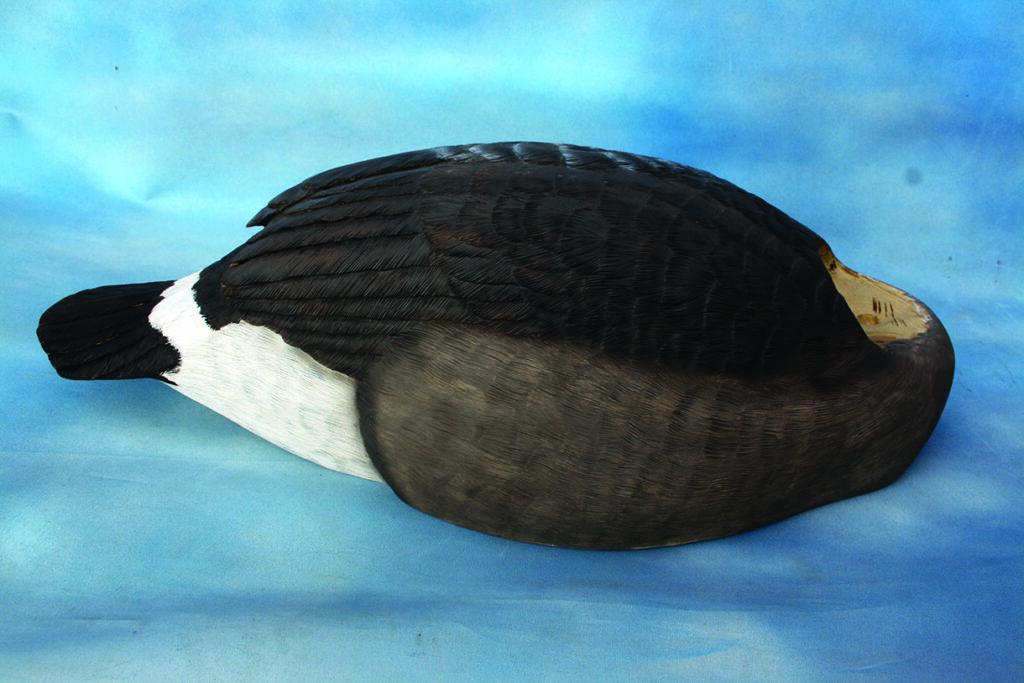

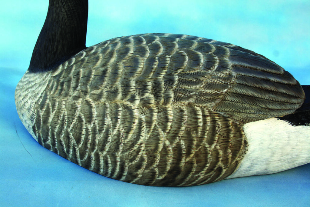

18. Now, using a mixture of black and burnt umber, airbrush the dark markings. This can be done with a brush if needed
19. Coat the body with very thin washes of burnt umber

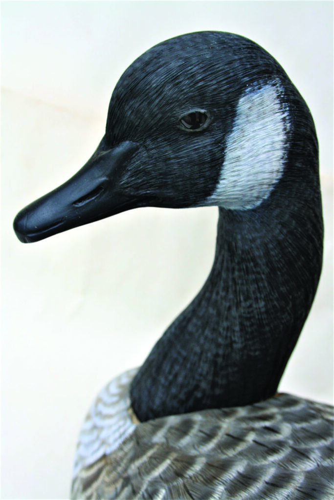

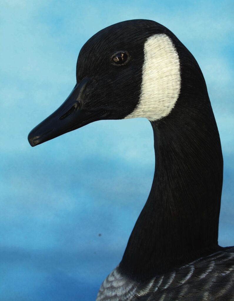

20. It is now time to paint the head and neck with white and black gesso as required

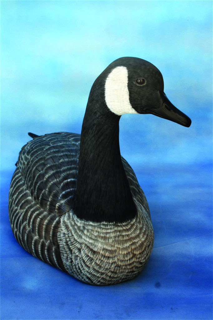

21. Edge the head and neck feathers with a mixture of light grey

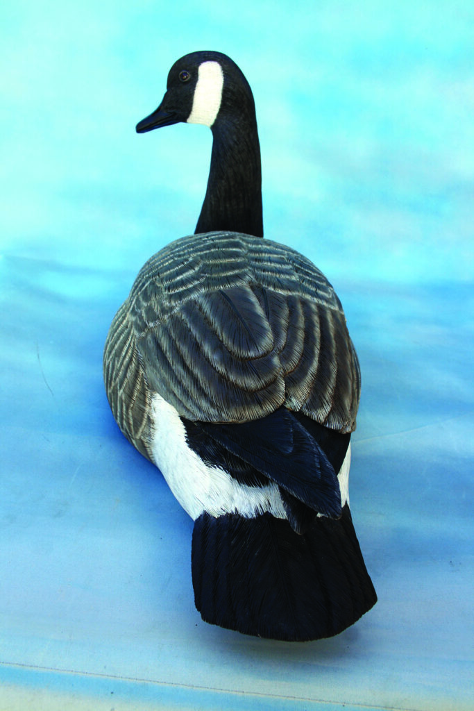

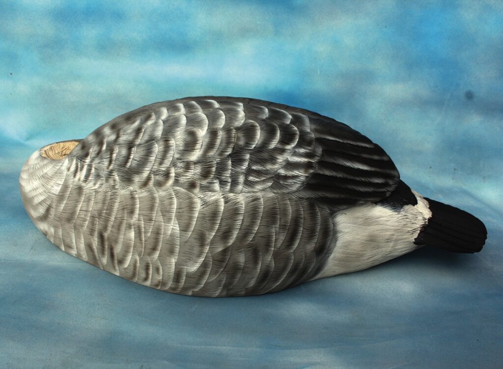

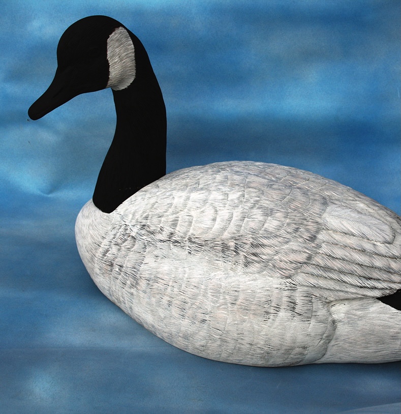

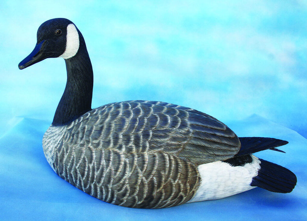

22 &… Here are a few other views of the finished bird
