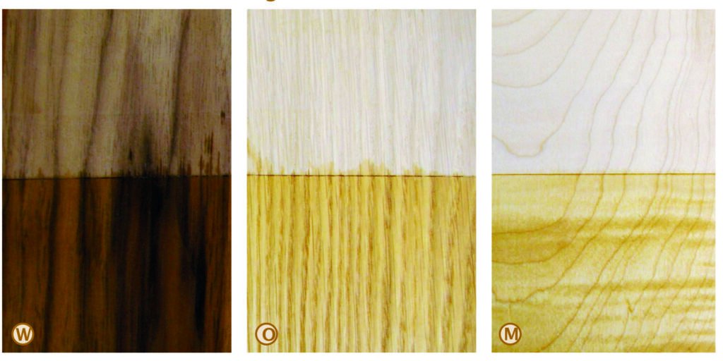

Hardwax: Osmo PolyX Oil
Walnut, Oak, Maple trees with scientific names.
Three types of wood finishes comparison
James Billings: Quite thick and sticky to apply with a bit of drag when brushing. Still wet at 50 mins. Osmo has the lowest odour but was the only one still sticky at four hrs.
Tom Buttler: This oil is thicker in viscosity than the other two oils. It’s more opaque in colour and takes longer to dry. Once dry, it gives a nice satin finish which is very durable and easy to repair by re-coating.

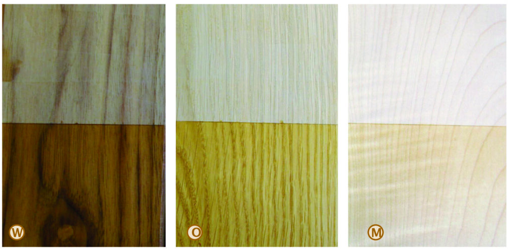

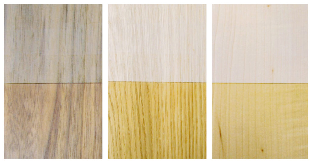

Hardwax: Treatex Hardwax Oil
Comparison of three wood grain textures.
James Billings: Again, this was quite thick and sticky to apply with a bit of drag when brushing and was also still wet at 50 mins.
Tom Buttler: This has a nice colour and viscosity and is easy to apply. I found that it lifted the grain on the first coat but dried smooth on the second coat. Once dry, it gives a matt finish which shows up marks that are easy to repair by re-coating.

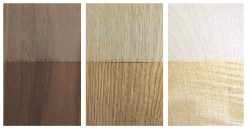

Danish: Chestnut Finishing Oil
Three types of wood with different shades.
James Billings: This was the thinnest so soaked in quickly, but it was prone to running.
Tom Buttler: A very thin oil and when applied lifts the grain on both coats and would probably need more than two coats to achieve a good finish. Gives a satin finish which does not mark easily.

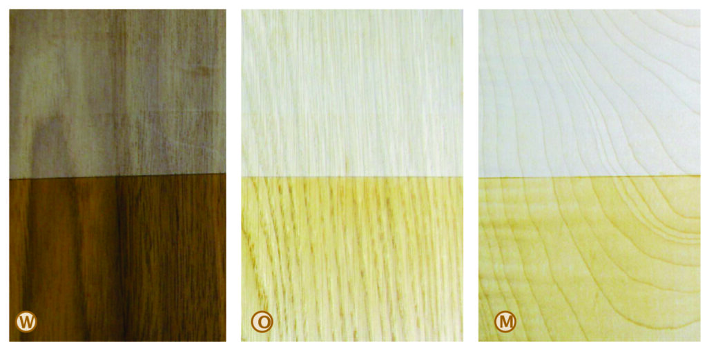

Danish: Mylands Danish Oil
Three types of wood grain samples compared
James Billings: This had less open time than the others. The second coat was touch dry in five hrs while the others were still sticky.
Tom Buttler: Thicker than the Chestnut Finishing and Liberon Superior Oils, Mylands gives a nice satin finish which does not mark easily.

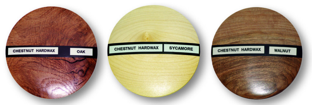

Hardwax: Chestnut Hardwax Oil
Chestnut hardwax on oak, sycamore, walnut samples
Paul Hannaby: This comes in a screw top tin rather than the flip off paint tin used by the other two hardwax oils, so for occasional use of small amounts, this would be more convenient. Again, all three samples appeared to be unaffected by either liquid in the spill test.
Keith Fenton: Unlike the other finishes, I applied this with a cloth as the instructions indicated. I applied it liberally and the surplus wiped off almost immediately. This was by far the thinnest in consistency of the three products tested and was absorbed into the wood quickly. There was a noticeable odour. Two coats gave a nice satin finish. This was the hardest finish of the samples to scratch.

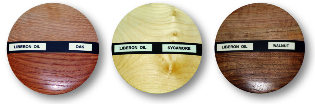

Danish: Liberon Superior Danish Oil
Three wood samples with Liberon oil labels.
Paul Hannaby: This showed slight yellowing on the maple in comparison to the other oils. In the spill test the maple sample lost its shine where the wine was applied but not where the coffee was. The walnut sample appeared to be unaffected by either liquid. The oak sample appeared to lose its shine where the coffee was applied but not where the wine was. None of the samples exhibited any staining.
Keith Fenton: My first impression was of the very thin consistency of the oil. It was absorbed the fastest of the products tested and took a good amount to obtain coverage, particularly on the end grain of the samples. There was a marked change in the colour of the oak as it became significantly darker.
