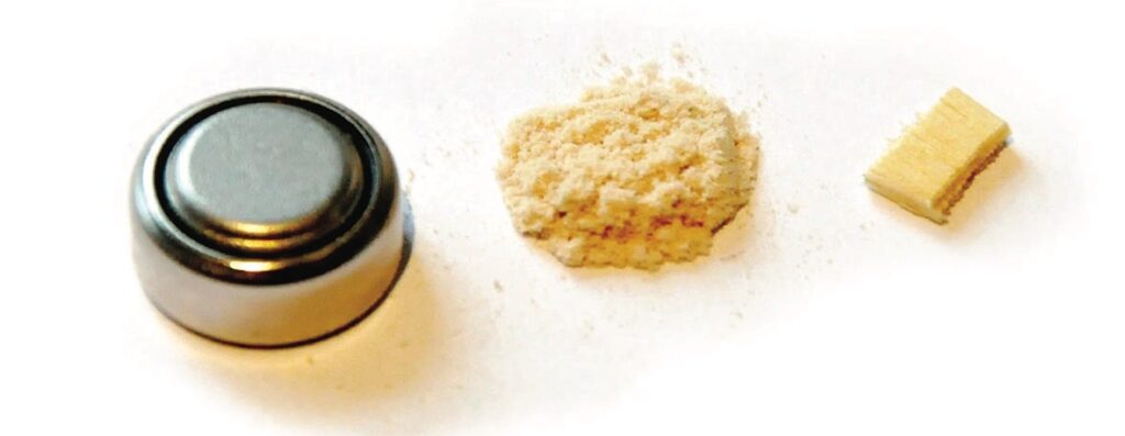

Size Matters – What does 5mg of dust look like?
The photo below shows 5mg of dust from beech (Fagus sylvatica) veneer. For comparison, we have a standard LR44 cell; the dust is about one-fifth or less its volume. On the right is a drink stir stick and a piece that represents 5mg of whatever wood that is. The pile of dust is bigger as it contains air. Now imagine that pile of dust equally distributed in a metre cube of air – not much, is it?
