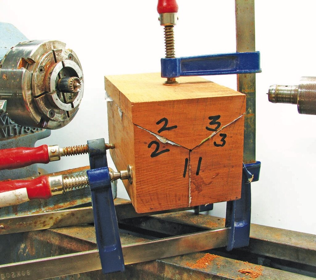

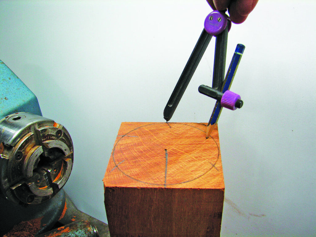

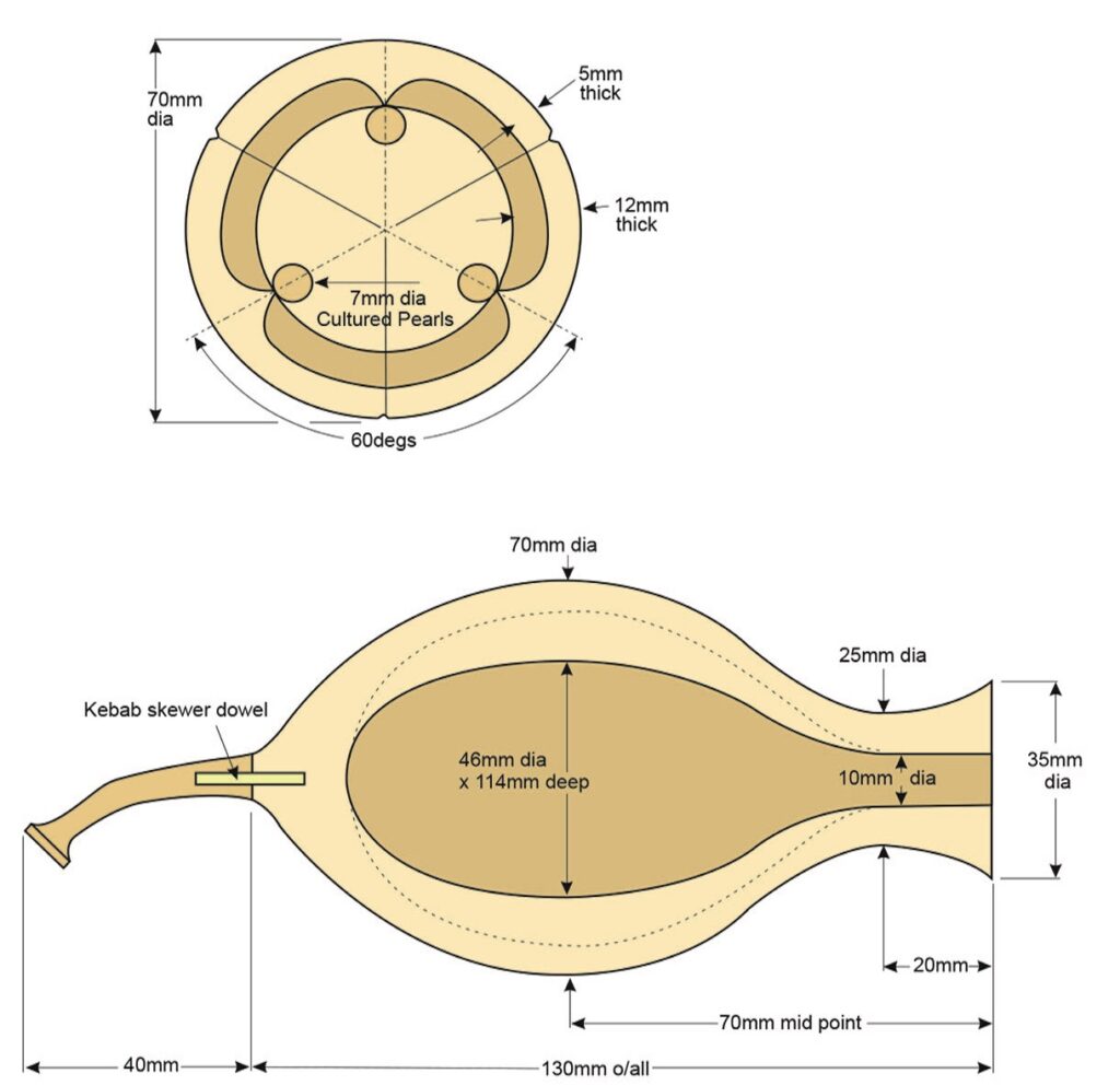

1. Select your wood to suit the finished size you have in mind. I used a piece 130mm x 70mm diameter. Because this piece consists of three sections, it needs to be marked out and cut. Use a pair of compasses to draw out the required diameter and draw a line to the centre point, squaring off the baseline. Keeping the compass on the same radius, bisect the circumference starting at the previously drawn line. You will find having gone round that you will arrive back exactly on the point where you started. Meanwhile, you have divided the piece into six equal portions from where it is easy to mark out the piece into three equal sections
Wood block clamped on metal lathe for turning.
2. To cut the blank into three use a compound drop saw. However, ‘many roads lead to Rome’, so if you are careful, a table or bandsaw will also do the job. A sanding disc on your lathe will clean up the cuts to give a perfect fit. Some wood glue on all the surfaces, a sheet of newspaper in between, three clamps to keep it all together, and hey presto. We’re nearly ready for some turning. Before you put chisel to wood I suggest you make a full-scale drawing of the item. You are then able to set your callipers to whatever section you are turning and transfer the exact measurements, and consequently the exact drawn shape. Incidentally, this is a good procedure for any piece you may wish to make. A full-scale drawing (even on a bit of cardboard) will allow you to get the most out of your costly blank

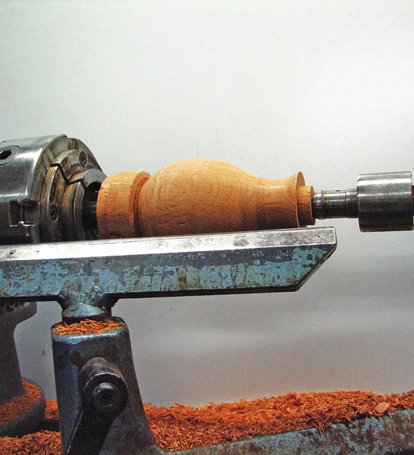

3. A paper glue joint needs to be treated with some respect, so be sure to take care during this step. The idea is to split the blank in three when we want to, but not before. Therefore, it is important to use a ring drive as well as a live ring centre when turning between centres – these hold the pieces together instead of wedging them apart and having them bounce off the wall. With the help of your full-scale plan, you are now ready to turn your shape. Turn a spigot on the base so you can hold the piece in your scroll chuck, and now you are ready for hollowing
Person using a lathe for woodturning.

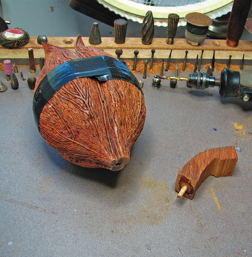

4. Not having any support at the opening end now means you will need to do something to stop the piece splitting apart like a ripe banana. A great tool here is duct tape, which helps ensure that the piece will not split during this process. Duct tape is strong yet has a certain amount of stretch – perfect for this task. Wrap the tape tightly around the neck. Next, drill a 10mm hole to the required hollowing depth. After this it is just a matter of peeling the wood off to the correct thickness – as per the plan you have previously drawn out. The hollowing tool used here was one of my own design and manufacture, with a high-speed steel (HSS) hook cutter on the business end, but a scraping tip will work as well

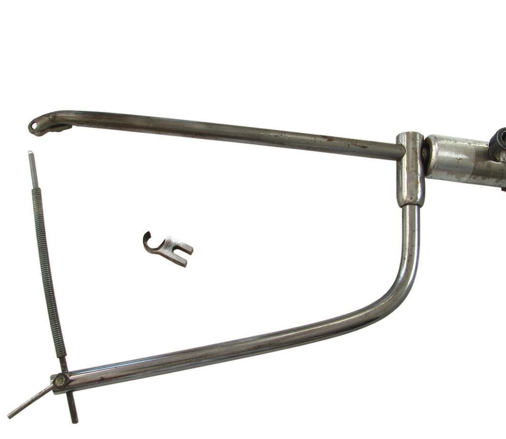

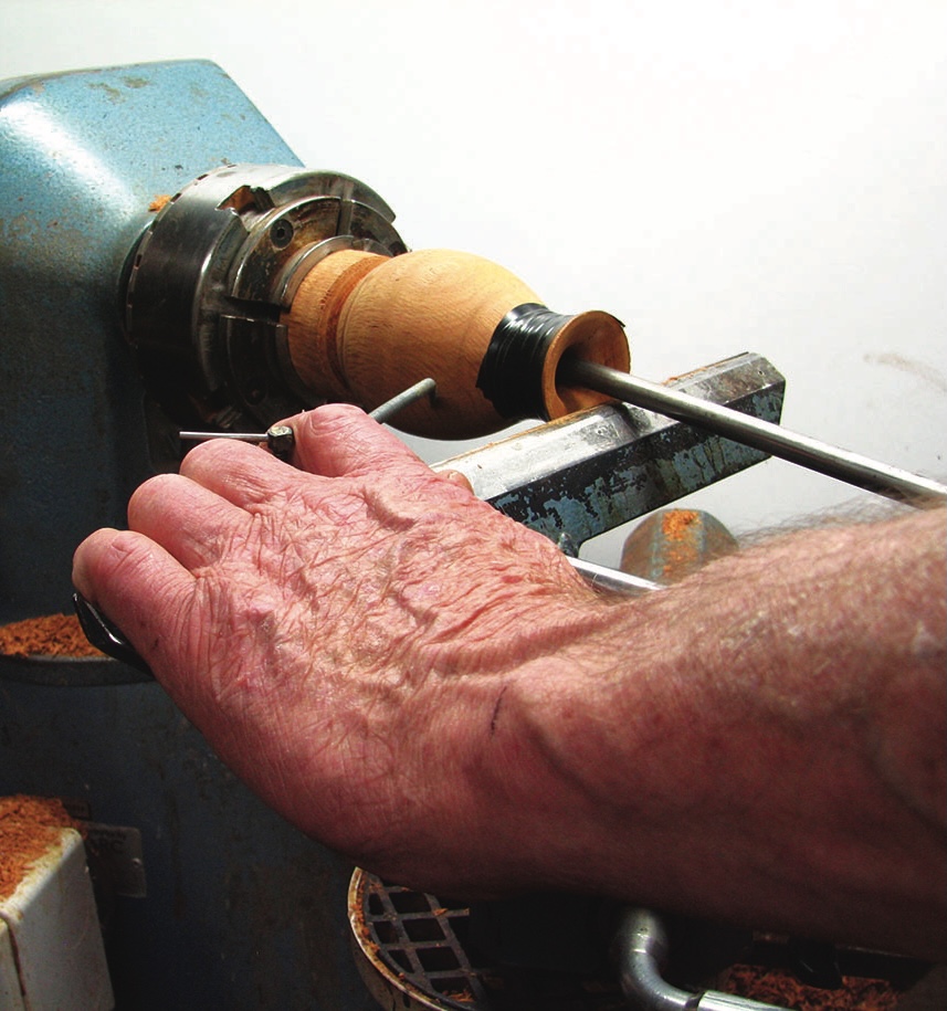

5. Here is the homemade hollowing tool shown more clearly. The tool is made out of bright steel rod, which is generally used for shafts – it is a higher tensile than the black steel. The outrigger is not welded, but a bigger diameter section is drilled to the exact same diameter as the shaft steel and pinned and clinched together. The adjustable spring can be set to the required thickness, with the spring trailing on the outside until the desired thickness is attained, when it will just run clear of the piece (see previous step). The cutter is made out of HSS using the drill press and the grinding wheel
Woodturning with lathe and pencil marking wood

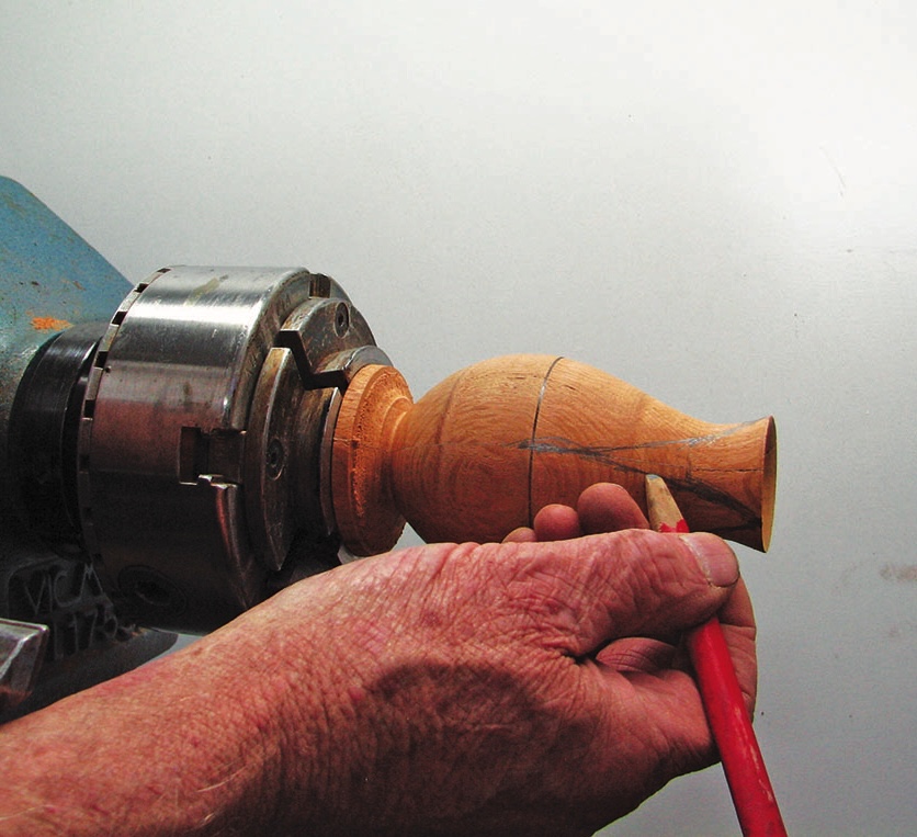

6. Having satisfactorily hollowed the piece you are now ready to mark out the bits, which need to be cut away to create the points. You can mark this out later if you wish, but I find now is the more convenient time. A line on the piece while the lathe is spinning gives you the depth of your incision. The point is exactly halfway between the glue joints – all you need is a pencil

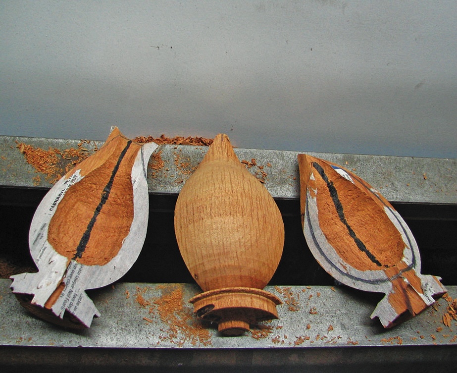

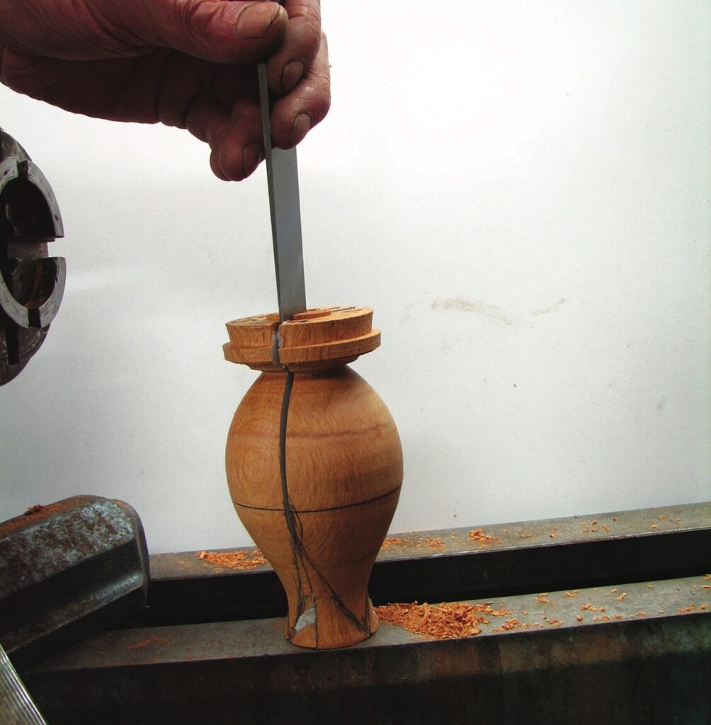

7. Take a wood chisel and place exactly on the paper joint. A few gentle taps with a mallet and you will be relieved to find you have your three equal sections
Carved wooden finials with paper templates.

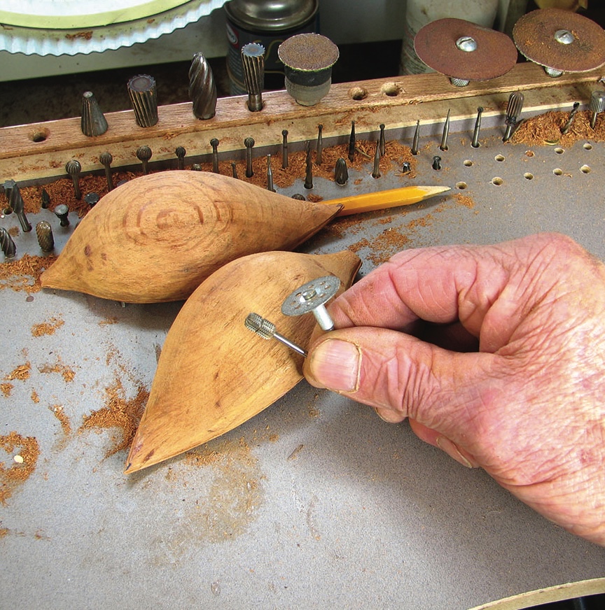

8. Here are three pieces at various stages. Using a coarse sanding disc is an easy, controlled way to do your rough shaping
Hands carving wood with rotary tool

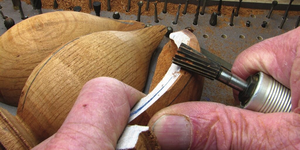

9. To further refine the outside shape you now need to focus on rounding the corners. First, mark out how far the rounding is to go, then proceed with whatever tool you have best-suited to the task

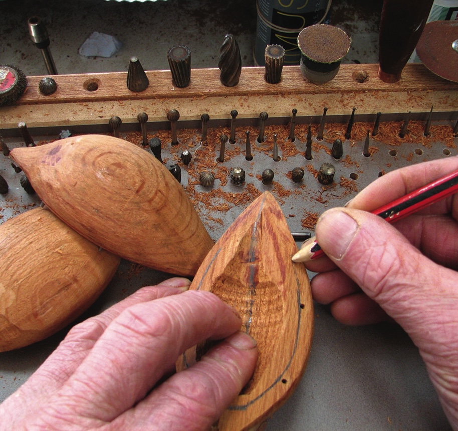

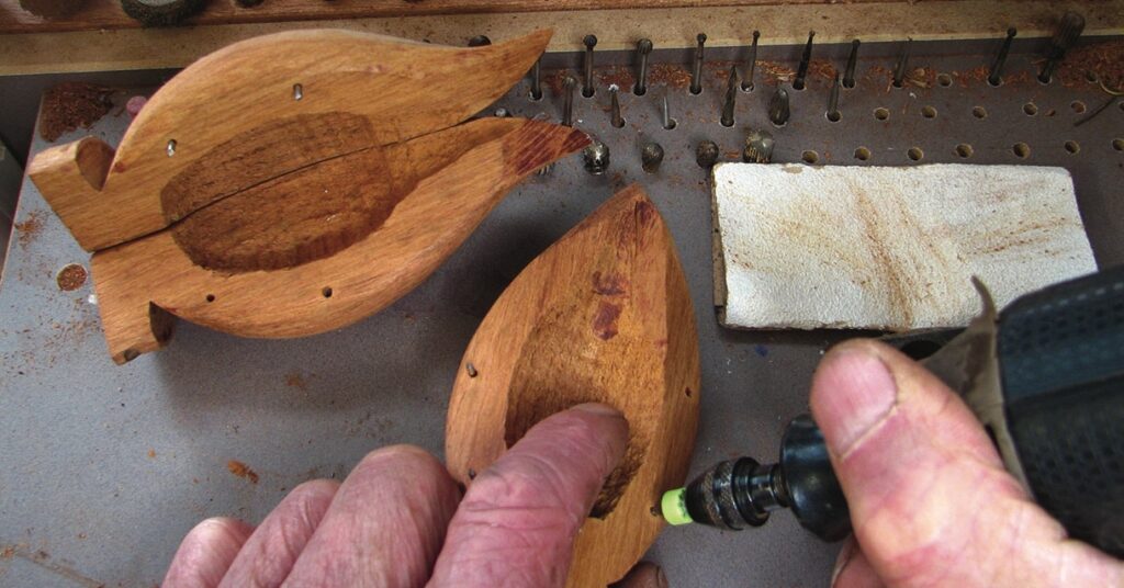

11. The next step is to mark and carve out the interior, leaving a central ridge to attach the pearls to
Woodcarving with rotary tool in workshop.

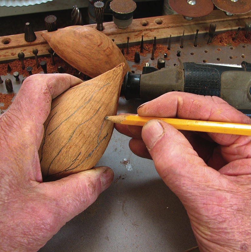

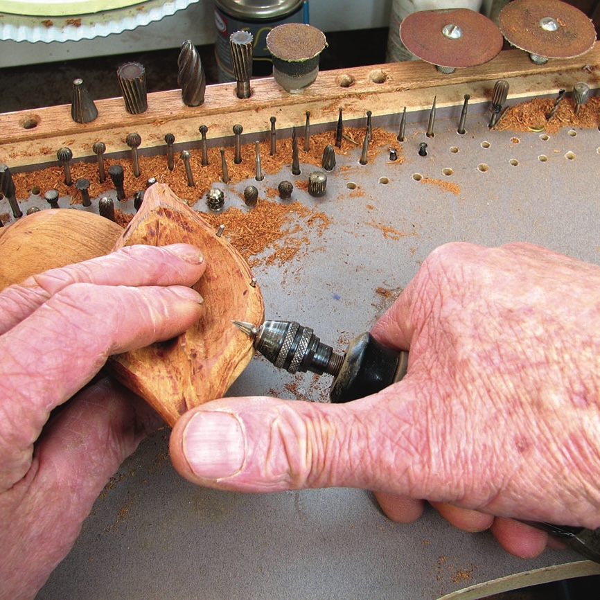

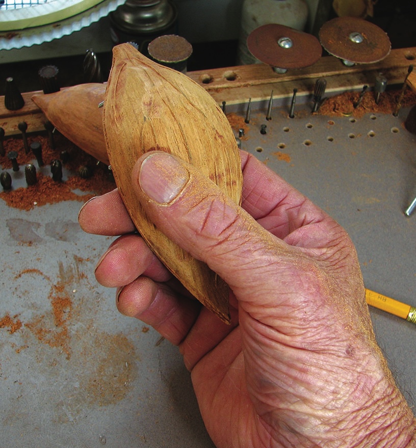

14. Now, mark the veins on the outside of your pod. These veins are relief carved so they protrude about 1mm
Carving wood with rotary tool bits on table.

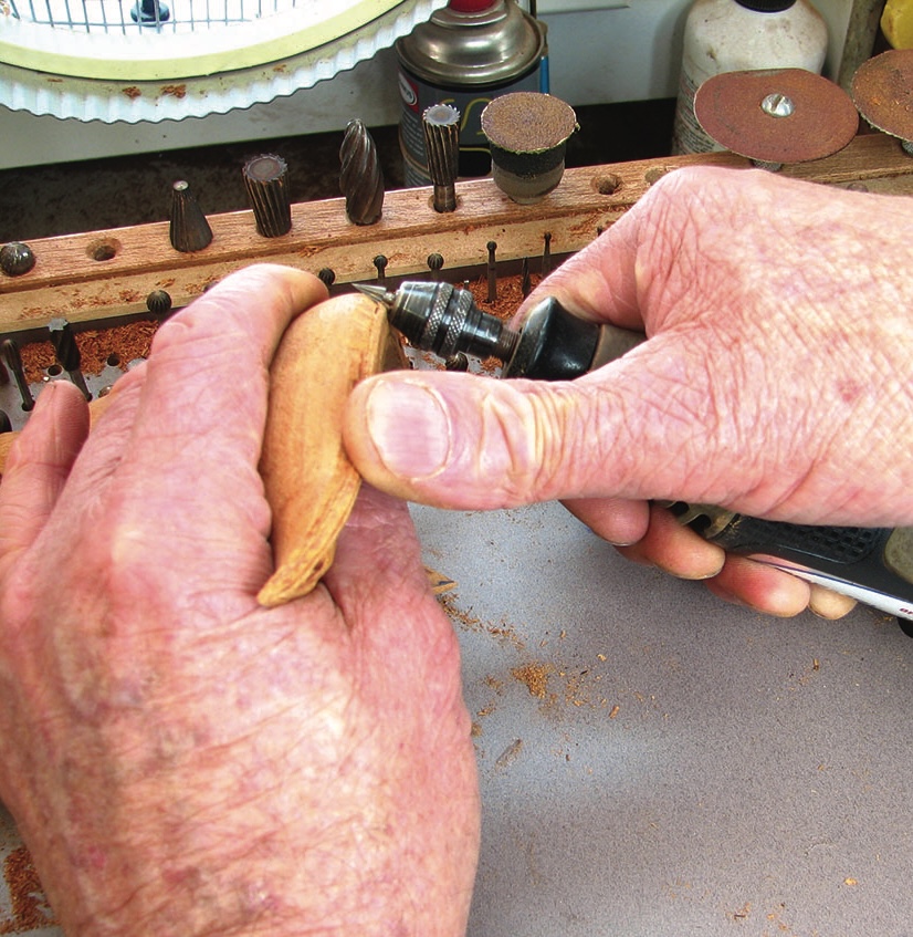

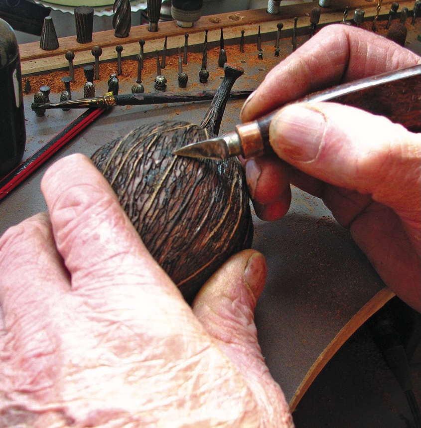

15. The relief carving is made easier by doctoring a cylinder type burr. With a diamond disc cut a 1 x 1mm groove in the cutter. This cutter now leaves a nice, neat vein – of course the neatness depends on how controlled the cut is
Hand holding carved wooden piece.
16. Here you can see the result of using the cutter. Ensure you are as controlled as possible when using this to create a neat vein

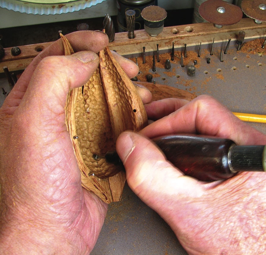

17. It is now time to dimple the interior of the pod. Care must be taken so you do not damage the fine rim, but do dimple right up to it. You will notice here that I am holding two sections together while dimpling randomly over the joint – this will help to disguise it

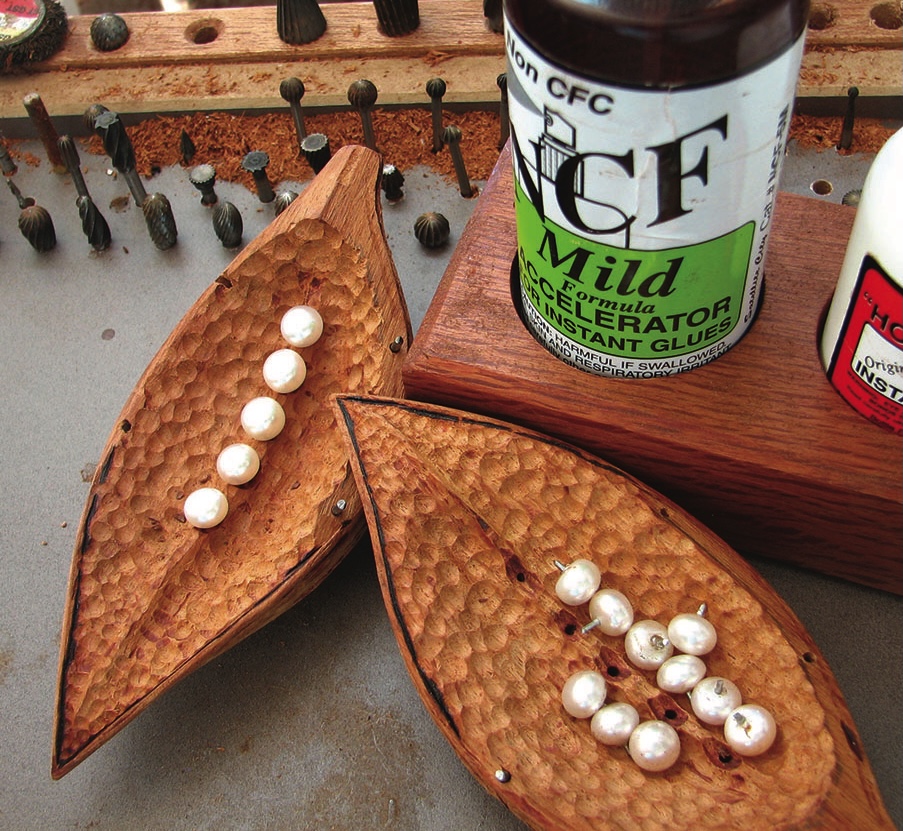

18. Half-drilled sweet water cultured pearls can be purchased from a jewellery supply shop. I suggest you do a web search and compare prices as they vary greatly. You need short pieces of thin wire or small nails that match the diameter of the drilled hole. These are then positioned in place with cyanoacrylate glue. Prepare the position of each pearl by grinding a small dish for them to sit in, and in the centre of that drill a hole for each pin

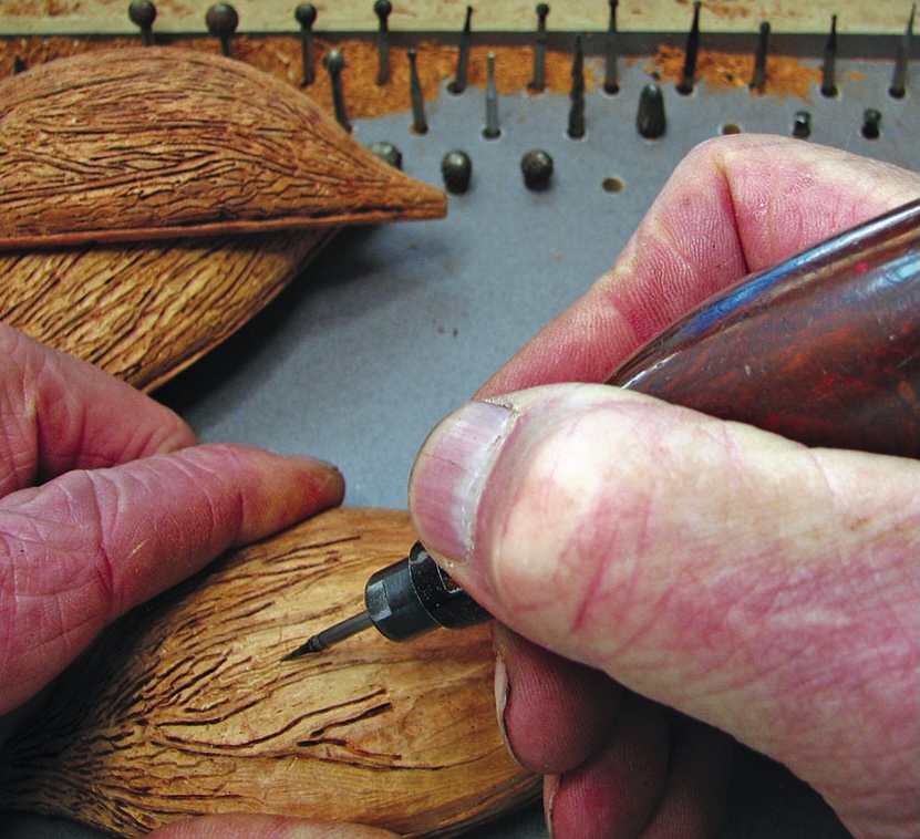

19. There is still some work to be done on the outside, and that is the texturing. Use the smallest possible burr to texture between the veins. Practise on a piece of scrap until you have a pattern you are happy with

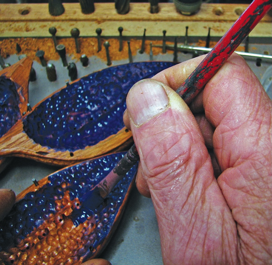

20. Now, apply several coats of your chosen colour for the inside of your pod – I generally use acrylic. When dry, the pearls can be attached; a drop of cyanoacrylate glue works very well to hold them in place

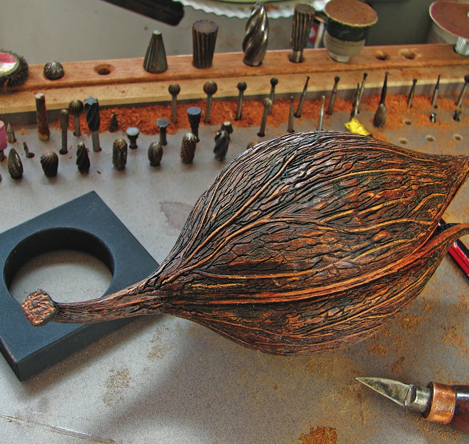

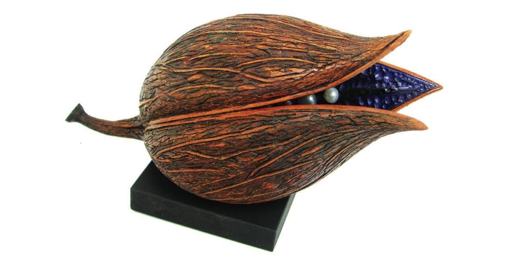

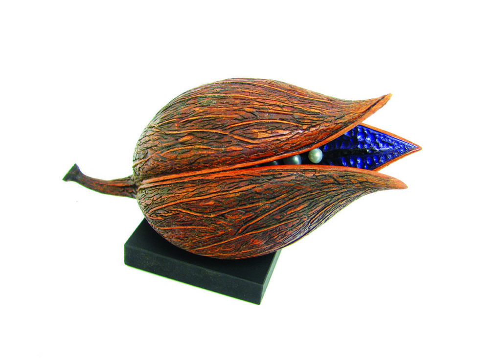

23. You are now almost finished. I generally use a thin coat of spray-on furniture lacquer for the finish coat as a wipe-on finish tends to fill up the texture crevasses. You will notice that if adequate care is taken, the stalk’s joint is barely noticeable. A very simple base is easy to make, this one is made of 10mm MDF and was sprayed a matt black
Wooden seed pod sculpture with blue interior
24. Well, there we have it. Most of us will know that it’s possible to handle any seemingly ‘impossible’ and daunting task, providing it is broken up into manageable, digestible bites. I hope this stimulates you to create bigger and better things
